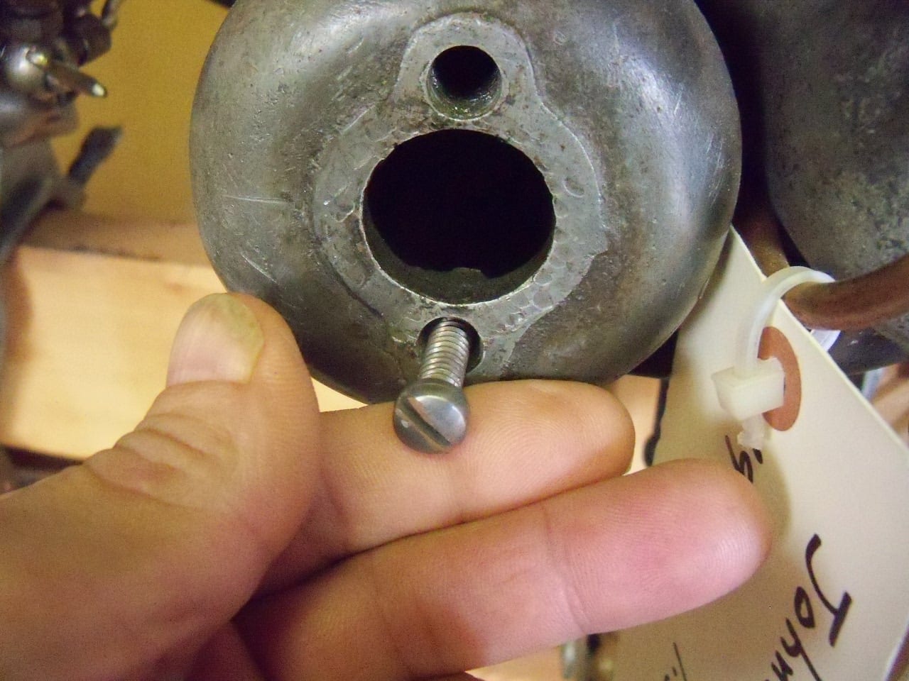

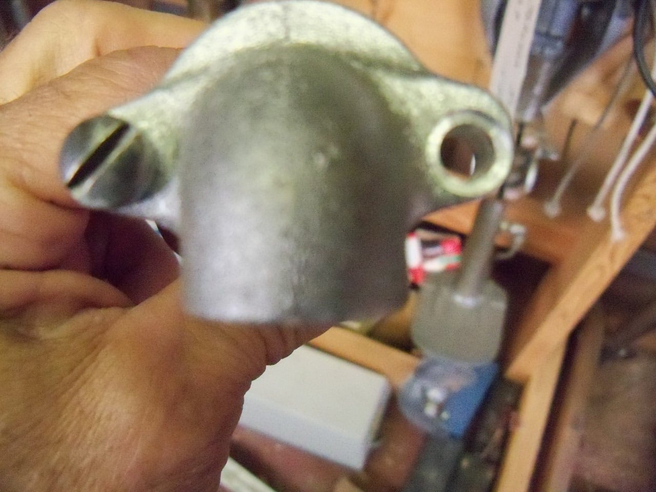

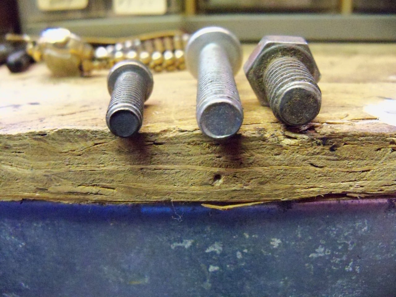

          Here are some pictures of the screws and muffler. The 1st picture is the tube that goes into the muffler showing how much room is left if I drill it out for larger screws. The second shows how much bigger the hole in the muffler is compared to the screw and the 3rd picture shows the screw on the left that came with the tube, middle to small also (showed for comparison) and the one on the right will screw in 1/2 turn. Probably wrong thread pattern on that one.

                muddog2
                  Took it out and it is too small.
                  I have a box of 50’s 60’s sea horse screws and none of them fit.
                  #226726
                  muddog2
                    Screw holes don’t seemed to be striped and they are at least 3/8″ holes. It is a1929 model J-25. I took the bolt out from under the engine and it was too small also. I have the plate that goes over the hole in the muffler but I think that is for the earlier models. It also comes with the 1//20 screws.
                    #226731
                    JOSEPH BRINCAT
                      One can never know for sure what some prior owner had done to “fix” a problem. It’s looking like the original screw holes , perhaps 1/4 – 20 were stripped and someone drilled and re-tapped to a larger size .. 3/8 maybe ???
                      Joe B
                      #226774
                      stanley
                        I have no experience doing this,but I would call my expert welding buddy and ask,”Is it possible to ream the holes enough to get them clean and then fill with weld?”You could then redrill and tap.
