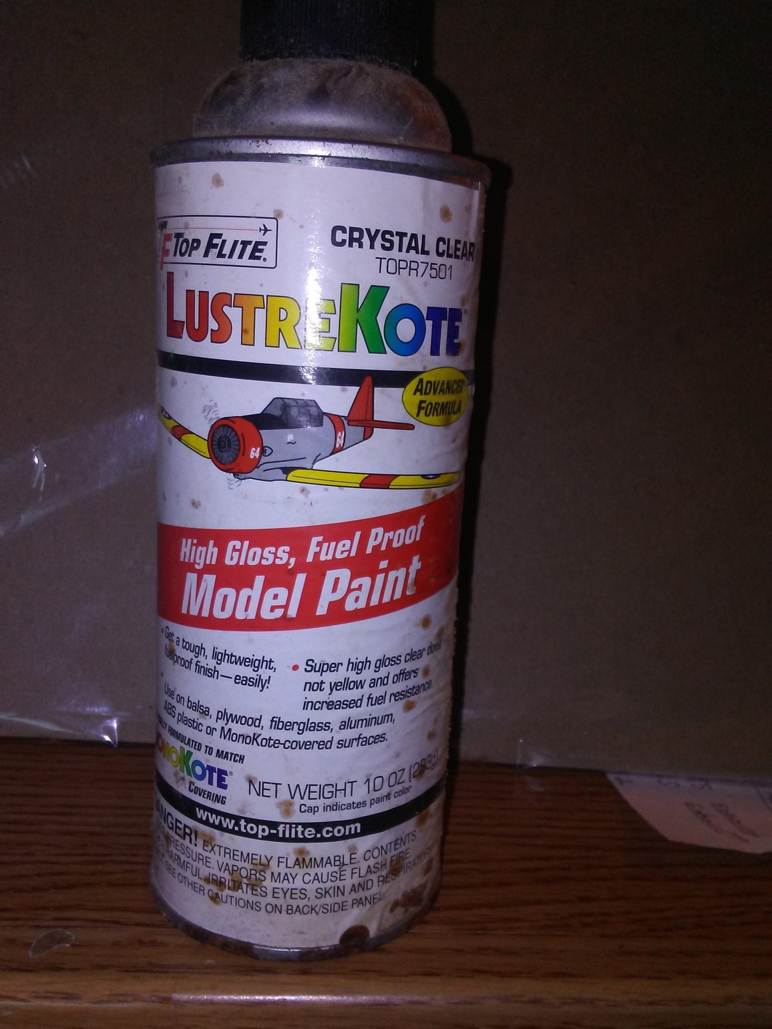

          Ralph Simmons
            i have sealed corks using this in the past
            LUSTREKOTE CRYSTAL CLEAR 3 TOPR 7501
            it is used in model plane hobby
            to seal the paint , spray 3 coats to cork
            can be gotten at hobby shops,hobby lobby
