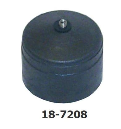

May 7, 2020 at 9:13 am #202335todd, how much $ did you spend on all those potions? For about $6 you could have bought a Sierra 18-7208 (for Mercury) Nitrophyl float. You can cut, sand, drill, modify it as necessary, no sealing needed.

May 7, 2020 at 4:13 pm #202403Wow thanks for all the replies . Tubs your experiment speaks for itself, It makes me wonder why, if the cork did not need the coating ,why the OME ones had a coating [and replacements still do] I cant believe they would do that for no reason ,, hmmmm. Frank thanks for the part # I searched and searched but could not come up with one that I thought would work.You are a wealth of knowledge. I will check it out and most likely get one of the mercury floats. I have a few $s invested some of those chemicals some were left overs from other projects. Almost all of the research I have done so far has come up with some replies that are positive and some negative I hate to do anything twice so I was hoping for a hands down ,” use this stuff ” or a ID on what is on the replacement cork floats of today.
