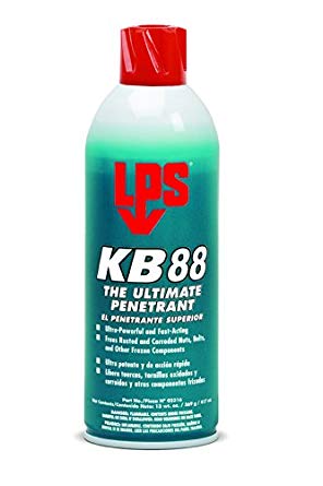

      #83884
        Havent used it on a motor but we use it on rail car parts and it works wonders. KB88
