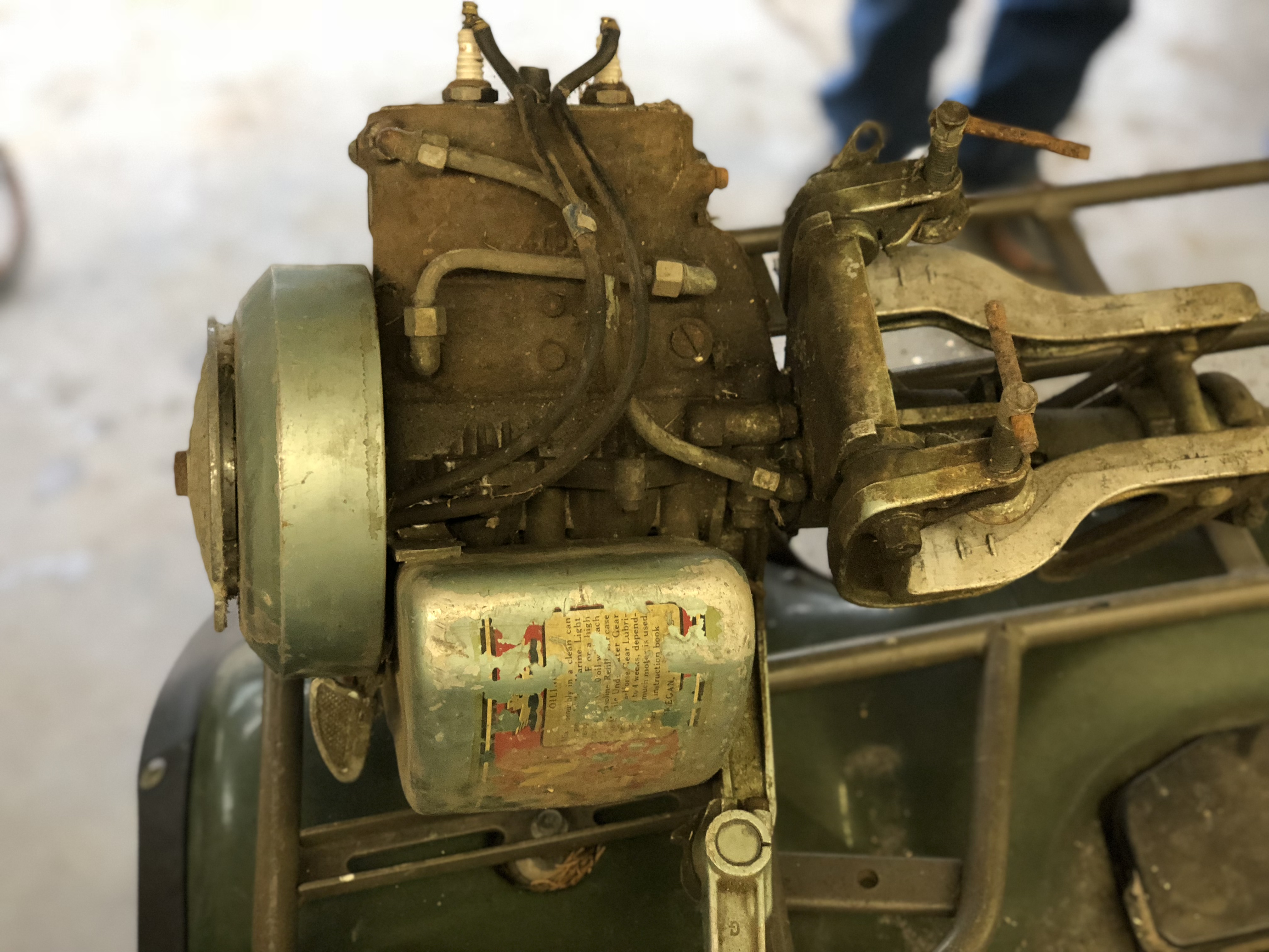

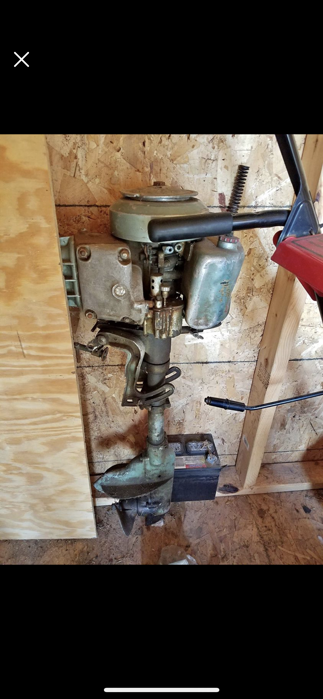

      So, today I went out and picked up this Johnson. Only paid 35 bucks for it. But she’s locked up tight. Pulled the plugs, they look fine. Cylinders just look dry, not to rusty. So I guess what’s the magic sauce to get the pistons moving again? Thinking of making up some half ATF and half acetone. Hear that works wonders.

            Is that an LT-10? Good luck.

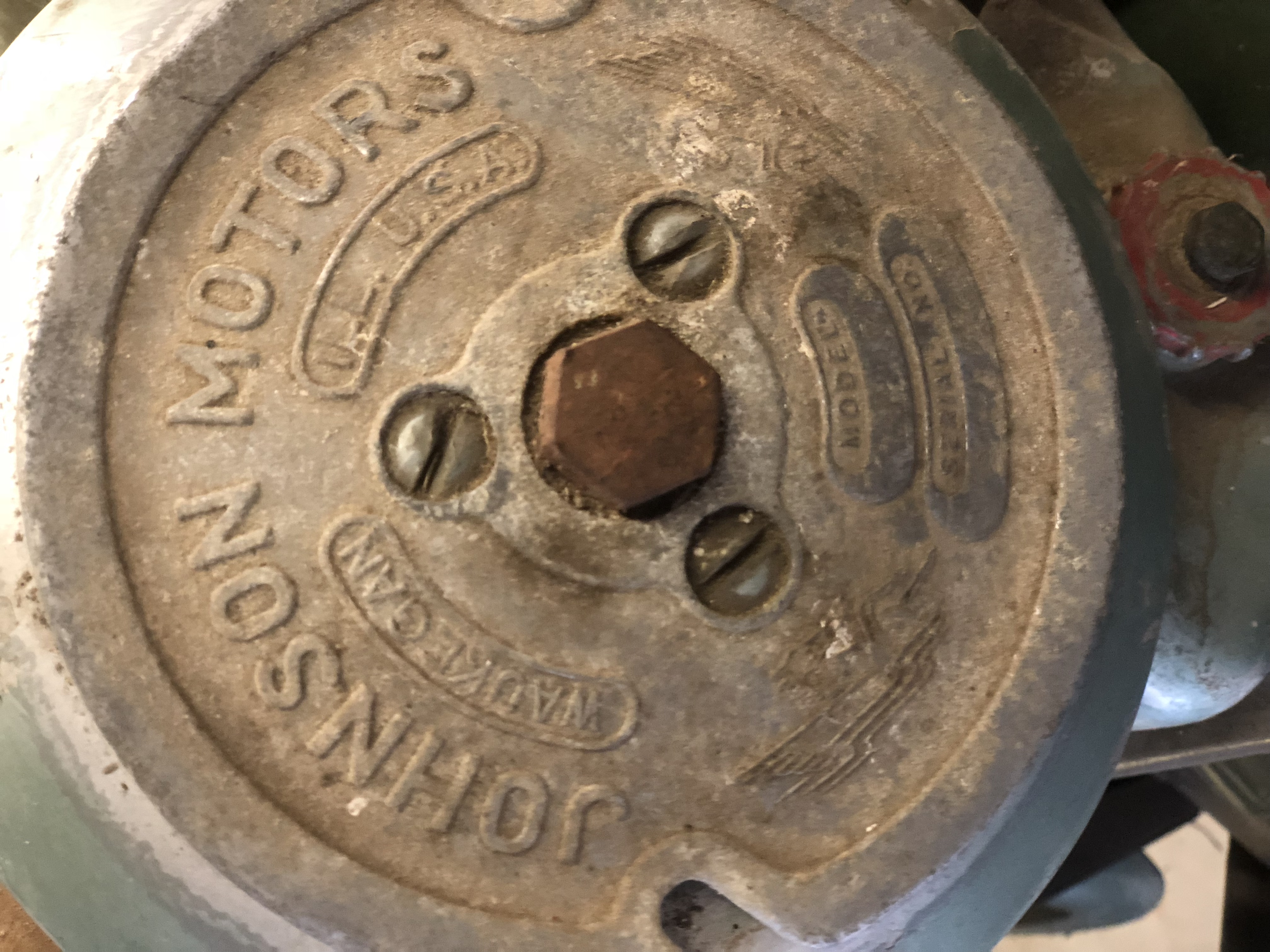

                    I like PB Blaster, too. Be sure to strap-wrench the flywheel. Don’t just try to turn the flywheel nut. It will just over tighten and possibly break the flywheel. However, be advised that, in my experience, about 99 times out of 100, if you are able to break it free and it starts turning over, the piston rings will still be stuck in their grooves.
