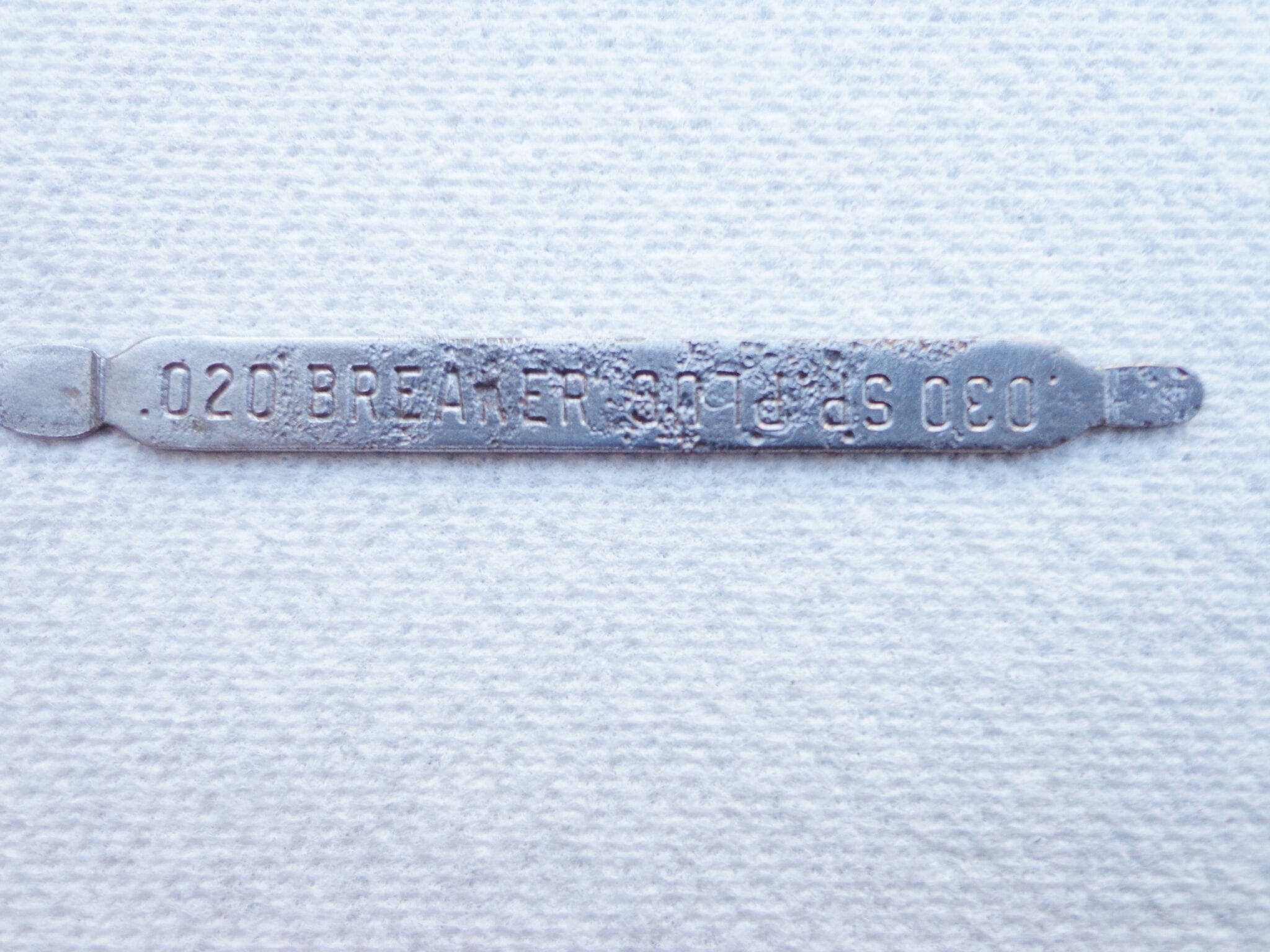

        One of these old school feeler gauges can come in handy for setting points thru a flywheels inspection hole.
        DSC00138
