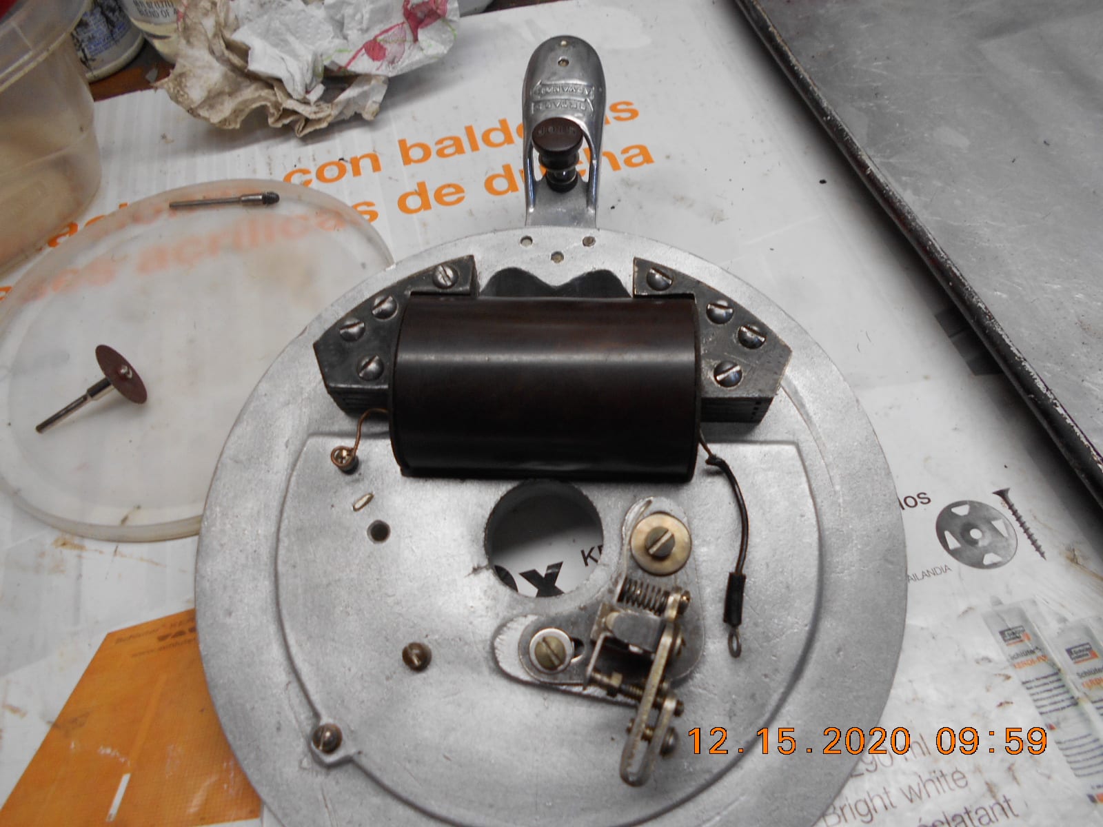

      Need a little help on how to set the points on a Johnson A45.
      Thanks in advance, Steve

        This is the magneto on my 1929 A-45.
        I can’t remember if I had any problems, but it appears that
        you loosen the binding screw on the “U” shape portion,
        then use a little wrench to turn the movable half of the point
        set. Presume it’s .020 gap on the points, and don’t forget
        to snug that binding screw back up…… at least that’s what
        it looks like. Is the cam for the points on the crankshaft or
        the flywheel hub? If on the flywheel hub, I presume there’s
        a hole in the top of the flywheel to set the points through.

          Steve Petschel
            Thanks TBH. I never would have found those marks without you help. Buccaneer, The point assembly attached is to the mag plate by 2 screws, but the holes in the point assembly are oblong allowing the point assembly to be adjusted in it’s position on the mag plate . Is that for rough positioning and the adjustable point half for fine tuning the points?

              Buc, the point cam is on the flywheel hub.

                Yes,you may have to change the points location on the plate in order to time their opening.When the points open is more important than the exact amount that they open.
                  Steve, “rough setting” or best geometry between the points arm and flywheel
                  cam perhaps. I think Tubs mentioned the timing marks on the flywheel
                  and plate to me, but I can’t remember if I found them on mine.

                      Thanks to you guys, the motor is now alive! Would any of you know the initial carb setting and proper starting procedure?
