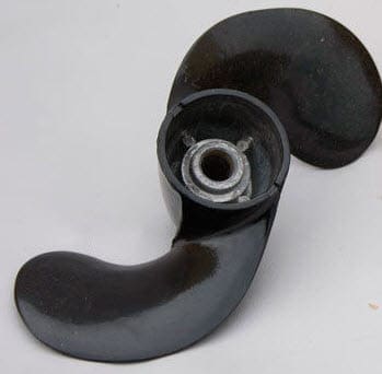

      OK, so is the prop just spinning on the brass hub? Kind of hard to imagine how this could happen, maybe the prop was not machined/assembled properly…Or, perhaps the aluminum is cracked allow it to pull away from the brass hub…
      OK, I’m confused….You have one prop labeled as the bad prop, but it looks like a good prop….The other prop is labeled good, and it looks like the one where the brass hub has separated from the aluminum propeller casting…
      Does the engine vibrate using either of these propellers?
      Strange how the props look the same on the shear pin end even though the brass hub appears to have moved out of the gearcase side. Perhaps these are two different vintages of props….
      In any event, if you can turn the brass hub inside the aluminum casting, the prop is NG…

        I got a spare parts motor and put in a new lower unit. Problem solved.Running great now. Just waiting on getting the engine tuned in.The white prop came from NOS , still have the box. the silver one came with the motor. I replaced it after the log strike because i was having acceleration problems.

          “Perhaps these are two different vintages of props….”
          I checked two 7.5 Fleetwin props that I have on hand. The 1954 and 1955 props match the dull aluminum one shown in this thread. The 1956 prop matches the white prop shown in this thread with the bronze hub showing reveal on the inside. Looks like a slight design change was made for 1956 and later.

            Could be. It says its the same part number 277276, If that’s the case..2 different props for the same motor? Produced under the same part number. One for 54-55 and one for 56 and later.
            #184333
            aquasonic
              PN 277276 prop was used on the 1954 and 1955 Fleetwins. PN 277650 prop was the upgrade used on 1956-1958 Fleetwins and AD models. It is a direct replacement for the earlier model.

                I received a “gotcha” when I built up a 5.5 / 7.5 lower unit from parts salvaged from various motors. Everything went fine till I tried to put the prop on. It wouldn’t slide all the way on without banging up against an obstruction. Seems like the webbing inside the prop was the interference, but sorry I just don’t remember all the details.
