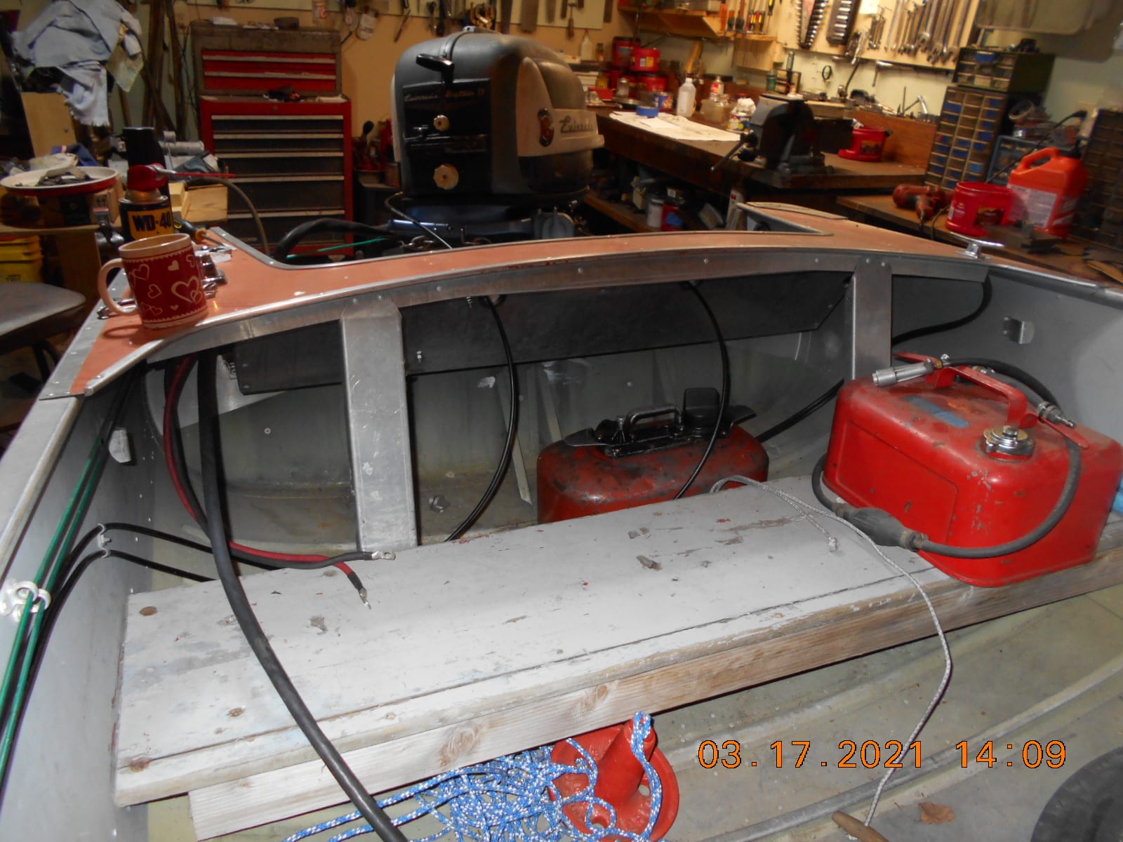

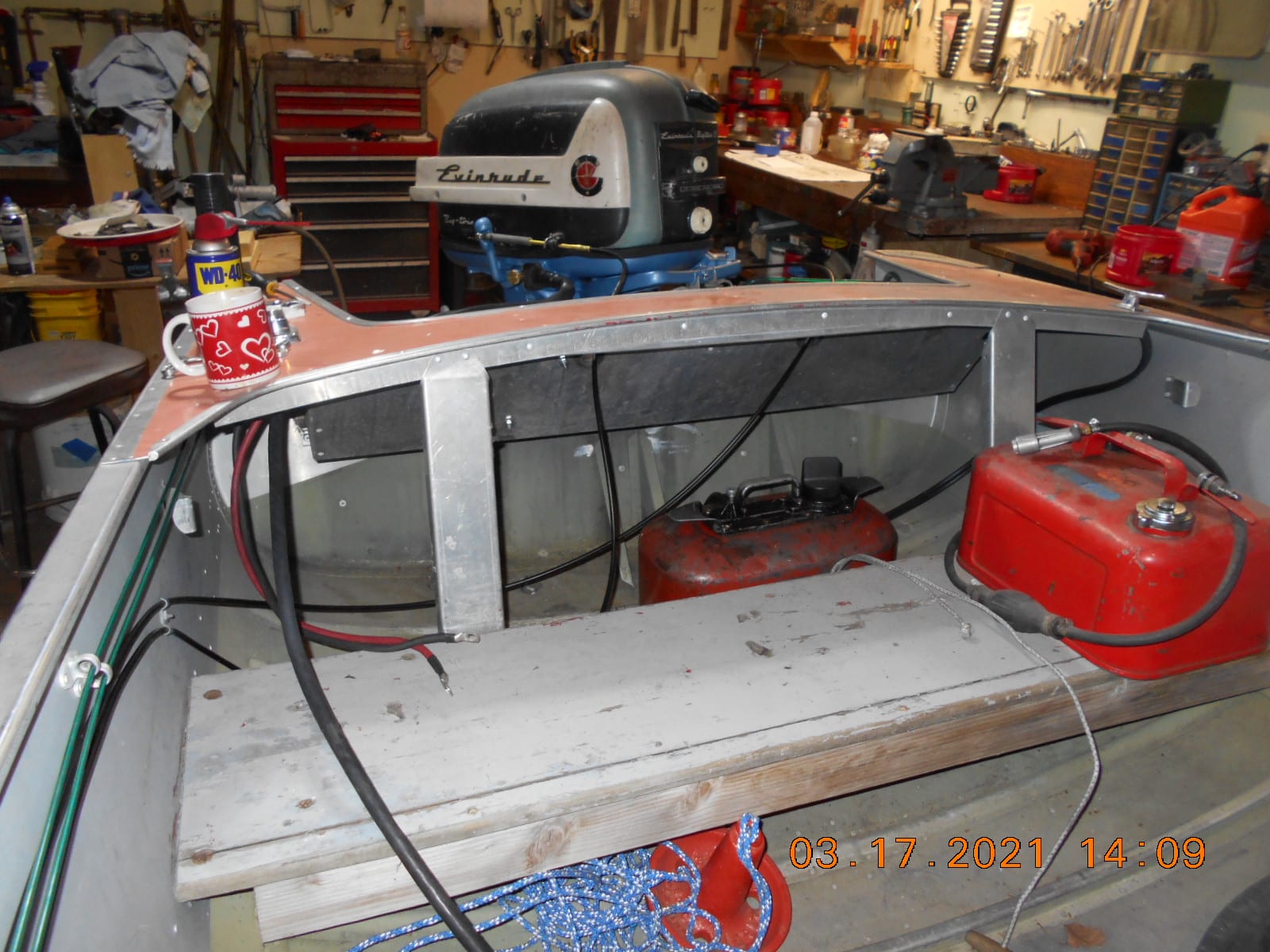

            I’m happy to say I installed my new control cables today.
            The 11′ and 12′ cables seem just right to go behind the
            seat back and still have slack enough to turn the motor to
            both extremes. The new cables are a lot more limber than
            the old ones.
            Thanks for all the help figuring this out!
            DSCN0528
            DSCN0531
            DSCN0532
            DSCN0533
            #234106
            DAN UMBARGER
              Very nice…clean installation. Should notice MUCH smoother movement. Did you go with regular cables or Extreme cables?
              #234107
                Looks just right!!
                #234115
                  Beats me, these are the ones I got. Seems like very nice quality.
                  TEL CC17011 Teleflex 400 Control Cable 11′
                  TEL CC17012 Teleflex 400 Control Cable 12′
                  #234136
                  DAN UMBARGER
                    Those are the standard cables…which has been the industry standard for years and they work great. I forgot they don’t make the extreme cables for the 400 style cable. The extreme cables have a different core system which makes for a much smoother operation. When I have a choice I always go with the extreme cable….here you don’t have the choice. You should still have noticed a huge difference in smoothness.
                    #234142
                    outbdnut2
                      Looks great! You will find that with a lot of use, the rubber grommets on the holes in the splashwell will wear from the cables rubbing on them. When you see them wearing, either replace them before the cables rub through the rubber to the aluminum edge, or turn the grommet 180 degrees to put a new surface on the cables’ max wear point.
                      You can fit the battery box between the cables and the seat – pushing the cables rearward some like in my photo but they will still work fine.
                      • This reply was modified 4 years, 12 months ago by outbdnut2.
                      #234231
                        Dan, yes the new cables made a huge difference in flexibility and smoothness
                        of operation.
                        Dave, I “think” my grommets are okay, but now you got me wondering. Thanks!
                        I just got a new battery box. Tomorrow I’ll figure out a place for it, and I have
                        to crawl under the bow to tie up the excess motor harness somehow…….
                        then I think it’s ready for a test run, as soon as the ice goes out, that is.
