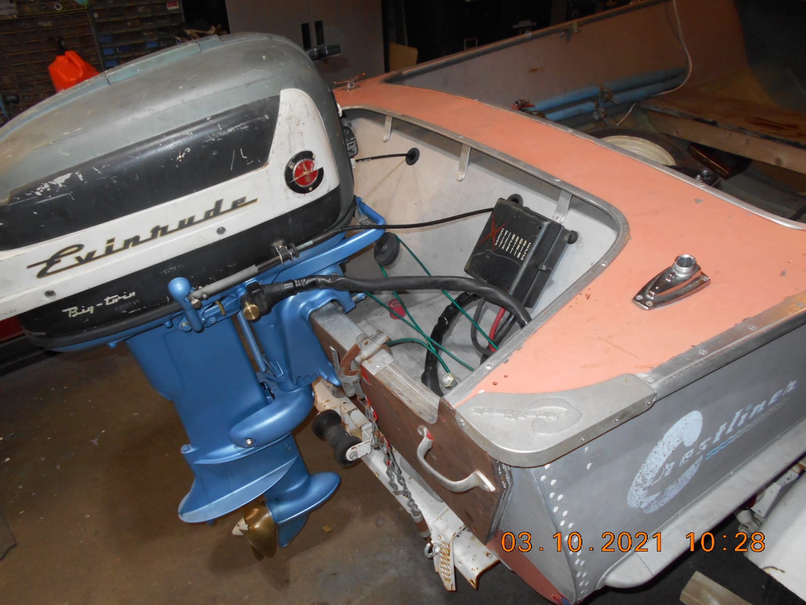

      DSCN0502
      Showing seat back, but with Mercury controls, as a 20 hp Merc was
      installed, and the 40 hp Lark laying in the bottom of the boat when
      I purchased the package.

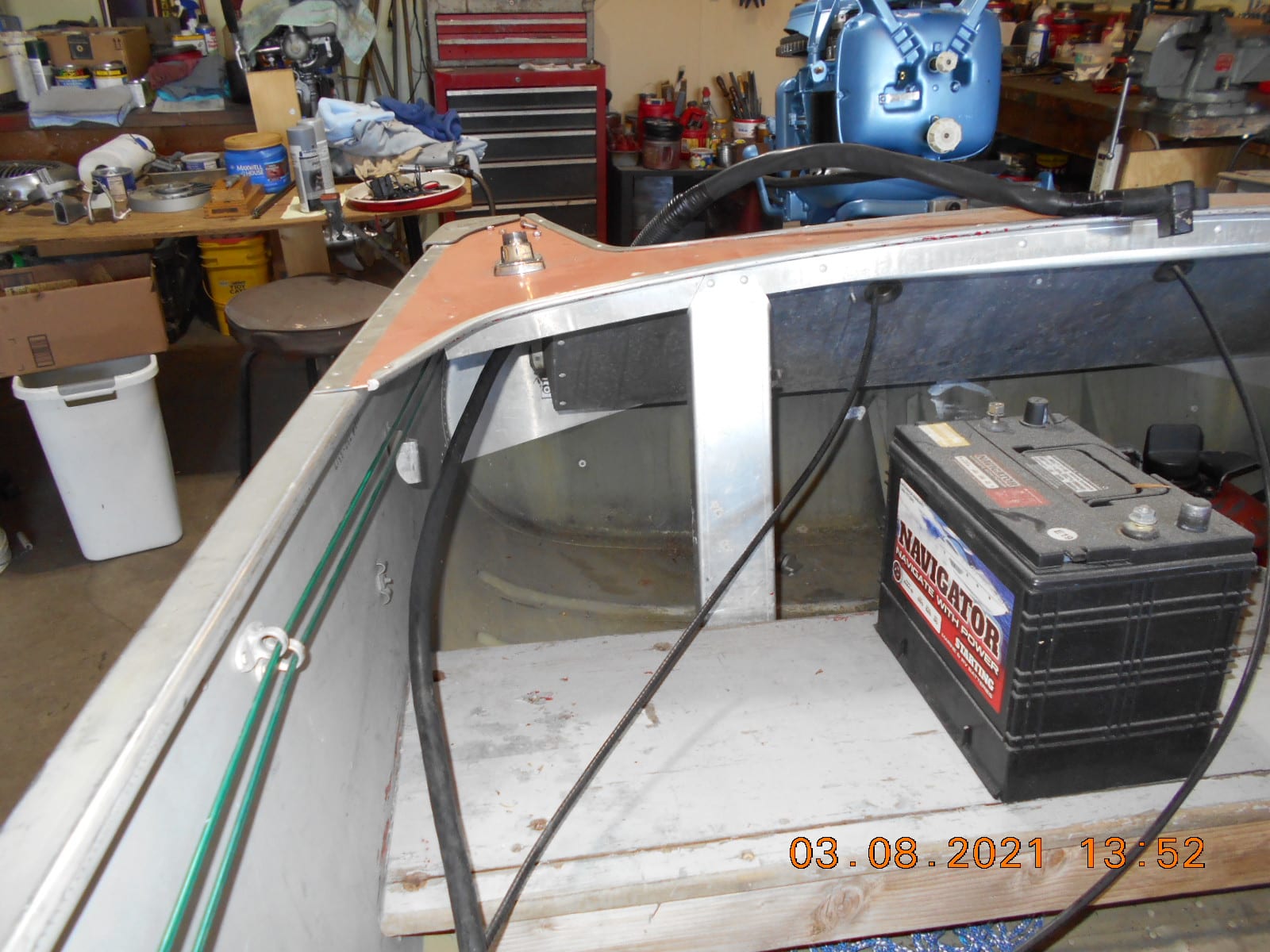

      DSCN9408
      OMC Simplex controls hooked up, note that they’re too short to
      go behind the seat back.

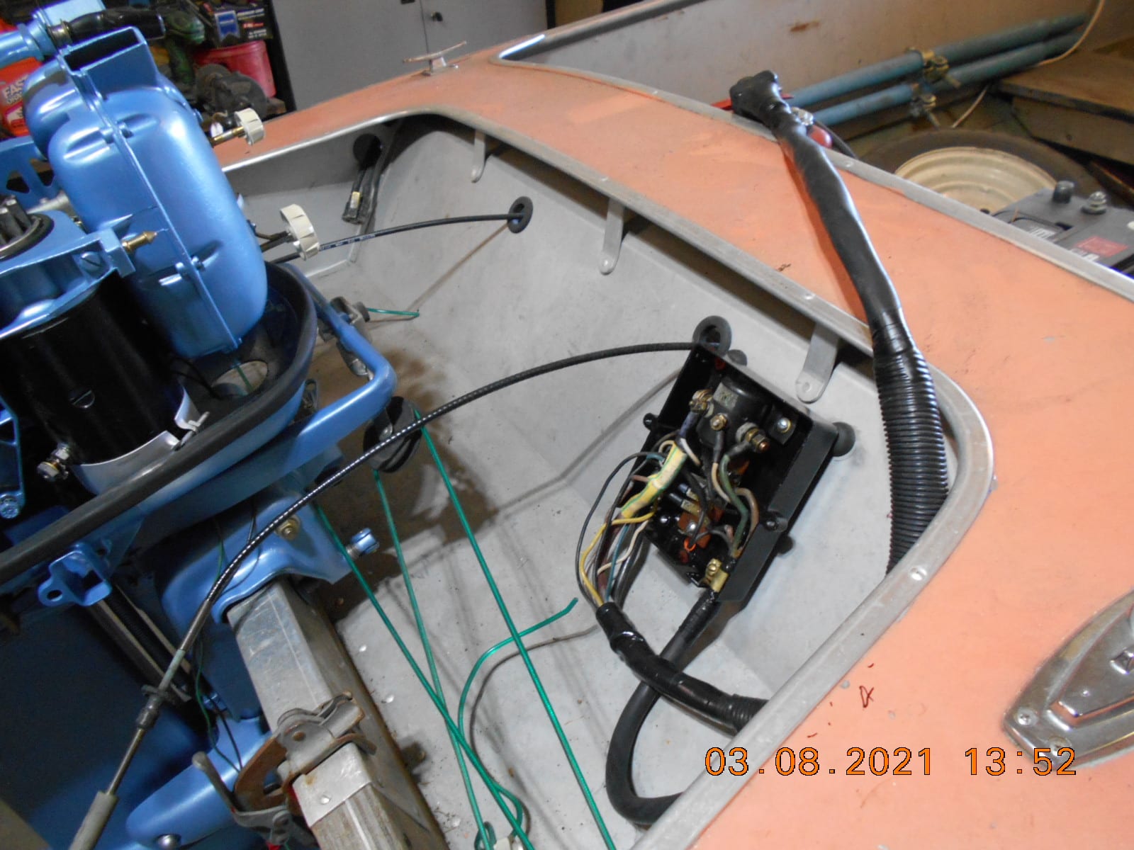

      DSCN0485
      Not sure this is the best place for the solenoid box, but
      that’s where the holes were drilled in the panel, and not
      a lot of choices either.

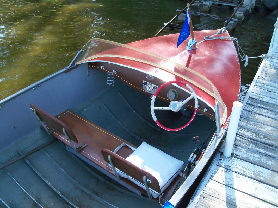

                    You have a 1957 Crestliner Viking14, model 730, but you knew that already. If you redo the rear seatback, you may want to make it be an inch or so above the aft deck like original so passengers don’t get a horizontal stripe across their back from non-anodized aluminum on the deck edge.
                    Here’s my 2nd try at posting photos of my boat like yours:

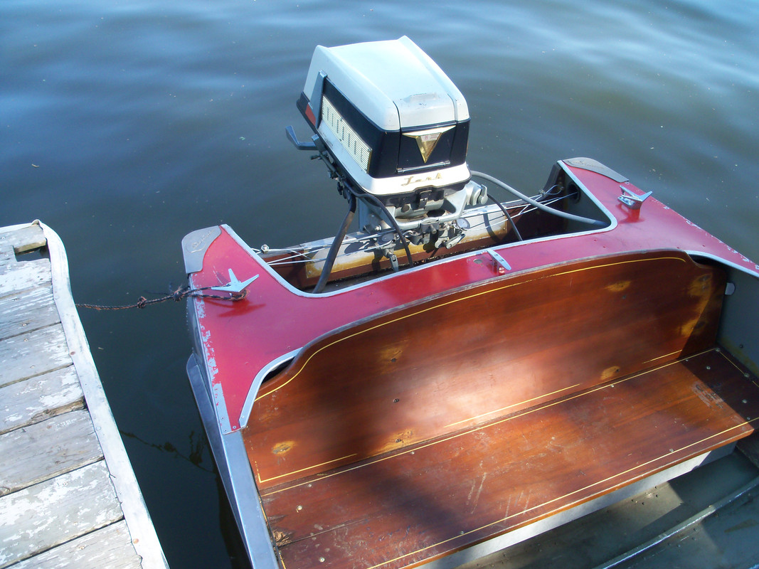

                      I can measure my cables for you, but I can’t get to the boat for another couple weeks or so when the snow is gone and I dig stuff out of the garage enough to hook the trailer to a vehicle – If I get in the boat with no vehicle hookup, it will tip backwards – I have almost no tongue-weight on the trailer. Yes the cables will snake around behind the seat – they are a very minor interference when removing the gas tank.
