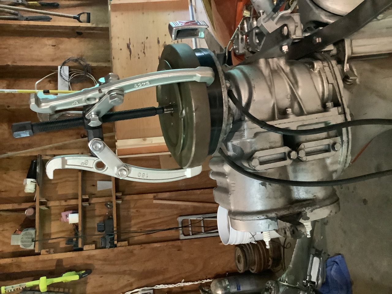

Yup it pops up
July 2, 2022 at 3:33 pm #262357
Being that is a steel
flywheel you’re probably OK but that is not the
best way. Distortion of the flywheel is Possible.
Those 3 threaded holes in the flywheel are
there for a reason.Its off now keep going on.

July 2, 2022 at 3:45 pm #262360
Sounds like a good option. Use what you got.

July 2, 2022 at 4:44 pm #262365Guess you got the flywheel off OK, but as Tubs noted, you really shouldn’t use a jaw type puller on the rim of the flywheel. Also, whenever you need to remove the flywheel, leave the flywheel nut installed loosely near the top of the crankshaft threads. That will help prevent the center bolt on the puller from mushrooming the crankshaft threads when you tighten the bolt. And if a flywheel is really stuck, leaving the nut on there loosely will help prevent the whole shebang from flying off when the flywheel finally does break loose. Good luck with getting it running again.

"Every time you remove a broken or seized bolt an angel gets his wings."July 2, 2022 at 10:30 pm #262383Well if my phone wasn’t at the bottom of lake x, I would be able to show you all a great ride after of drying her out! I returned to the scene of the crime. It fired up after a few pull’s , sputtered a wee bit then off I go! As billw suggested I ran it hard for a tank full.
so now I can look for a flywheel puller set at the yard sales.
