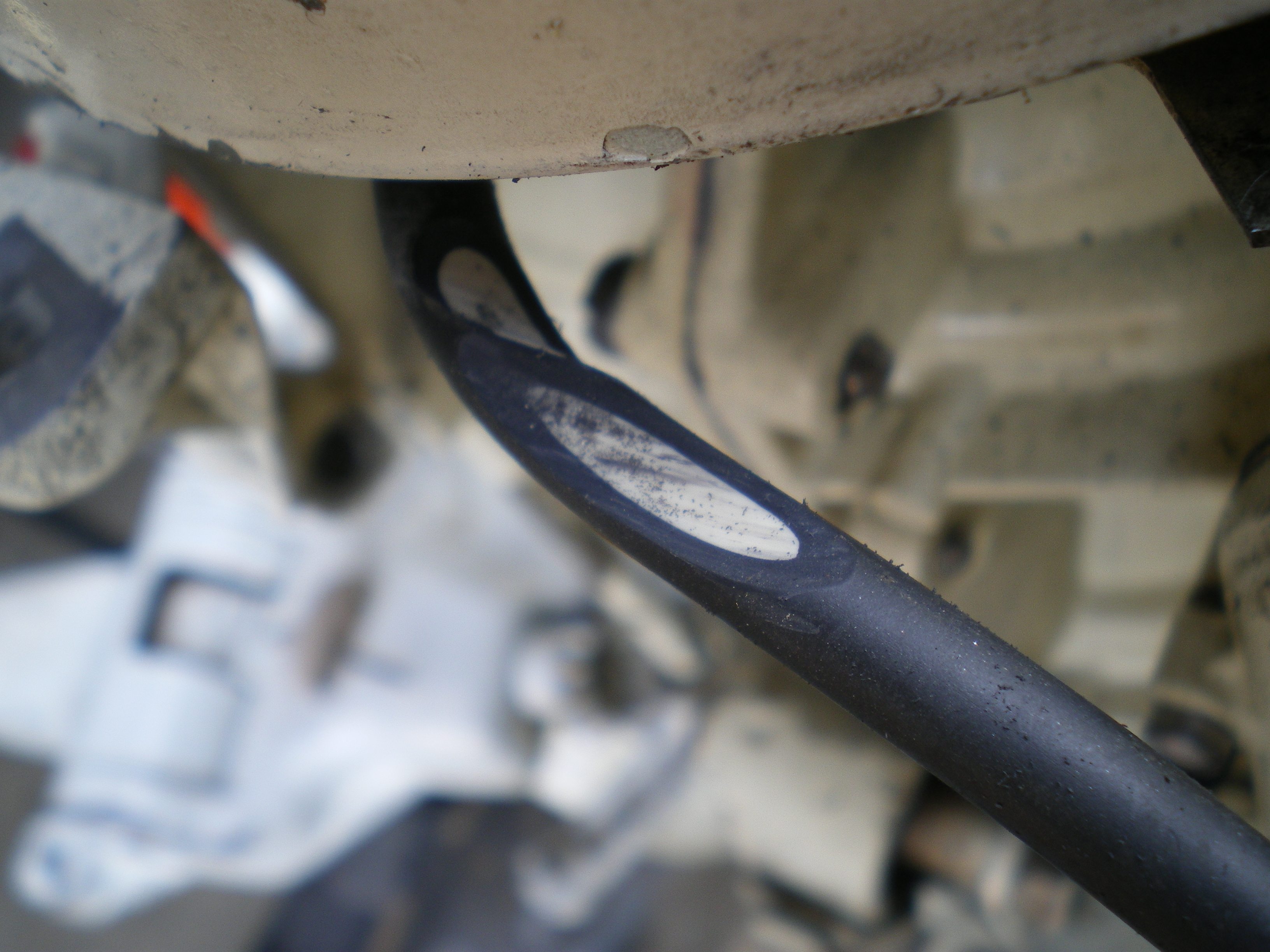

      Down through the years, I have found that if you buy cheap wire, you may get—cheap wire. Look at the construction of a piece of Belden wire. This is tough stuff. I don’t claim to know the chemical composition, but there are two layers of insulation with woven fiberglass strands between them. It Does make a difference in our stuff where the wires rub every time we move the throttle. It Does make a difference where they are smooshed by the clamps under the armature plate.

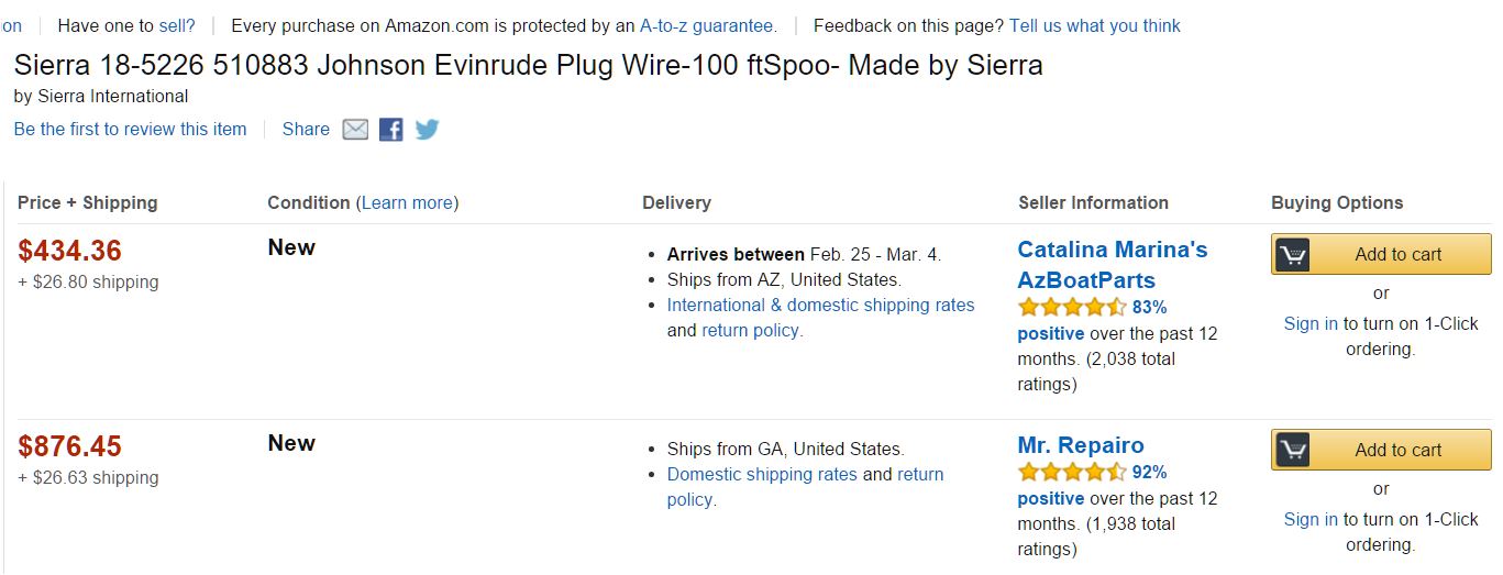

              spool Hypalon 100′ 7mm wire #18-5226
              25′ wire with 30 wire connectors (10, 10, 10), only 10 for the modern outboards, (50-60’s) and 10 and 10 of the older than that Johnson and Ev’s #18-5225
              Sierra brand, order from Napa.
              #31964
                quote Dougs Outboards:
                $434 to $876 per 100′ roll??? 😯
                http://www.amazon.com/Sierra-18-5226-Jo … B0077PPQZA
                http://www.amazon.com/gp/offer-listing/ … dition=new
