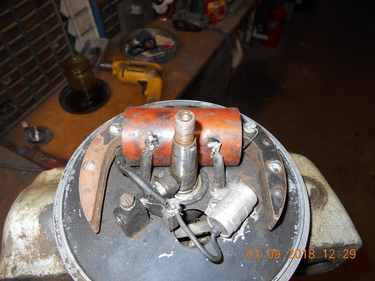

      Looking for a diagram for Evinrude 3.5hp 1943 sportwin. Most needed is the mag plate diagram showing the points, condenser, and coil wiring . Not sure how the spark plug wires connect to coil.
      Any help will be great as this is my first 2 cylinder one coil motor.

        This is a 1940 3.3 hp Sportwin…….. not sure if the 43 is the same.
        DSCN6436
        #218736
          Don’t let the one-coil scare you. They work just like any other mag, except remember that both plugs fire at the same time.
