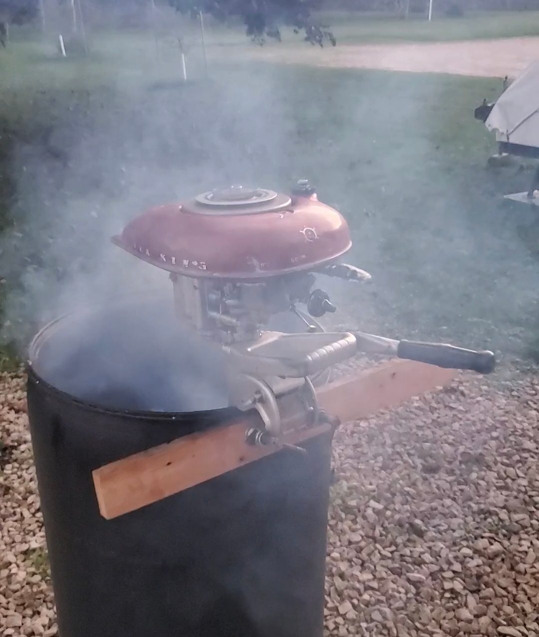

            I found a thread from Richard White 2015 that shows dual omc coils.  That looks like an option. I will need to look for the “military” option as well.
            To your question, it’s the challenge.  Doing this with my 13 year old.  Started with a random curb find of a 49 sea king that we did a minor rebuild of, and got running.

              Hey Tubs.  Measuring across plug leads I measure 6.8 k ohms but measuring either lead to ground I have no continuity at all.  Is the 6.8 significant or is the lead to ground the determining factor for a bad coil?  I don’t want to overlook something before I dive in.  Really appreciate all the help from you guys!
              JGG13
              #302838
                That is how it should be as far as checking the secondary’s. Not sure of the exact ohm reading but its not open so I suspect your coil is still good.
