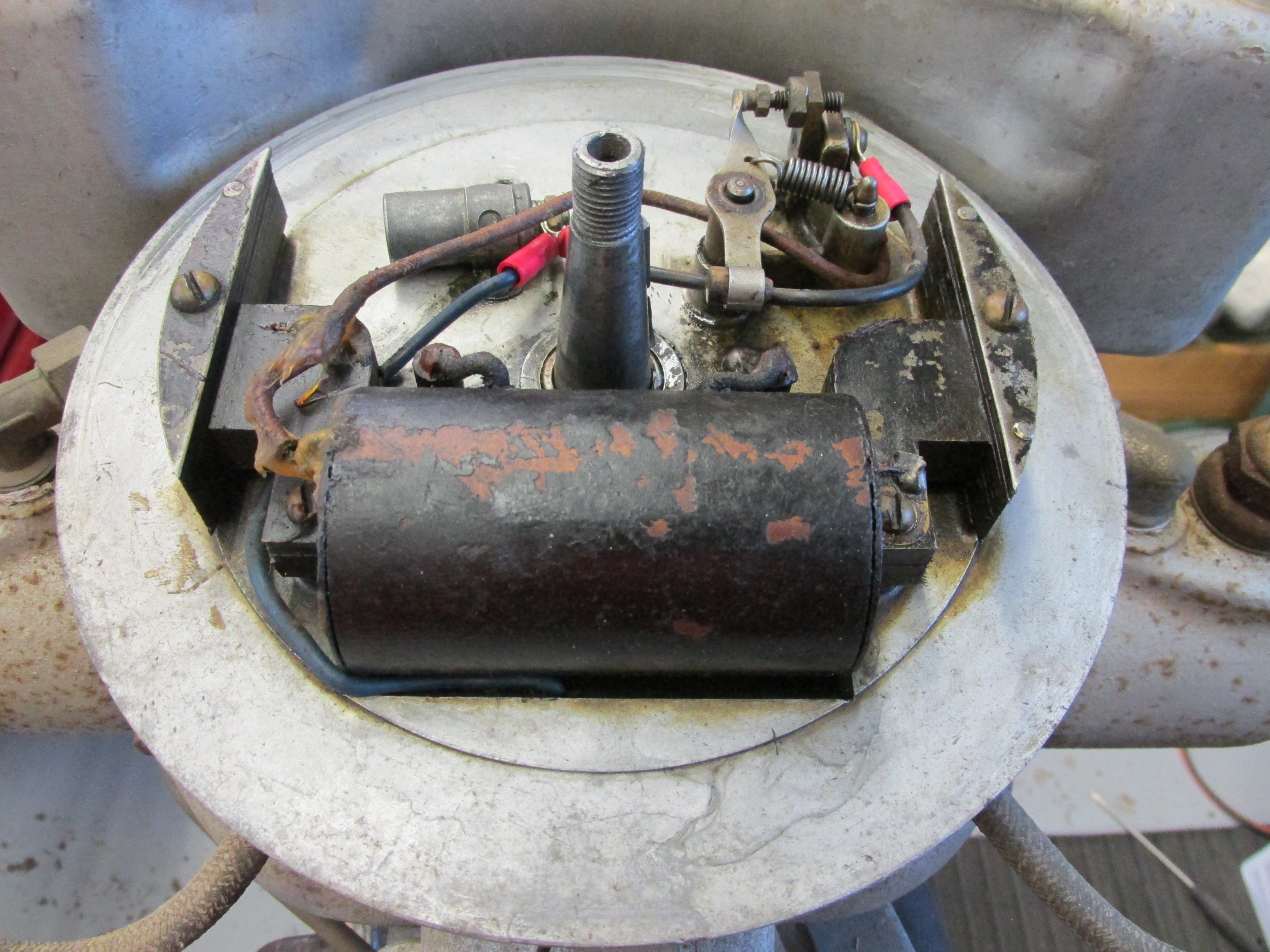

          The military coils can be adapted to almost any antique motor application but it is almost never a simple parts swap, there’s usually some rudimentary fabricating involved for almost every installation. Your easiest swap is another Evinrude coil from that year, since they used the same ignition system on many 1929 Evinrude motors. This one used on a 1929 Fleetwin might even interchange (just an example, not for sale)IMG_4186

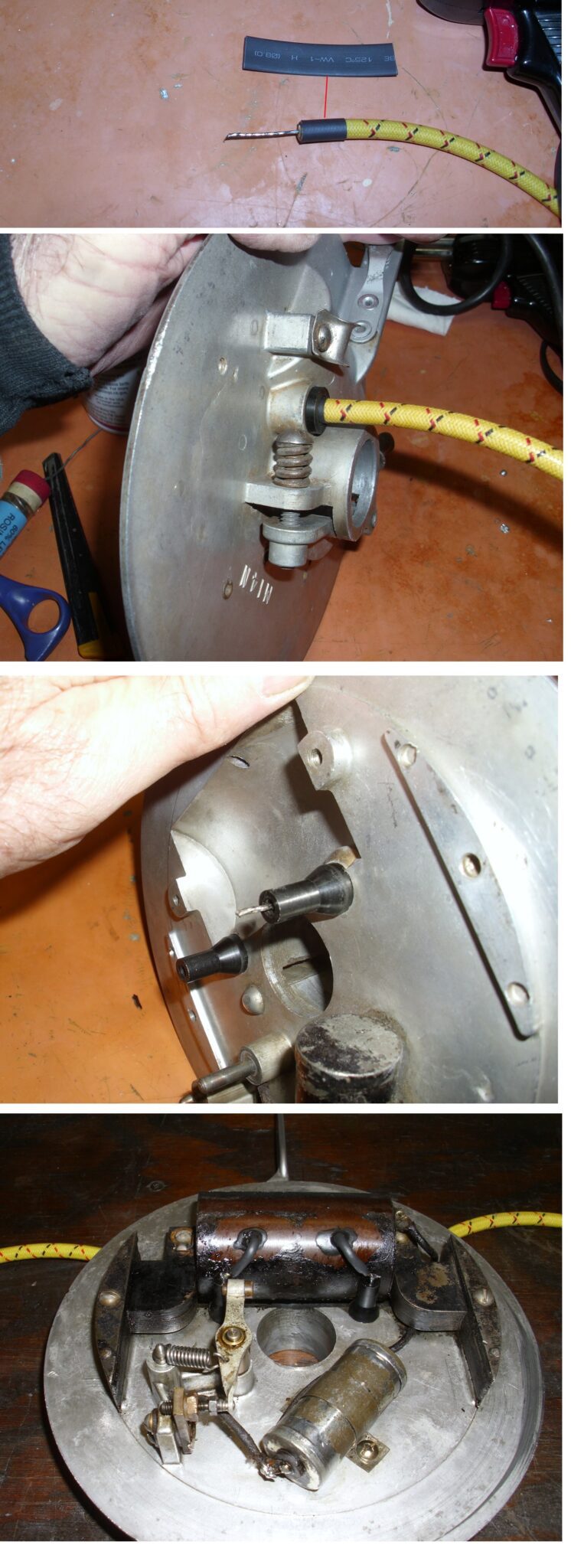

                  The coil in these seem to hold up. Care must be taken not to break the bakelite insulators. They can swell up a little over time and may not want to come out. This is how I replaced the plug wires. Carburetor substitute come from later Neptune’s. They show up on eBay from time to time. Can’t find the number just now. Have to go look on a motor. https://youtu.be/XPXjFZcMOl8?si=R0xTpRvtfepjK1uJ
                  P-wires
