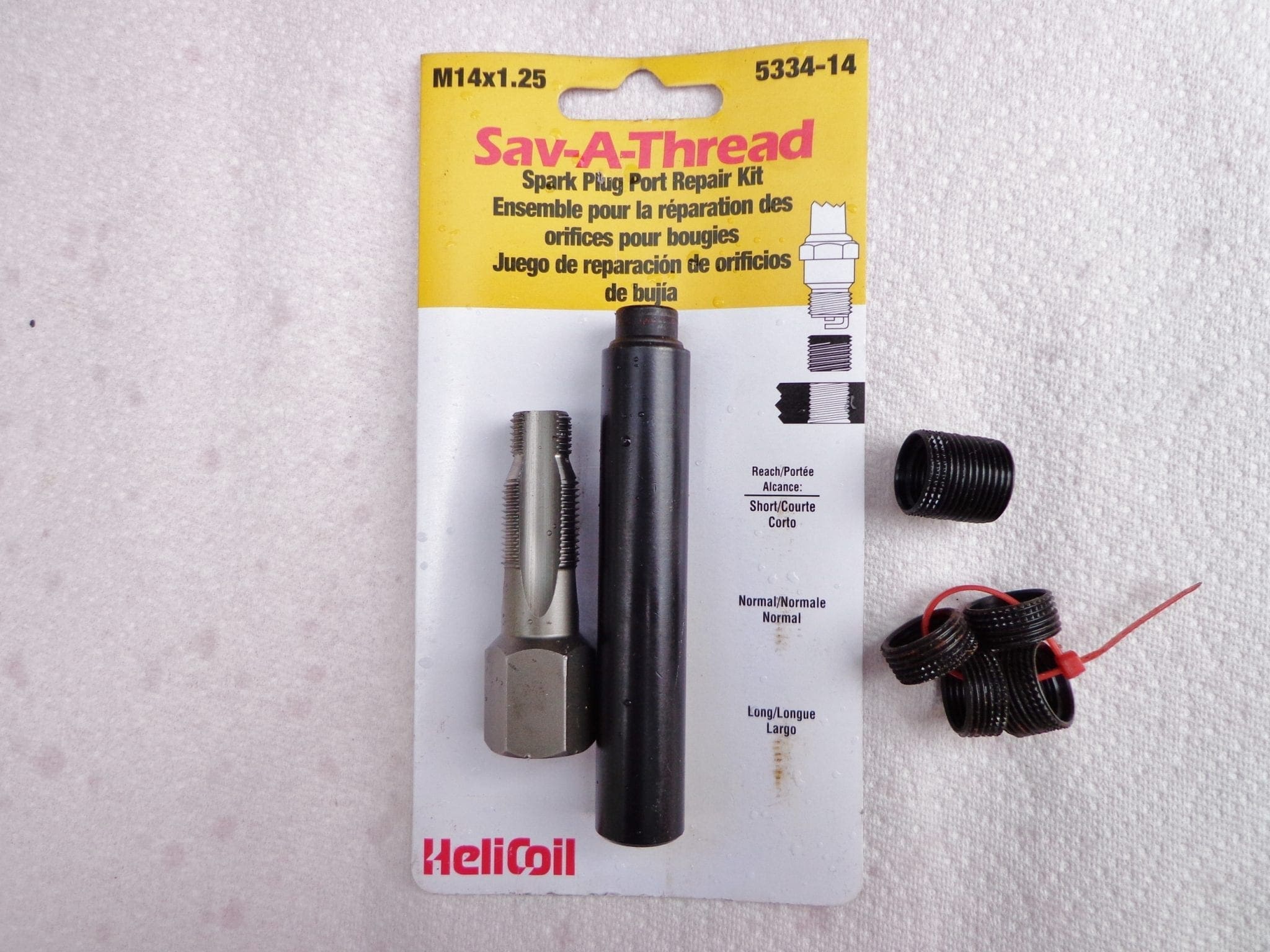

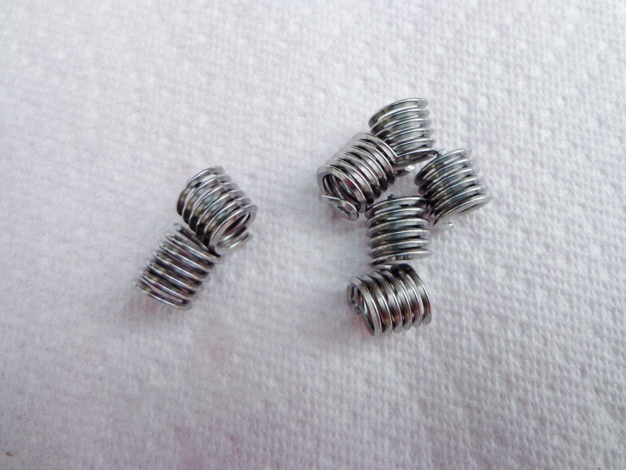

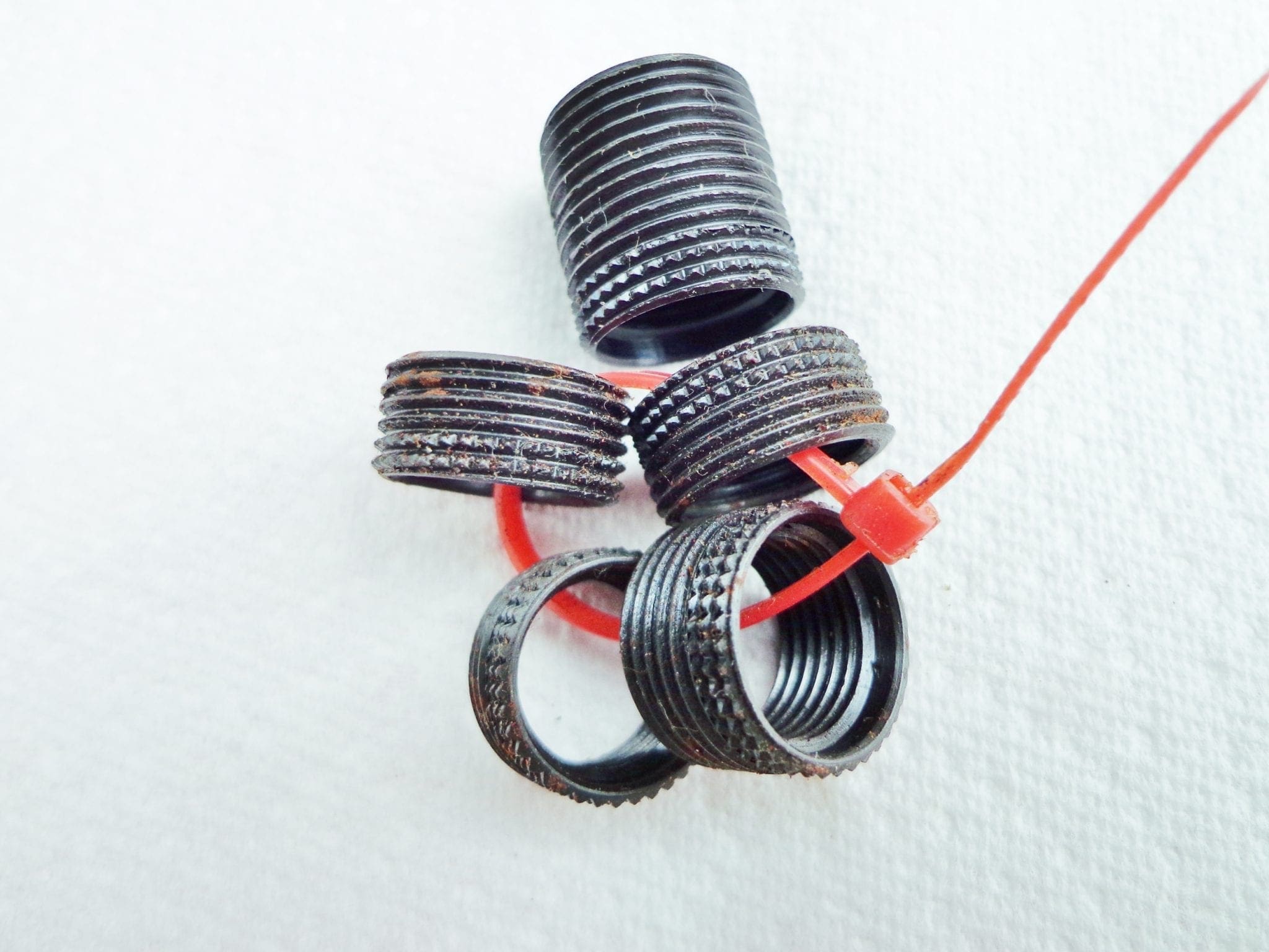

            To repair the stripped threads properly, you must use inserts designed for spark plug threads, not the regular wound wire inserts used for general thread repair shown in the third photo. The proper inserts get swaged into place with a bit of red hi-temp silicone on them.

              Mumbles is correct about the type of thread inserts you have to use for this repair. I used one of these on a stripped plug on a ’72 Evinrude 25hp and it worked perfectly. As an alternative, here’s a link to a list of parts for 1955 Evinrude and Johnson 3HP. They have a used cylinder head for $10 and I believe it will fit your 1954 model.
