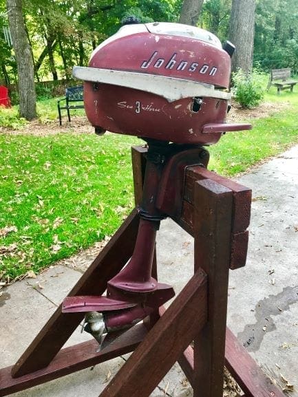

      Thanks! So, I tried to take off the bolts today, carefully, and one broke off. Fortunately, or maybe not, only the head did. Meaning the screw is still solidly into that hole. The bolts I did get out, lots of rust was coming out. So I am going to try it with the head on when I get the helicoil kit. Grease up the tool to catch the shavings. I see some guy in a youtube video “rinsed” out the inside of the head gasket to get any shavings. I couldn’t tell what he was using but it looked brownish liquid from a huge syringe. I hesitate to do that but was thinking I could tilt the motor down and try and vacuum anything out with the shop vac. I should have the spark plug specific kit and red silicone by tomorrow so more to come Wednesday probably if I get it as I also saw online you probably want to wait at least 24 hours before starting the motor afterward.
      I also started casually digging into my next project last night. I have a pair of 56 7.5 Fleetwins, one I got for $15 and the other for free. They each are missing little parts like the fill/vent screws for gear case, high and low speed knobs, etc. One has broken hood bumpers. Just some examples. But overall they seem solid and compression is around 70/70 on each after testing many times. Not great but “good enough” someone told me. I took the first flywheel off last night and it almost instantly popped. Hardly torqued on at all but looks like newer coils. The second one too, but interestingly that one blue and one ivory coils I can see through the port. That one, the flywheel has been a bear to get off. I can’t turn the center puller knob any further and hesitate to do so. Been doing lots of tap, tap, taping on the puller knob and trying again but doesn’t seem to help. Anyway, planning to pull the parts from both to make one and get a tank to go with it. But, if both motors are mechanically sound with newer coils, points, etc., I am reluctant to “part” one out and may see if I can trade one to another AOMCI member who would be interested in parting with another motor in similar shape.

          So update. Mission accomplished or so I thought. I applied the red silicone and threaded the spark plug specific insert in, the narrowest one since the head wall is so thin. Anyway, the insert still seems loose but when I thread in and tighten the plug, it’s snug. I had also made some adjustments to the carb needles. Tightened them and then backed them out the respective amounts. I got it going OK again but when I try to throttle it up fast, it sounds like the top piston is knocking. So I backed it down. Any thoughts on this? I’ve slowly been adjusting the carb needles but can’t seem to get rid of that knocking. At one point, the connection on the top plug (the one with the stripped hole I had replaced) came undone when I knocked it off. I haven’t put the hoods back on yet. I started it without realizing and it seemed to run fine on one piston before I realized what I had done. Weird. Any suggestions appreciated.

            #184216
            fleetwin
              You have done all this work, silly to take short cuts now…Find a decent used head, and a new head gasket…Once the head is off, use a propane torch and vise grips to remove the broken stud….
              The piston is probably hitting the plug/insert….
              Let me know if you can’t find a decent low priced head, I’m sure I have one somewhere…
              And yes, I agree, the 20ft pound plug torque is a bit excessive….

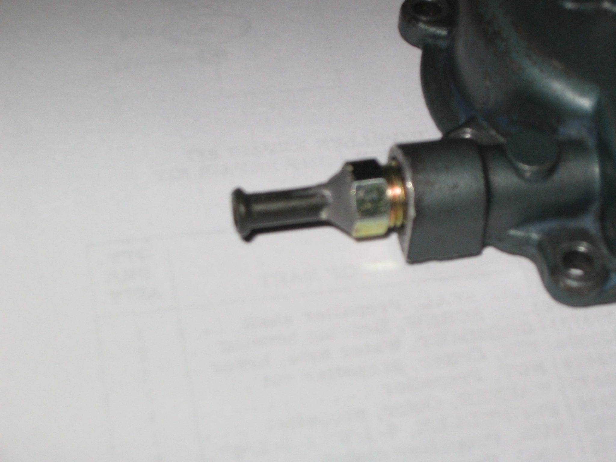

                      Sorry for the late reply. It dribbles off the muffler and high speed dial. But I think it’s coming from the fuel shutoff assembly. So I’m thinking of replacing that using the part from the other JW, which btw, also has a fuel filter atop. I noticed that my original JW does not have one and verified in the parts catalog I downloaded that it should. The fuel line going to the carb is also “stuck” on there. I never did remove it when cleaning and rebuilding the carb because the bolt screwing it in was so worn and rounded. It wouldn’t come out. I had verified fuel flowed freely through it though. So that could be an issue too. Now that I have another fuel line to replace it, I am going to go to town on getting that thing out of there even if I wreck it.

                        new JW carb fuel inlet nipple made with a automotive brake line male fitting and tubing ………… reverses and flanged held in place with a dab of JB weld 🙂
