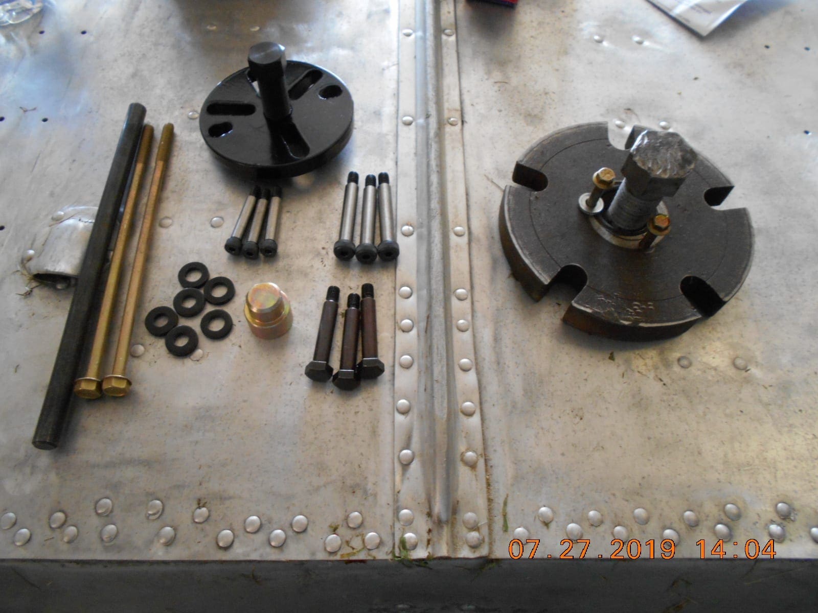

      Opened up the new OMC puller today. Looked nice, but not as “beefy” as what I was using.

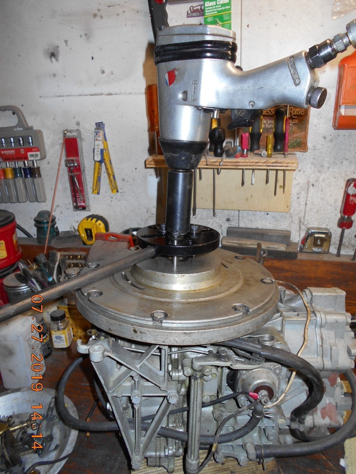

      Installed the puller on the flywheel, snugged up the shoulder bolts, then proceeded
      to tighten the center bolt with my air impact. Nothing happened, so I got out the
      breaker bar and cheater pipe. Was only able to tighten up a tiny bit more, and still
      nothing happened. Put the air impact back on, and ………. Finally!!!!

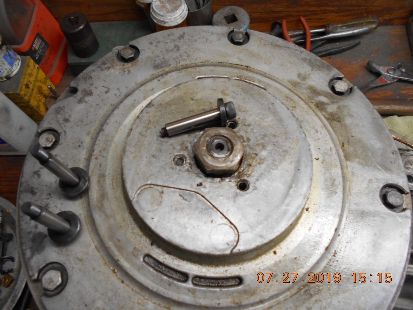

      ………. One of the shoulder bolts snapped. 🙁
      Soooooooooo, I spent $85 and I’m still no further ahead….. in fact, behind, as the
      bolt broke off half way down the hole, and I’m minus one shoulder bolt now.
      Was not in the mood to try to get the broken bolt out today.

            I tried for about 45 minutes today to get the broken bolt out of the hole with no luck.
            Of course a drill bit wouldn’t touch the hardened bolt. Was hoping a left hand drill bit
            would grab and unscrew the broken piece. I made a tiny chisel out of a punch
            and punched a little straight slot in the top of the broken stud, and spent the next
            half hour turning it back and forth about 1/4 turn. It would bind up in either direction.
            The more I monkeyed, the worse it got.
            Could not find an appropriate little stone for my dremmel. Was going to try to grind a
            hole into the broken stud and try an easy out. I don’t have any tungsten carbide burr bits
            either. I’d like to try to remove the broken stud and attach the puller again, and get
            the torch back out. The OMC puller is quite a bit smaller in diameter, so I might be
            able to get more heat near the crankshaft than with my other puller.
            If I can’t get the broken stud out , then I may be resigned to destroying the flywheel. 🙁
