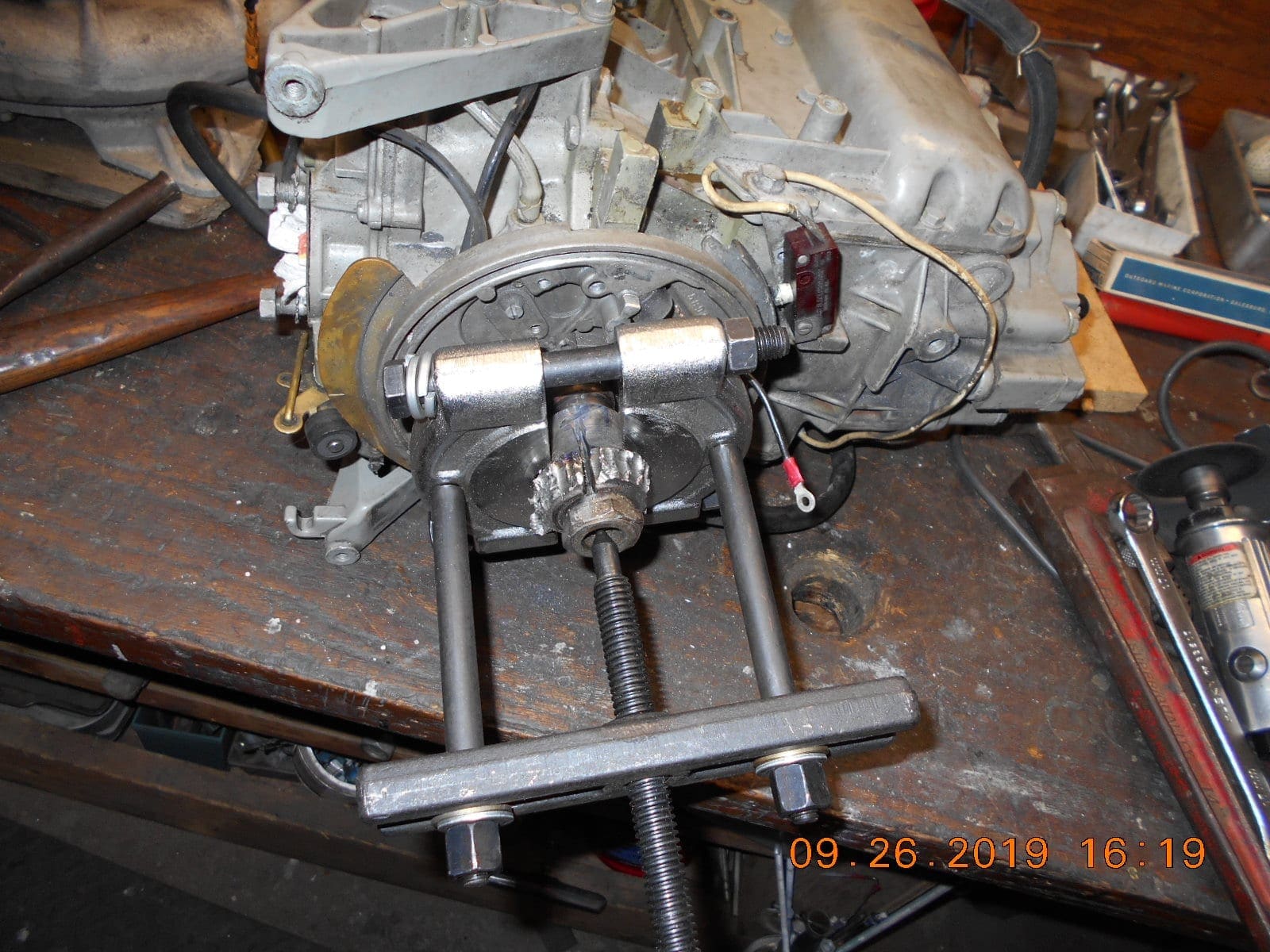

                Bob, the power head is sitting on my workbench with the flywheel puller on,

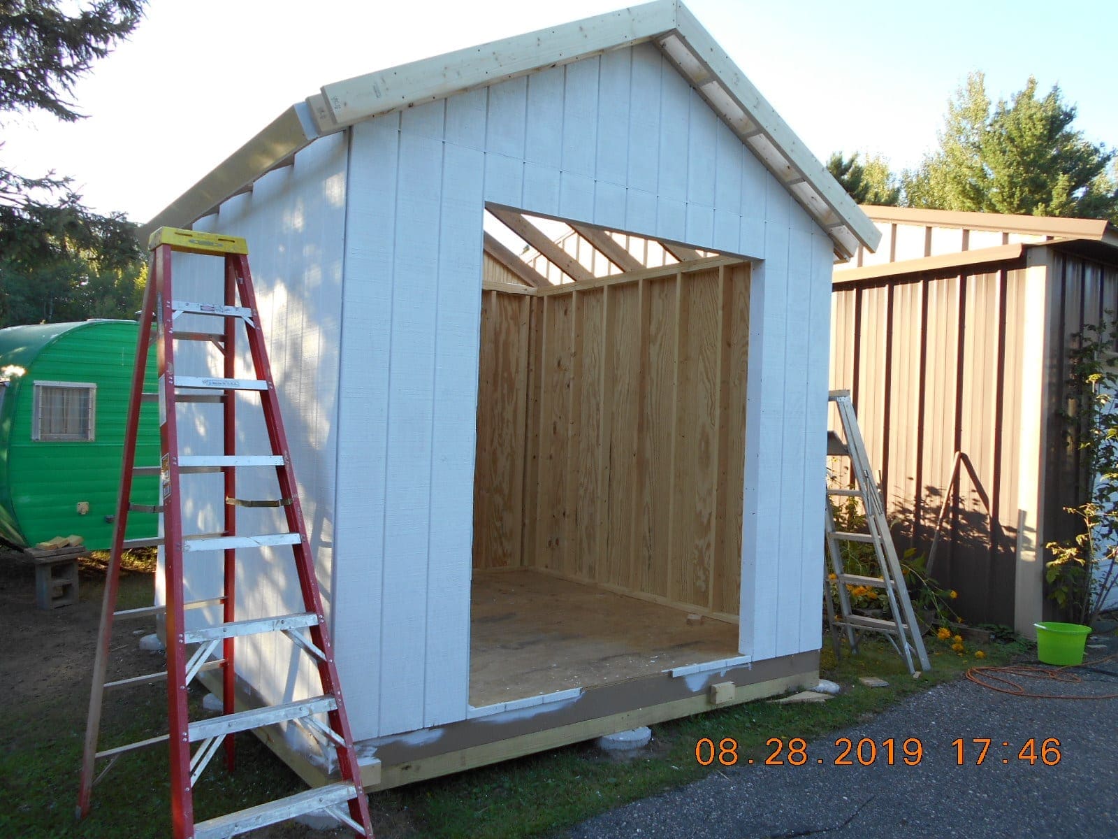

                under pressure, while I’m trying to build a 10′ x 10′ “outboard” shed. My
                wife thinks rakes, shovels, ladders, weed wackers, etc., are going in it.
                I glance occasionally at the bench to see if the flywheel magically popped off, but always “No”.

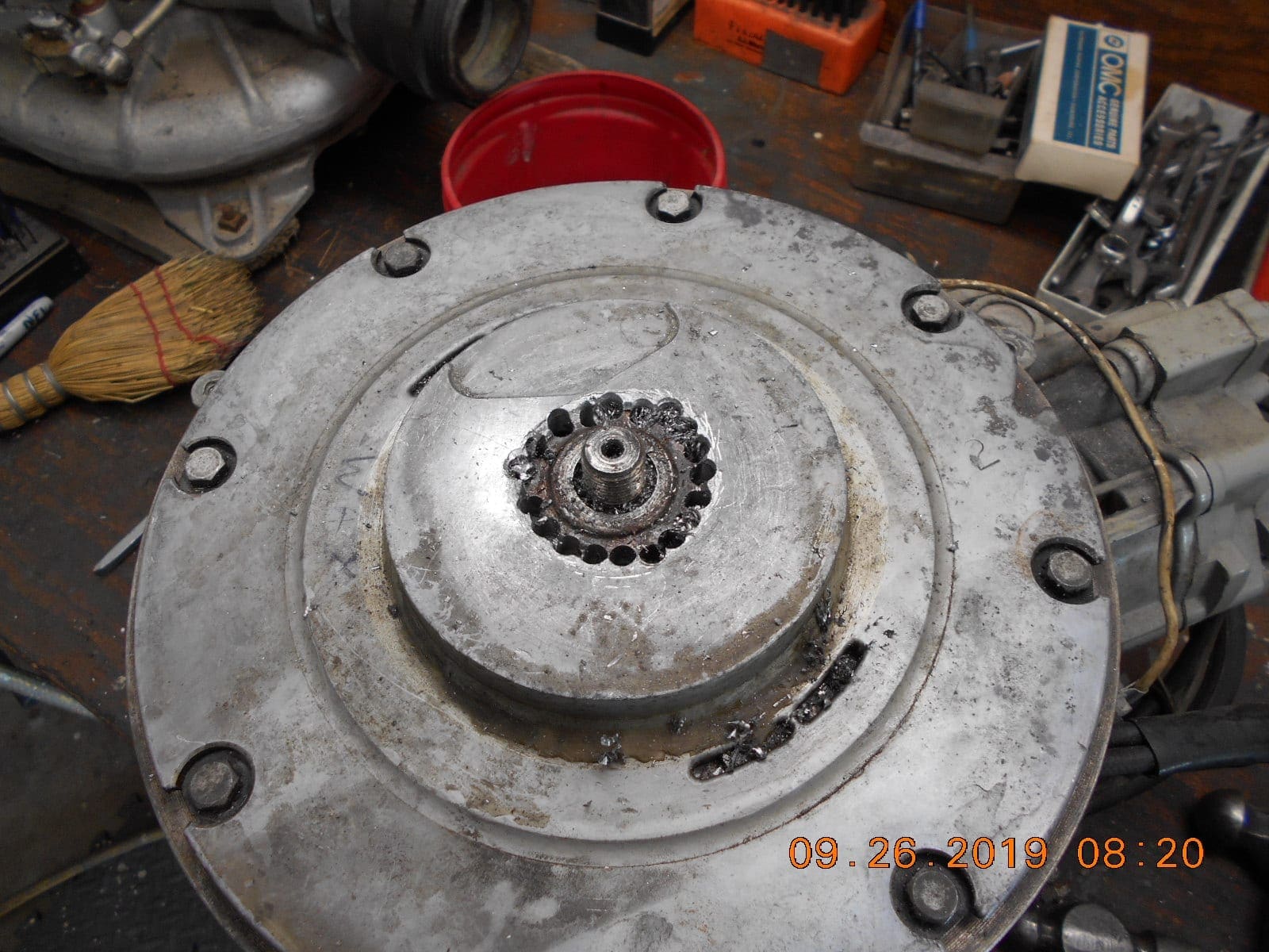

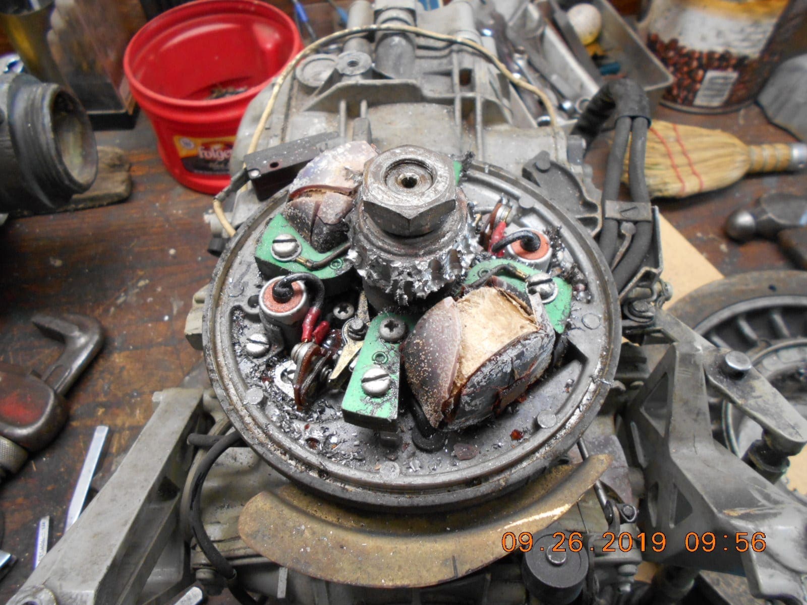

                    So, I put the 40 hp Gale power head with the stuck flywheel in the freezer
                    for two days with the flywheel puller attached and tensioned, ready for
                    action. I had the torch ready to go in the garage. Rushed said power head
                    out to the garage, fired up the torch…… nothing happened. Tightened
                    the puller up more….. same old story, snapped off one of the 1/4″
                    shoulder bolts. Decided to drill out the three 1/4″ holes for 5/16″ shoulder
                    bolts, which I had purchased, “just in case”. Drilled out the first hole
                    with my “F” drill bit. Started tapping with my USA made tap. Had 1/16″ to
                    go tapping the first hole, and yes, I snapped off the tap.

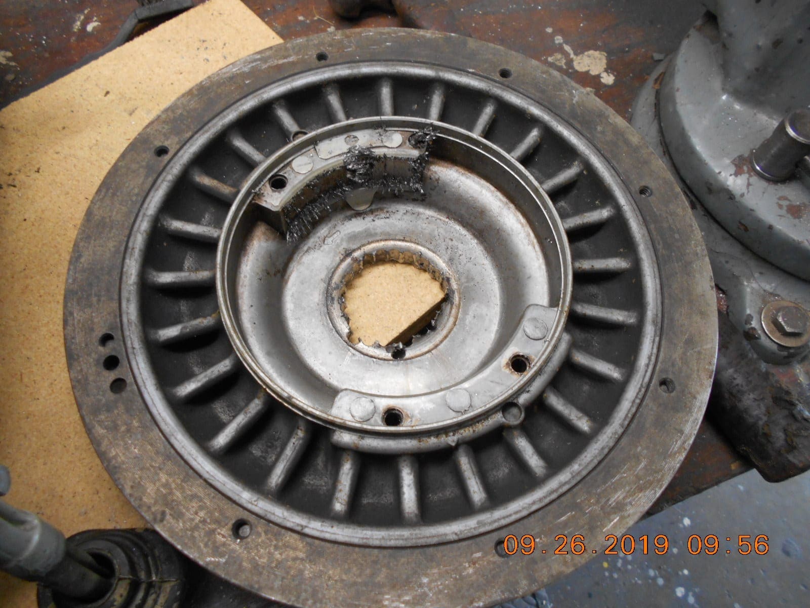

                    Made several futile attempts removing the tap, including welding a nut on.
                    Gave up, and decided to destroy the flywheel to end this long tiresome
                    saga. Drilled holes all around the crankshaft in the same arc as the three
                    puller bolt holes. Spend much time connecting the dots, a.k.a. “Holes”
                    with punches, chisels, and more drilling at angles. The broken tap fought
                    to the end hole the flywheel on, but I finally managed to break the flywheel
                    free. Was then stuck with the steel hub over the crankshaft. Attached
                    my bearing puller to it and it wouldn’t budge…… not that I really expected it
                    to. Then put the air grinder and cut off wheel to work, cutting thru the hub
                    where the flywheel key was, so the keep the grinding wheel away from the
                    crankshaft taper. The hub did not want to budge until I cut a slot on the other
                    side and got the torch out and started “heating”…… after two months of
                    monkeying around with this flywheel, I was finally satisfied with a mighty “POP”.
                    I was afraid of ruining some good coils, but alas, I need not have worried
                    about that…… they were originals.
                    I’m only going to finish this project “if” I find a cheap flywheel.
                    I would love to hear the old Gale run, but it being a “non electric start” model,
                    not sure I’d be able to pull start it anyway!

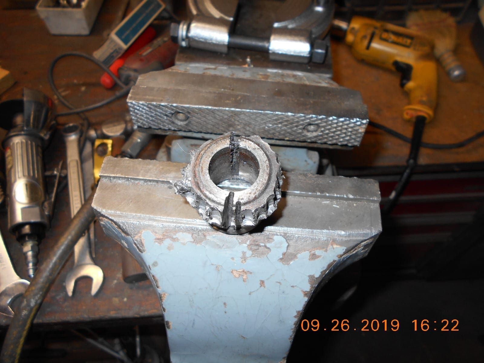

                    #184093
                      Good used hub for sale, lol.
                      DSCN8135

                        Man, that was one tough mother – those 100ft-lb flywheels must do their job well! Hate to see the flywheel destroyed to get it off, but at least it’s off. I was hoping your idea of the freezer and torch method would have worked.
