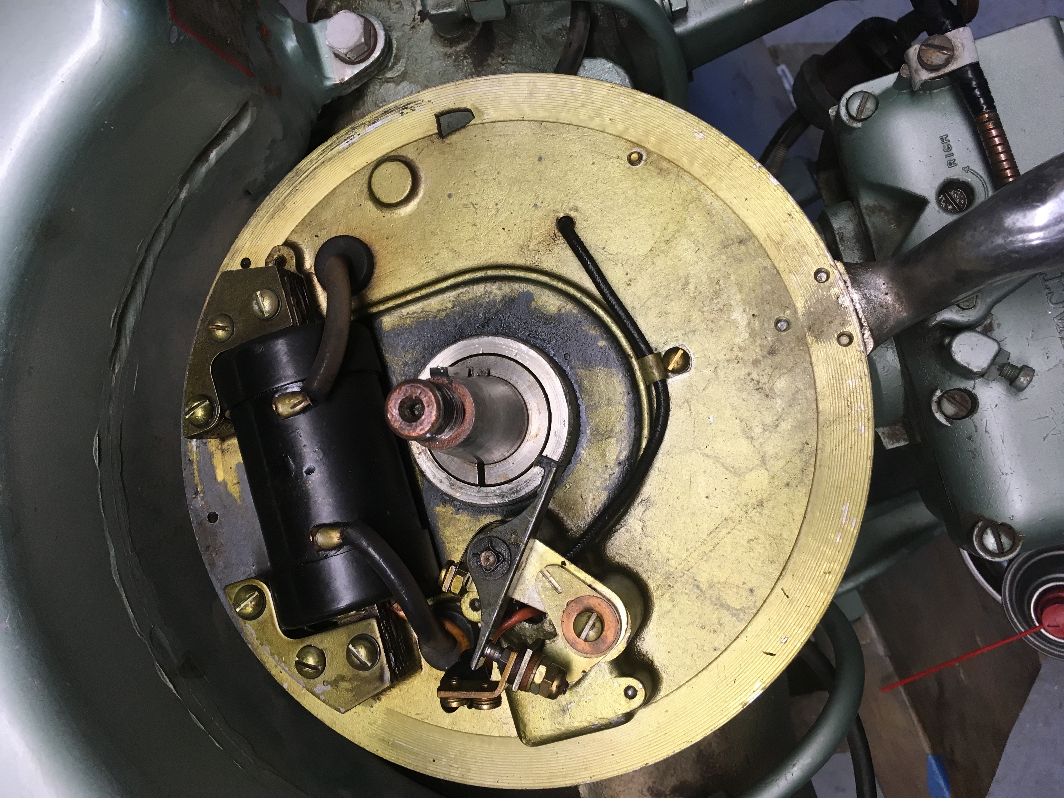

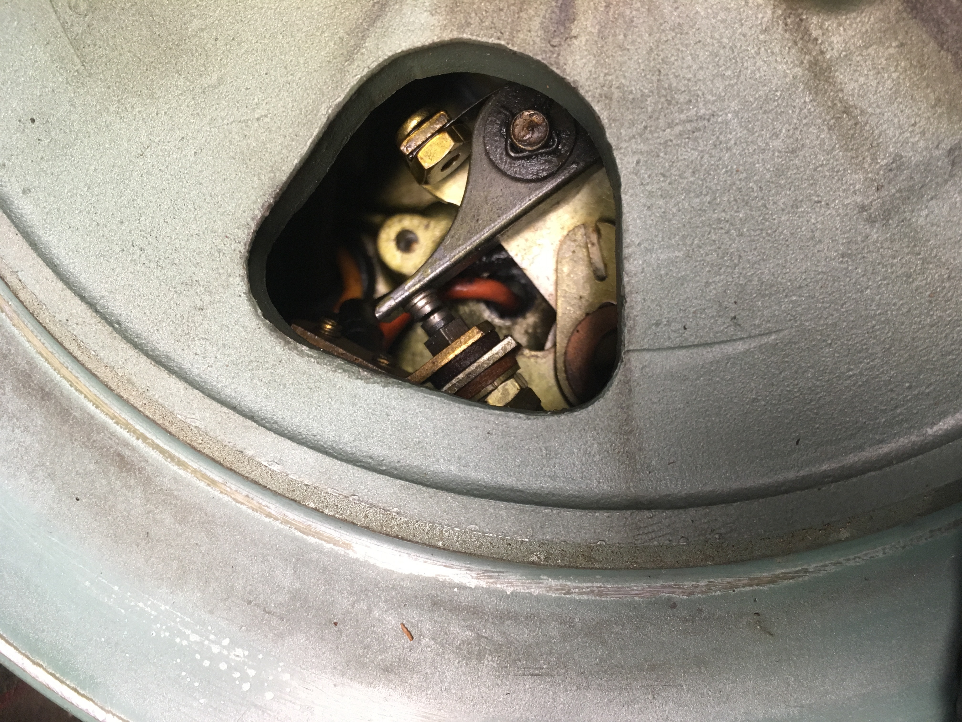

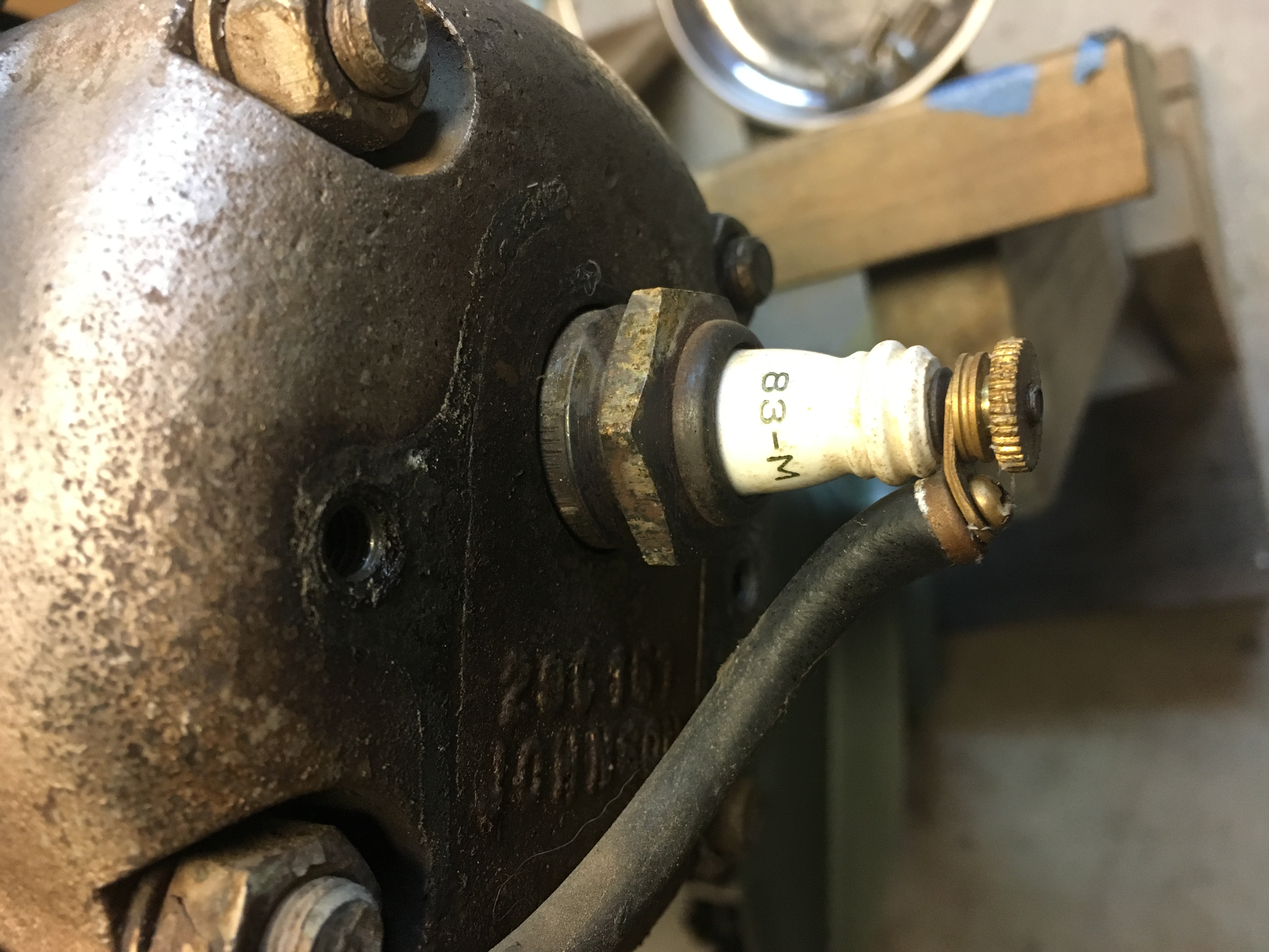

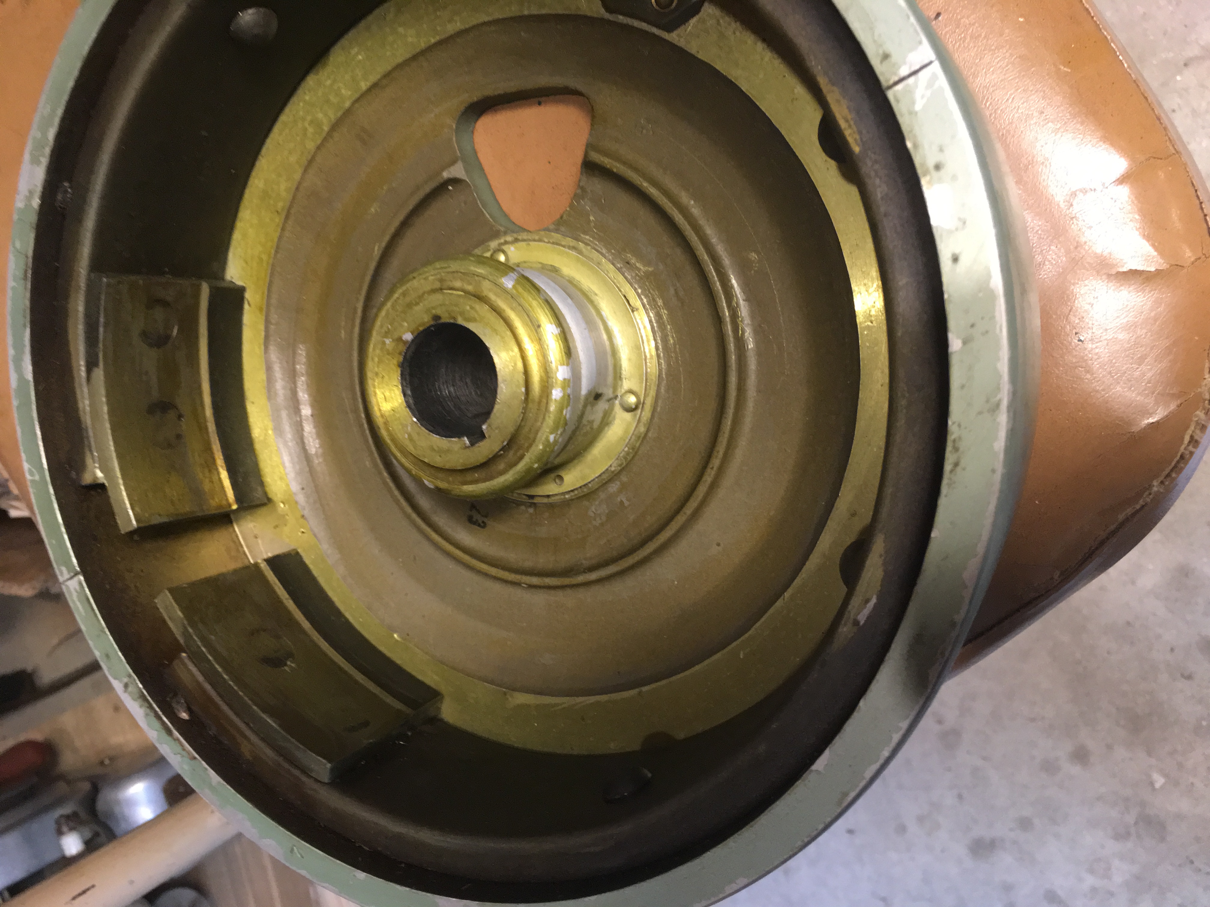

      I pulled the flywheel last night. Cleaned the points. Coil is good(testing with meter).

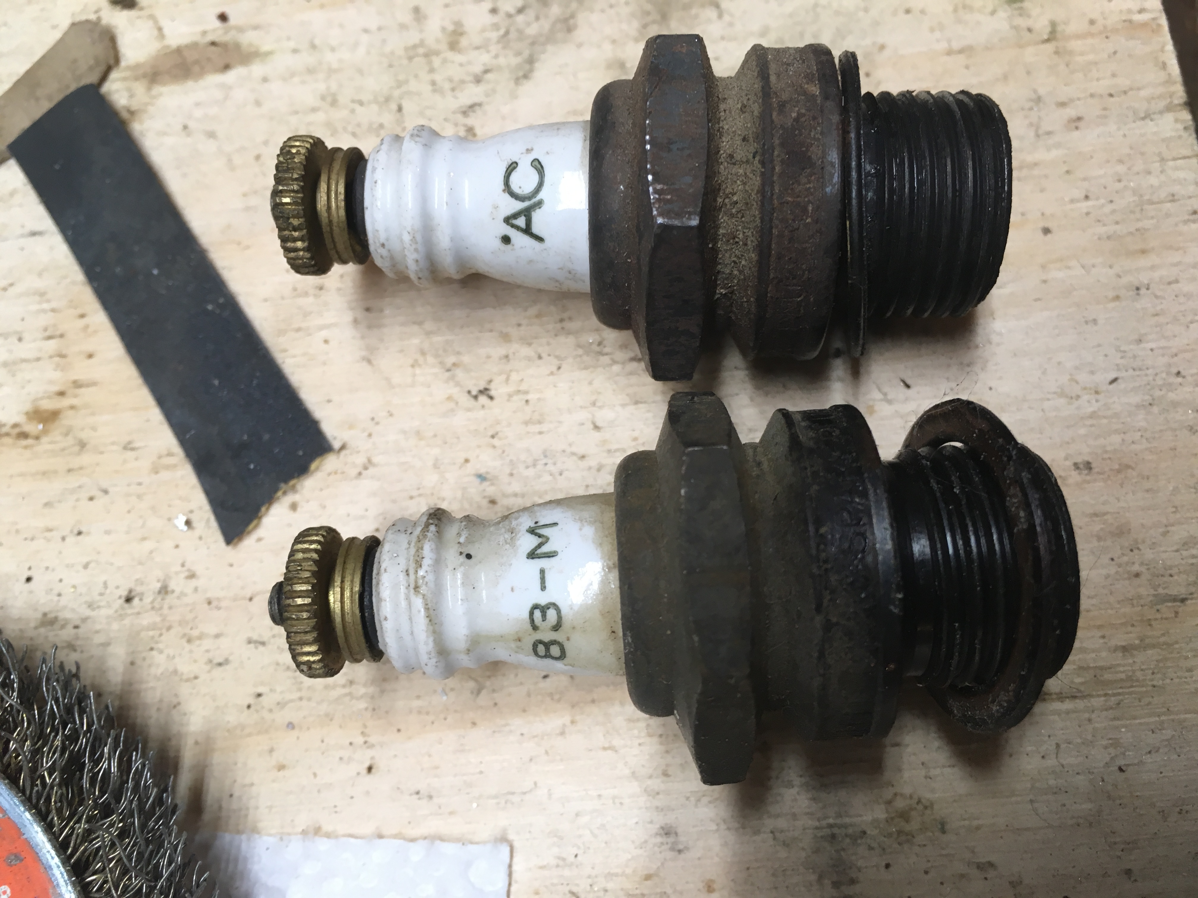

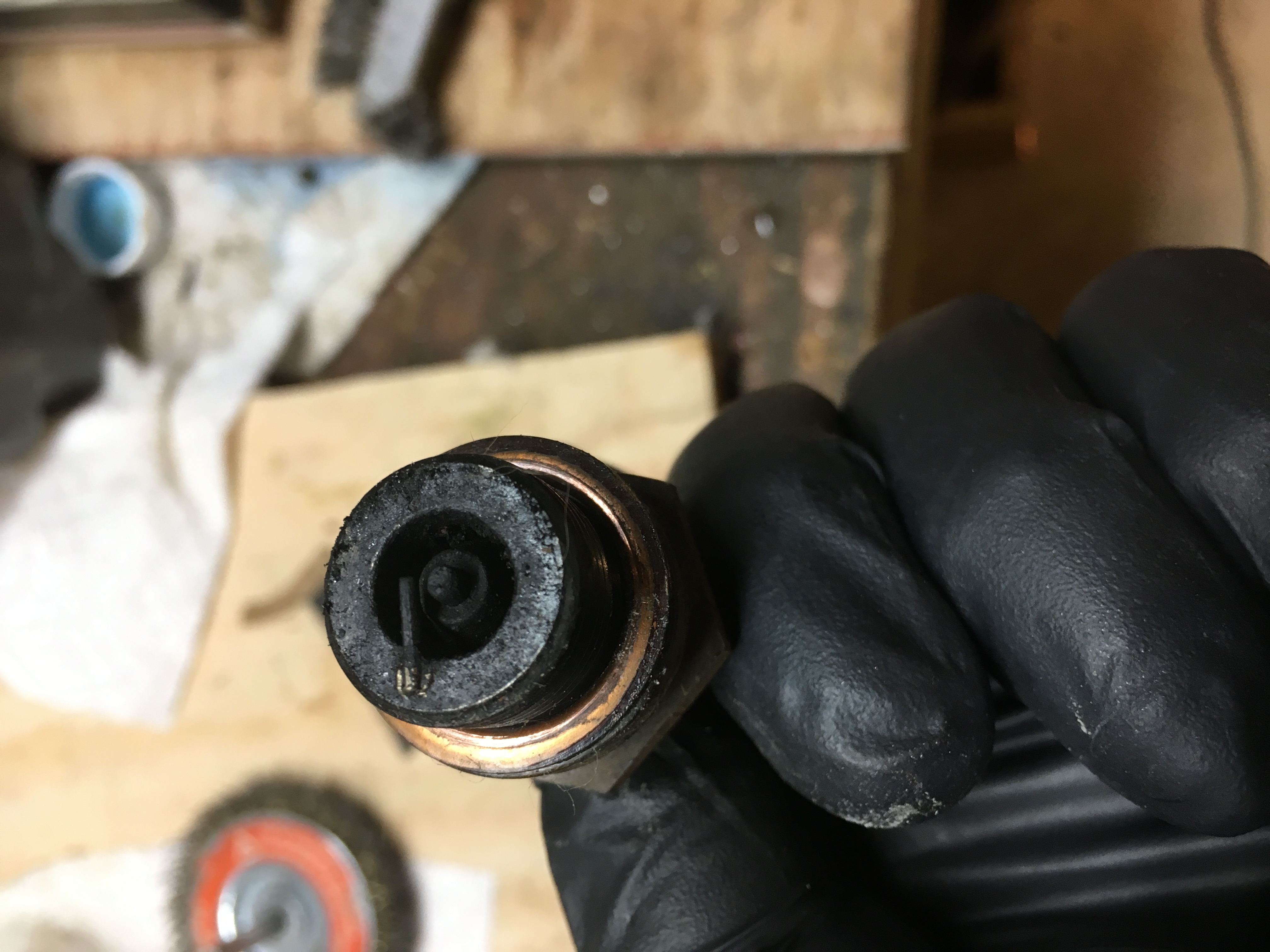

      Spark plugs have been there a while. Maybe original.
      Moving on to the carburetor next.
      Does anyone have the flywheel torque spec?
      #82637
      stanley
        65-70 ft.lbs.
        #82667
        david-bartlett
          quote Stanley:
          65-70 ft.lbs.
          Stanley,
          Thanks. That is a much easier value to work with than “One or two good whacks with a hammer on the end of the wrench”.

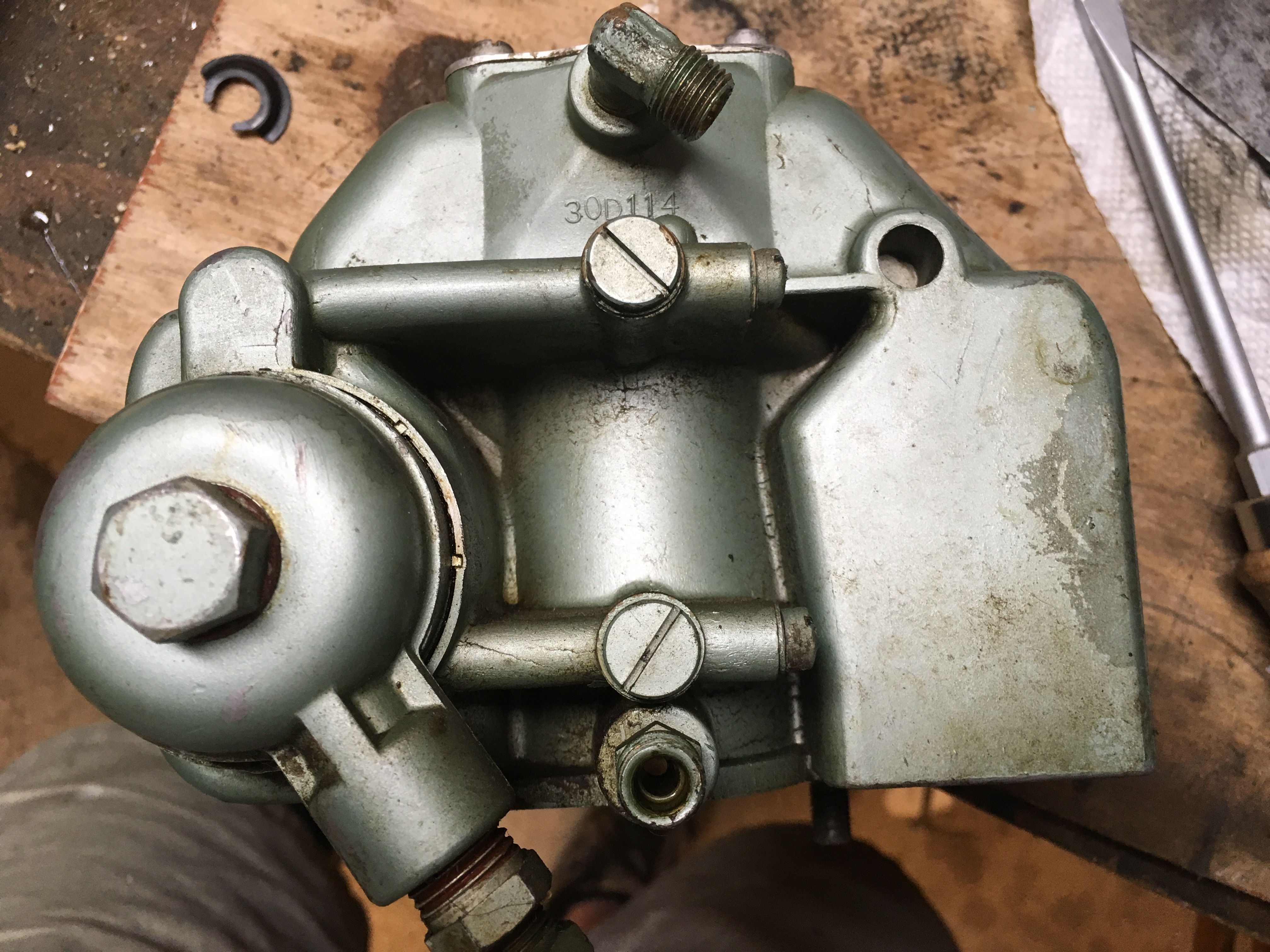

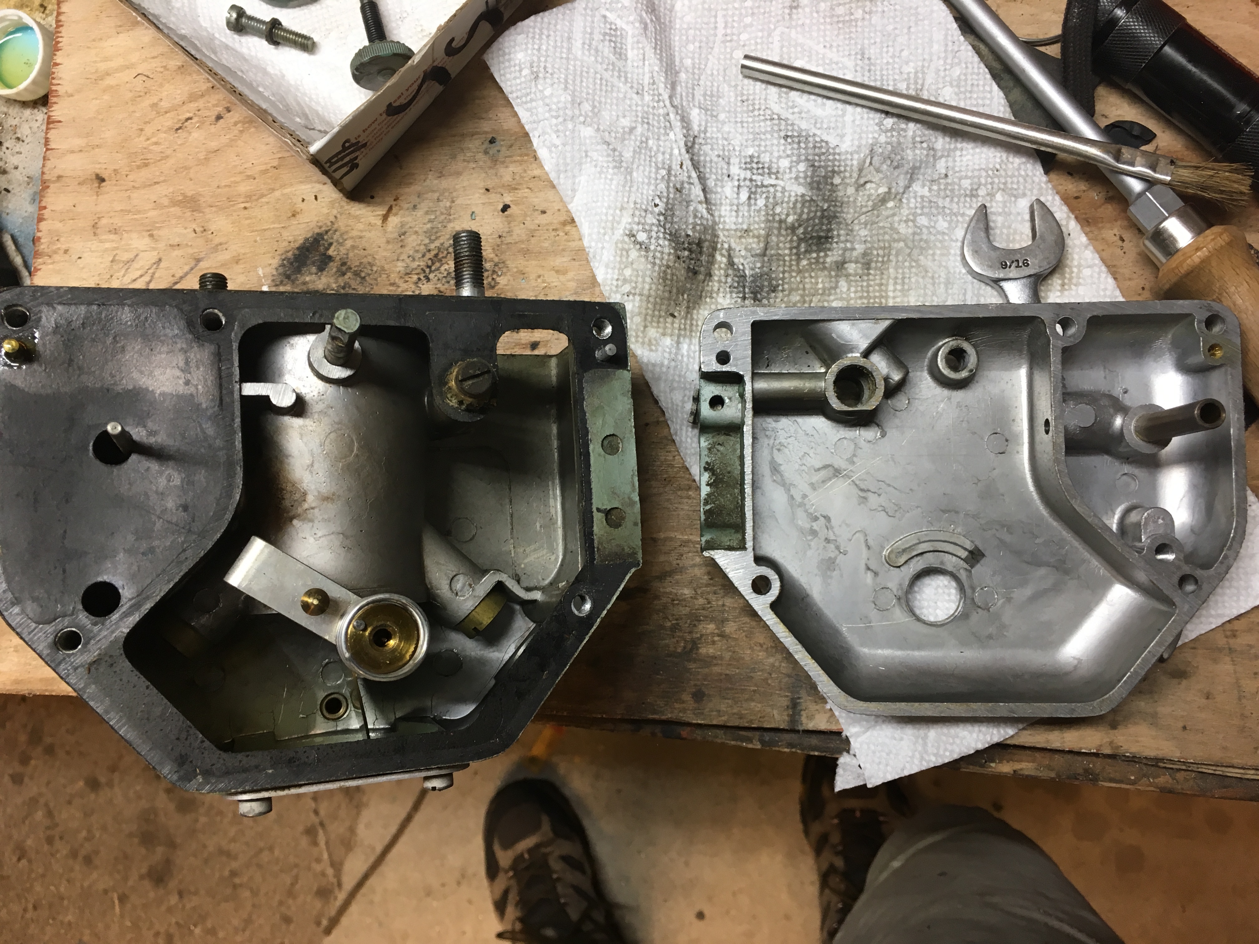

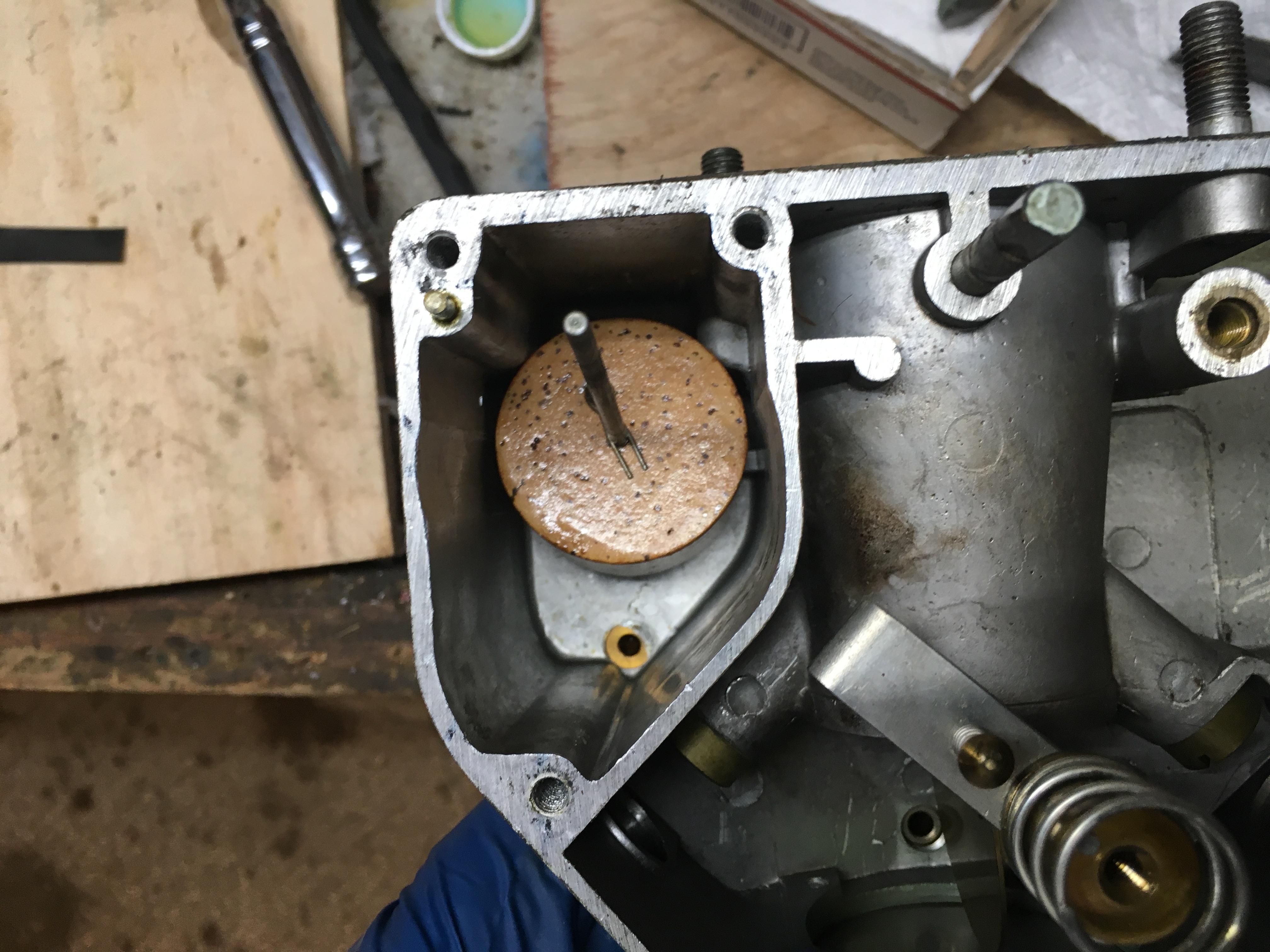

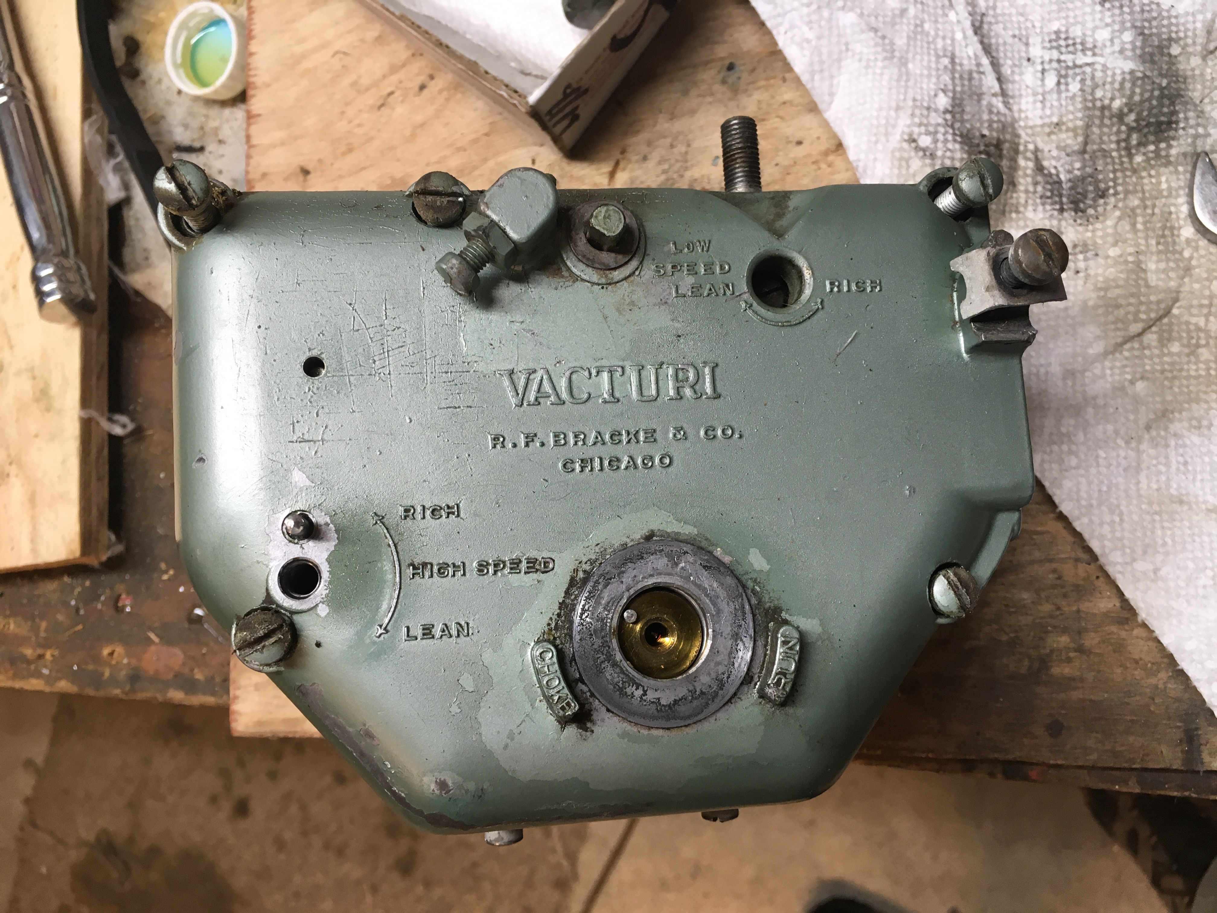

            I got into the carburetor today. The Vacturi carb is pretty neat and was very clean inside. Just a little goo in the sediment bowl area.
            Screws on the bottom have never been removed.
            #82805
              Unbelievably clean. Cool looking carb too. It’s going to be a great motor.
