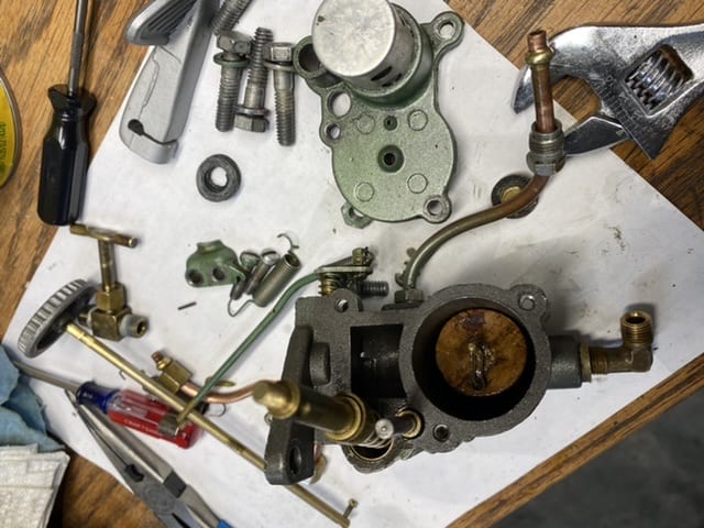

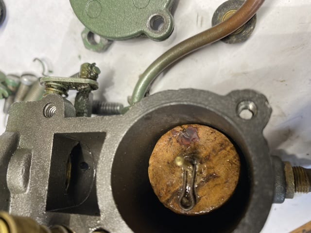

      I took the carb apart and removed the float and float pin. It was dirty and when gently pushed into the seat it would stick. I cleaned and polished the pin, cleaned and redoped the float and put it back together. The float pin movement was much better. After all was assembled i gassed her up and no leaks. Sea trials on a cold lake scheduyfor tomorrow.

        Michael Purpura
          Frank,
          I cleaned and polished the brass float pin. Now it seats snd stops the fuel flow. Thank you for your help with this problem

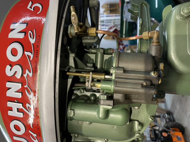

          #236728
          lloyd
            Glad to hear it Michael and you did exactly the right thing!! And your motor looks beautiful from what I can see. Good luck and have fun on the lake tomorrow!!

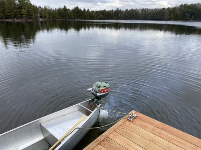

                Michael Purpura
                  I don’t know how to upload a video here. But here is a still of the motor idling at the dock
                  31B5D316-88E1-4E76-A3DC-C3C18A2F4D9E
                  #236791
                    Upload your video to Youtube, then post a link here.
                    #236793
                      that canoe must fly with a 5hp in the back ! I have the identical TN27 in the shed but never got around to using it . needs a bit of cosmetic work but it is ready to go 🙂
