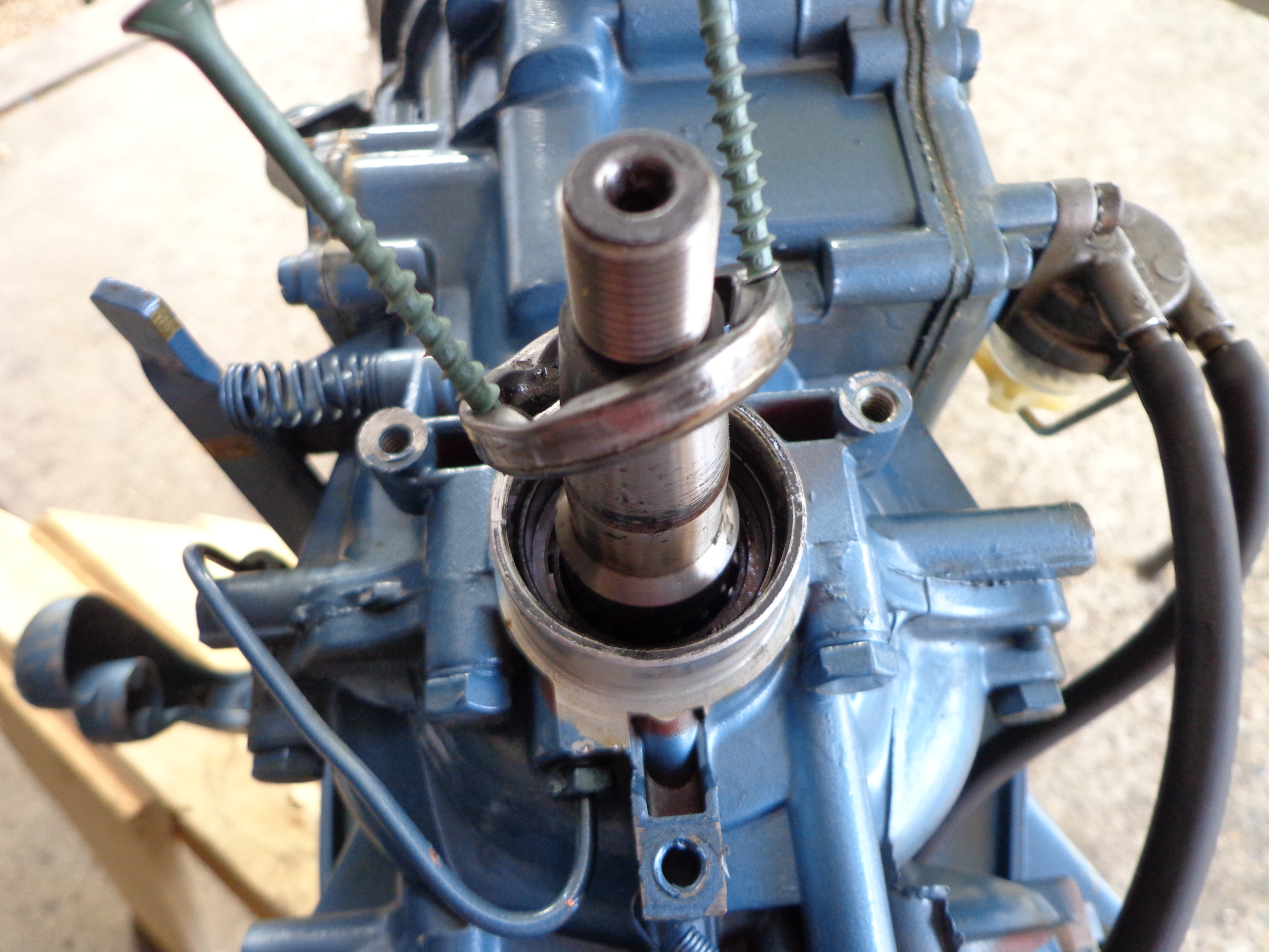

Shoot me a PM. I have a powerhead for you.February 13, 2017 at 12:37 am #52898Update… My motor didn’t actually fail the leak down test, I re tested with the motor locked at TDC and both cylinders passed. I think I’ve tracked the problem down to a bad crank seal at the top. The top spark plug stays perfectly clean, and the bottom plug gets soot on it. I installed a tiny tac and ran the motor for 3.5 hrs today. The max RPM I get is 3,400RPM.
The reason I think it’s a bad crank seal is because if I spray the top of the block (under the armature plate) with brake clean, the motor will stall. This also would explain the clean top plug (running lean).Motor running and being sprayed (you can hear the RPM’s drop, didn’t spray it long enough to kill it)

Is this tool the only way to change the seal without taking the case apart?
February 13, 2017 at 2:03 am #52905To confirm the top seal is leaking, you can pour some TCW oil or fuel mix on it and crank the motor over with a socket. This has to be done with the mag plate removed. Removing the spark plugs will make it easier to crank it over to.
https://www.youtube.com/watch?v=cXt6fV6Z5rc
You can remove the seal if you don’t have the proper tool or don’t want to split the cases. Punching or drilling some holes in the seal will let you get some screws threaded into it which can then be used to work it out. The bearing is right below the seal so you want to make sure you get any metal chips out before installing the new seal.

February 13, 2017 at 3:35 pm #52934The crank seal is indeed bad. Oil all over everything, including the points, and when I did the oil test, it blew bubbles.
Oil test:
