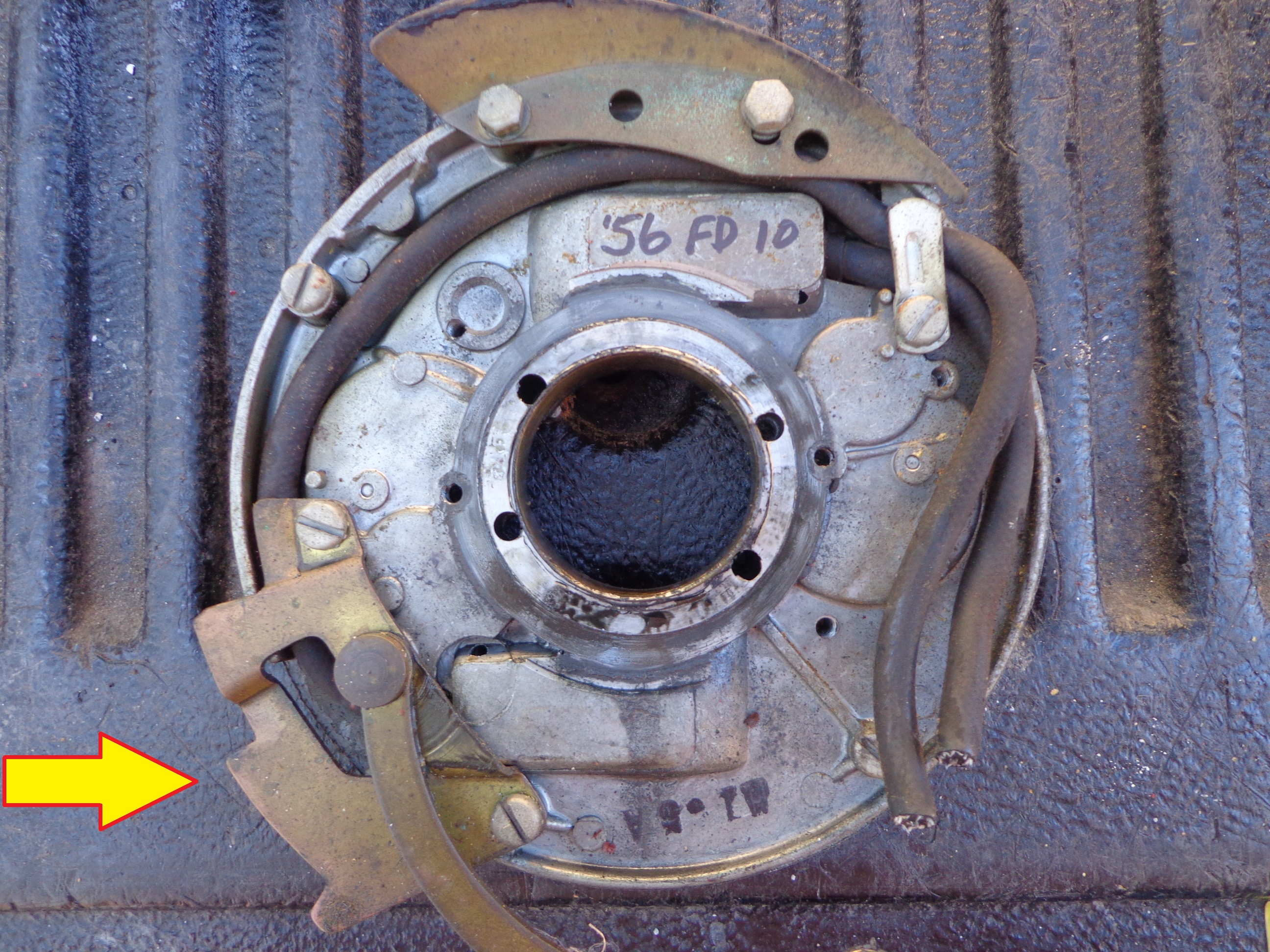

February 19, 2017 at 4:13 am #53245Without reading this whole topic again, are you sure the carb is opening fully and the timing is going to full advance?
Take a look at the shift lock lever and the brass plate on the mag plate when you advance the throttle with the motor in gear and in neutral. There are steps on the brass plate and the lock lever contacts these to limit the motor speed depending on which position the shift lever is in. One step limits neutral speed and another might limit it while in reverse. In forward gear there will be no contact and this allows full throttle operation.
Here’s a ’56 mag plate but yours should be similar.
February 19, 2017 at 4:47 am #53248The carb butterfly is opening all the way and the timing advance goes to the max. I don’t think my motors has any kind of shift lock stuff? I can start it in gear, and I can go wide open in neutral. I’ll double check.
February 19, 2017 at 4:56 am #53251I bet this piece is supposed to be taller isn’t it?
February 19, 2017 at 4:57 am #53252Here are the positions at WOT
February 19, 2017 at 5:45 am #53254quote stephenspann27:I bet this piece is supposed to be taller isn’t it?Yes it is, that one has been cut off. Nothing to stop you from going to WOT regardless of whether it is in gear or not.
