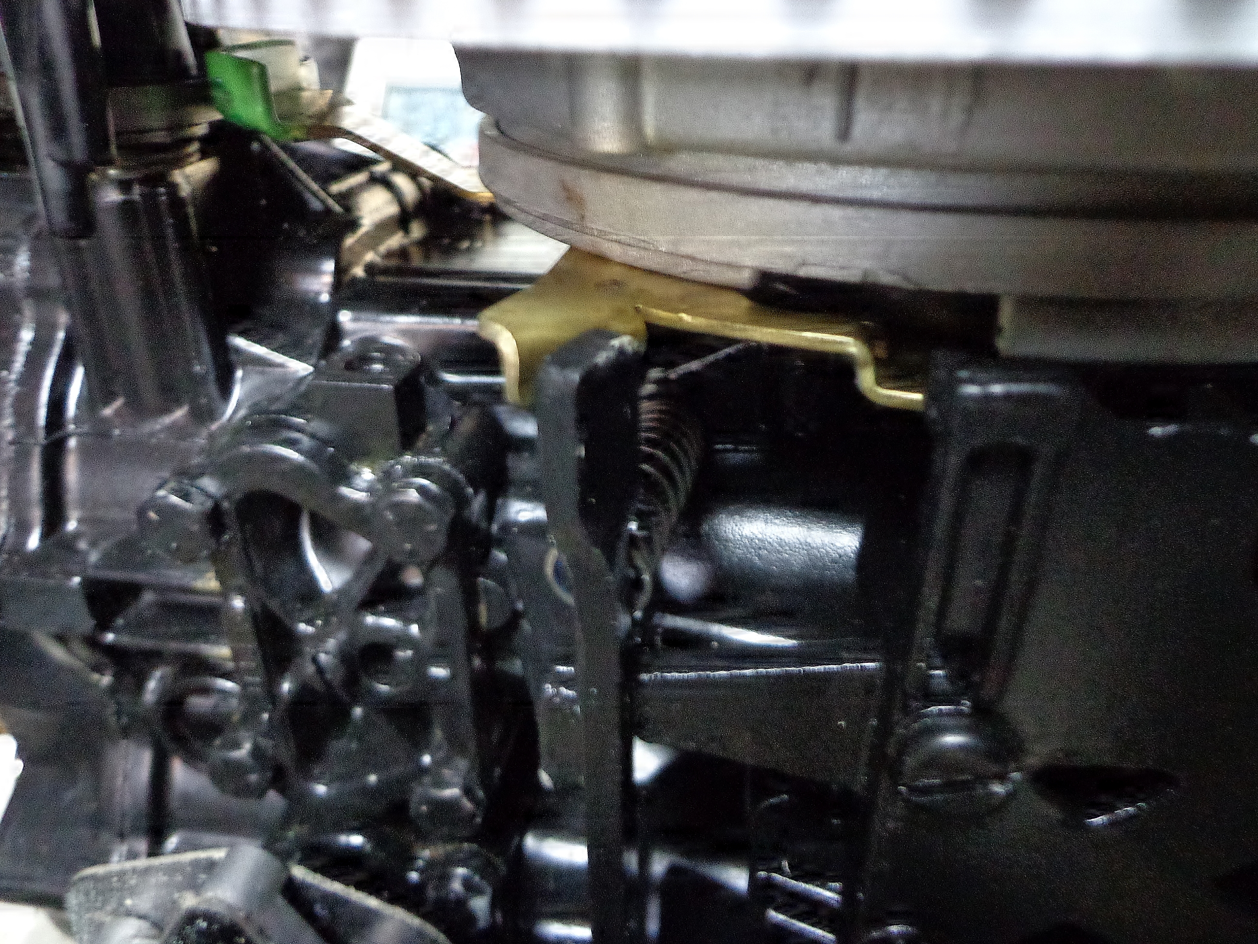

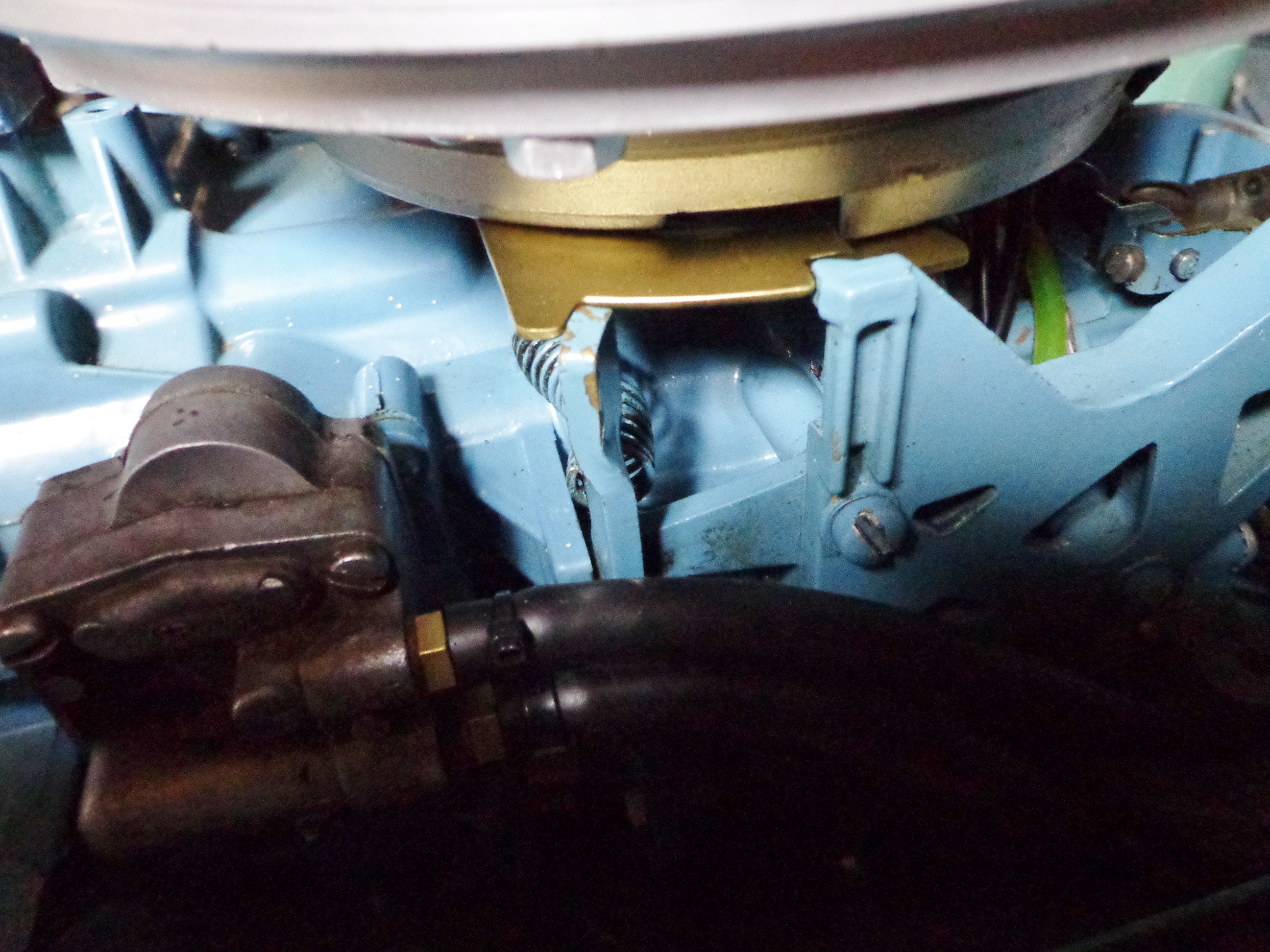

February 19, 2017 at 3:59 pm #53267Hold on a moment before you do anything drastic. The last step on the brass plate might make contact with the block at WOT, not the shift lock lever. I’m sure some models do. There’s a few 18’s in the garage so I’ll take a look when I go out there.
Do you know if any mag parts have been swapped around in the past? There’s a reason that shift lock lever has been shortened and the motor not making full RPM could be it.
February 19, 2017 at 4:33 pm #53268On this ’65 FD with a ’72 Evinrude powerhead/mag on it, at max throttle the brass plate does make contact with the lock lever but on this ’63 Gale built 15, the contact is made on the starboard bracket, leaving a slight air gap between the plate and the lever. Hmmmm…..
I have more 18’s but they aren’t handy at the moment.

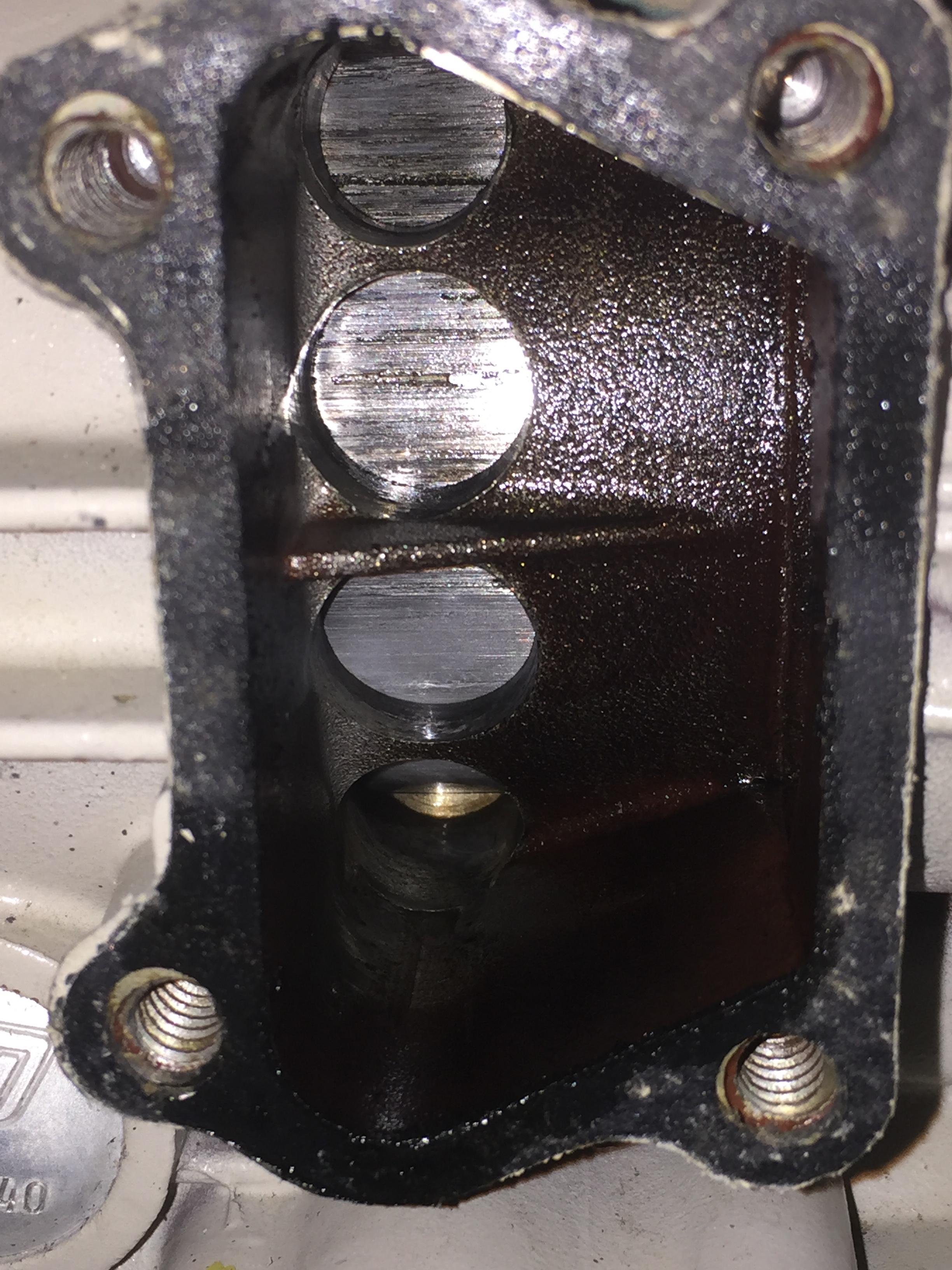

February 19, 2017 at 5:19 pm #53275The above is correct, I just thought since it had good compression and passed the leak down test it was worth trying some other things. I tore the powerhead all the way down this morning. Not a single gasket was leaking, the burn looked even between the cylinders according to the piston tops and the carbon on the head. No smoking guns as far as getting fuel/air in and out of the motor. The verdict is a like mentioned above, the pistons and rings are scored. The rings are still free on the pistons, and bores are not terrible. The motor has definitely been hot. The crank bearing surfaces are blue from running hot. The crank bearing surface at the top (where the seal was leaking) is trashed. The crank out took out of my original, blue powrehead is actually in better shape than this one. Pictures in the next post.

February 20, 2017 at 4:05 am #53313Stephen,
That one is surely worn out. It is like Bill W said, they will continue to run way beyond when they should quit. Time for a new powerhead on your otherwise good motor.
In your next to last picture, the reed plate looks like one of the reeds was not lined up properly to seal. Maybe this happened when you took it apart. NOt really an issue now, but was just curious if this had anything to do with your dry spark plug issue.
February 20, 2017 at 11:26 am #53319quote david bartlett:Stephen,That one is surely worn out. It is like Bill W said, they will continue to run way beyond when they should quit. Time for a new powerhead on your otherwise good motor.
On the reeds, yea that was my fault, I had taken them apart then just slapped them together. The motor was really in great shape as far as gaskets, torque specs, and corrosion.
