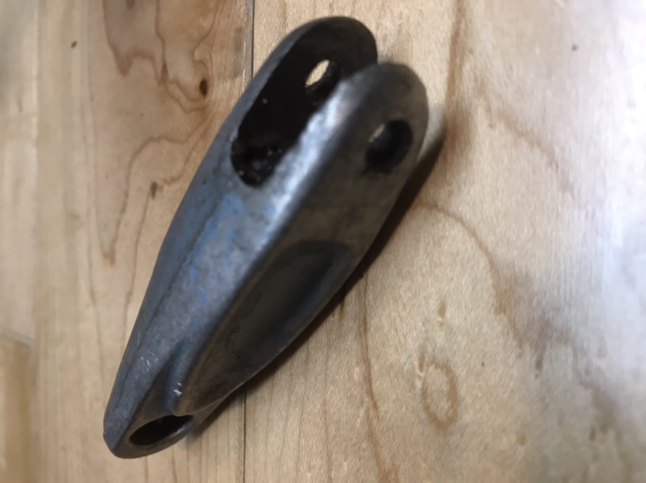

      Have an Evinrude lightwin (1950’s) and I broke off one of the transom tightening knobs . The pin that holds had degraded and broken.
      Is it any more than taking some 3-16” aluminum and peaning the ends, it seems like some x’s are stamped into the ends on originals.
      Don’t want my repair to break again;
      Thanks for any ideas

        Peaning the ends by X-marking is how they did it at the factory

          I have used a 3/16″ by 3/4″ stainless steel roll pin. I consider myself lucky when I can do that, because usually, the handle itself breaks, in my experience.

              I’ve just done what you’ve suggested – took some 3/16″ aluminum rod and peened the ends.

                Just a thought …. I think that those long aluminum rain gutter spikes are just about the right diameter… and the alum is a good hard alloy.
