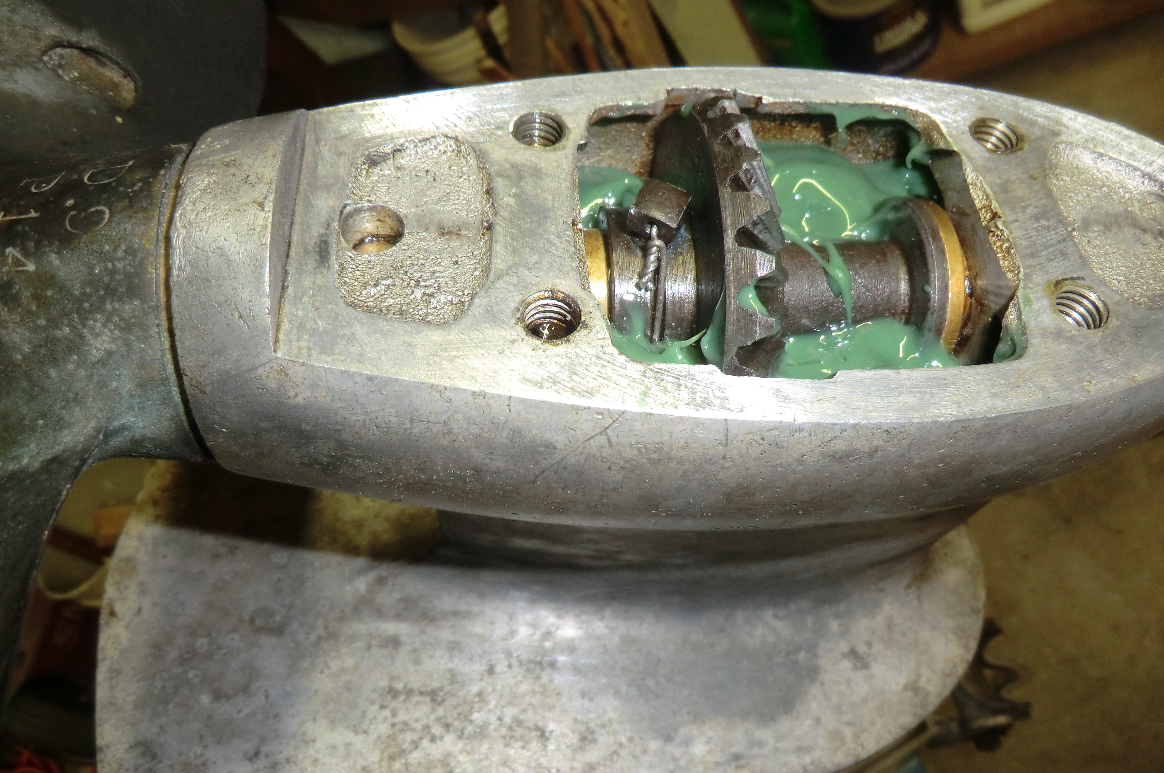

          I ended up cutting off the twisted ends off the wire and another wire from a different L/U and splicing them together plus add the loc-tite. From what I read for a different model Lockwood you fill the gear case full from the screws that holds the bottom plate of the gear casing. I know different manufacturers are specific on how much grease to add and not over fill them. Hope to get it on the lake by next weekend Woo Hoo! As always thanks for your alls help, ideals and offers.

            I just finished the mechanics on my ’29 Chief and ran it last weekend….nice motor! It will start much more easily with the exhaust cutout open.

              I installed a zerc fitting on the side of the gearcase.
