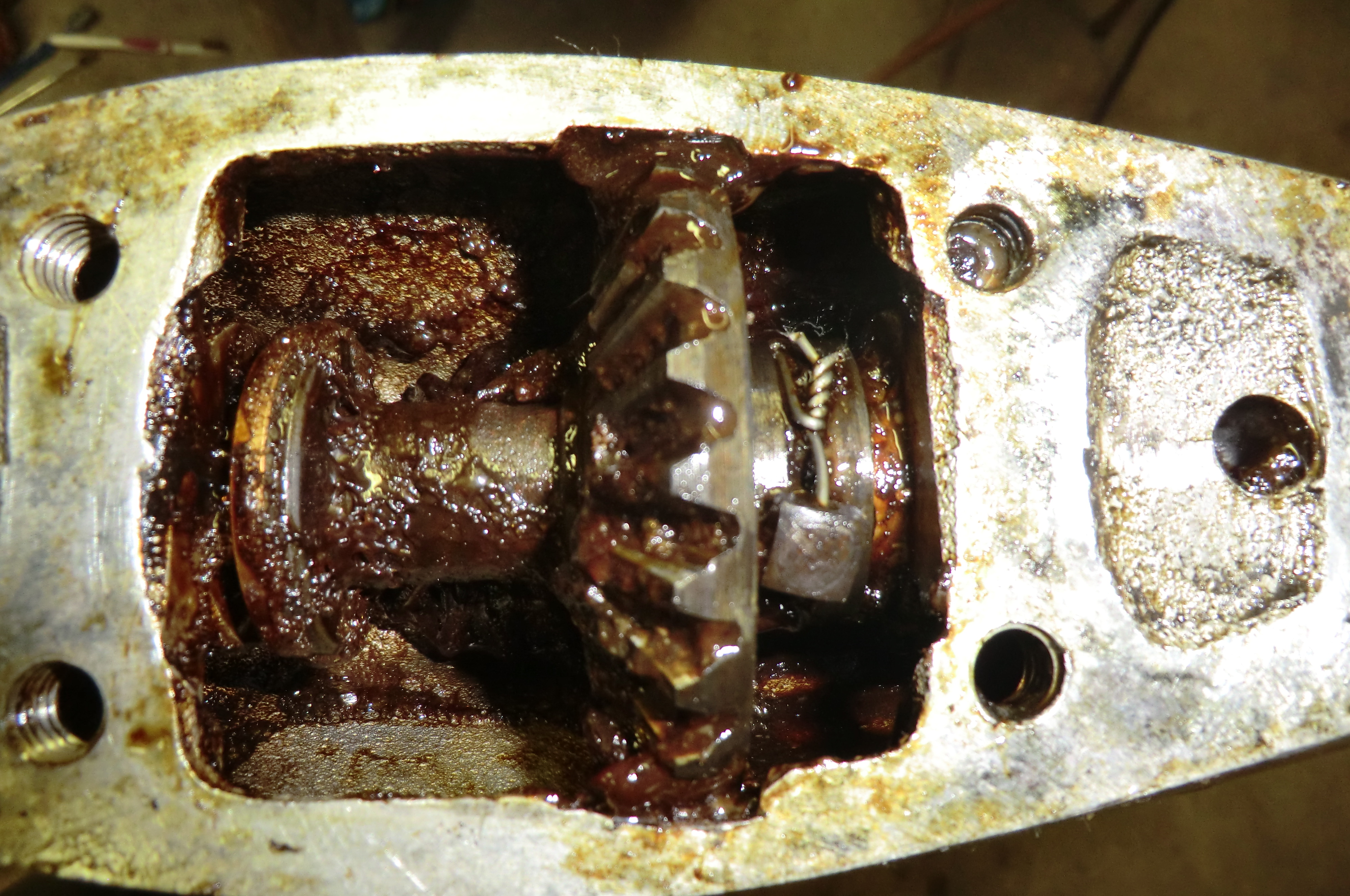

Glen,
That is lockwire, used mostly in the aviation industry today. It is usually stainless and comes in a few different gauges. I am not sure where it can be bought. I got some rolls when I bought a tool box from a retired aircraft mechanic. You might try grainger or Fastenal.Adam

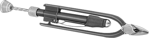

April 22, 2016 at 4:02 pm #35240Stainless safety wire is used on most critical aircraft fasteners. You should be able to get it at stores like Adam said .Special pliers are made for twisting it real tight ,guess you would call them safety wire pliers. I had never seen them before I started working on hydroplanes. I’ve thought about using safety wire on the lower unit attaching bolts ,as a friend builds racing outboards and he uses it in a few places on his motors .
Robbie RobertsonApril 22, 2016 at 5:51 pm #35243Home Depot, Can Tire, Princess Auto, those types of stores carry small rolls of stainless wire along with brass, aluminum, galvanised etc.
April 22, 2016 at 8:36 pm #35251were they really using stainless wire in the old days
with all that grease galvanized wire should last 100 years… no ?
April 22, 2016 at 9:26 pm #35260all of the safety wire I have used has been stainless I know McMaster Carr has it and the pliers that lock on to twist it. Grainger and Fastenal should have it too. Standard wire will usually break before you get it tight.
DougDoug
turned off?April 23, 2016 at 3:38 am #35286Thanks guys There’s a Fastenal near me I’ll see what they have if not I’ll order something else. I’m beginning to learn to use the right part or pay heck.
April 23, 2016 at 4:09 am #35289Clean and dry threads coated with Loc Tites Red Hi Strength Thread Locker or something similar should eliminate any need for any safety wires on a threaded part. In the old days, they only had bailing wire and good luck to keep their machinery from coming apart under load.No duct tape back then!
April 23, 2016 at 11:47 am #35298The aircraft industry safety wire is ( was ) monel . Much stronger than stainless. If you cannot find any let me know and I will send you a few feet. Marty
