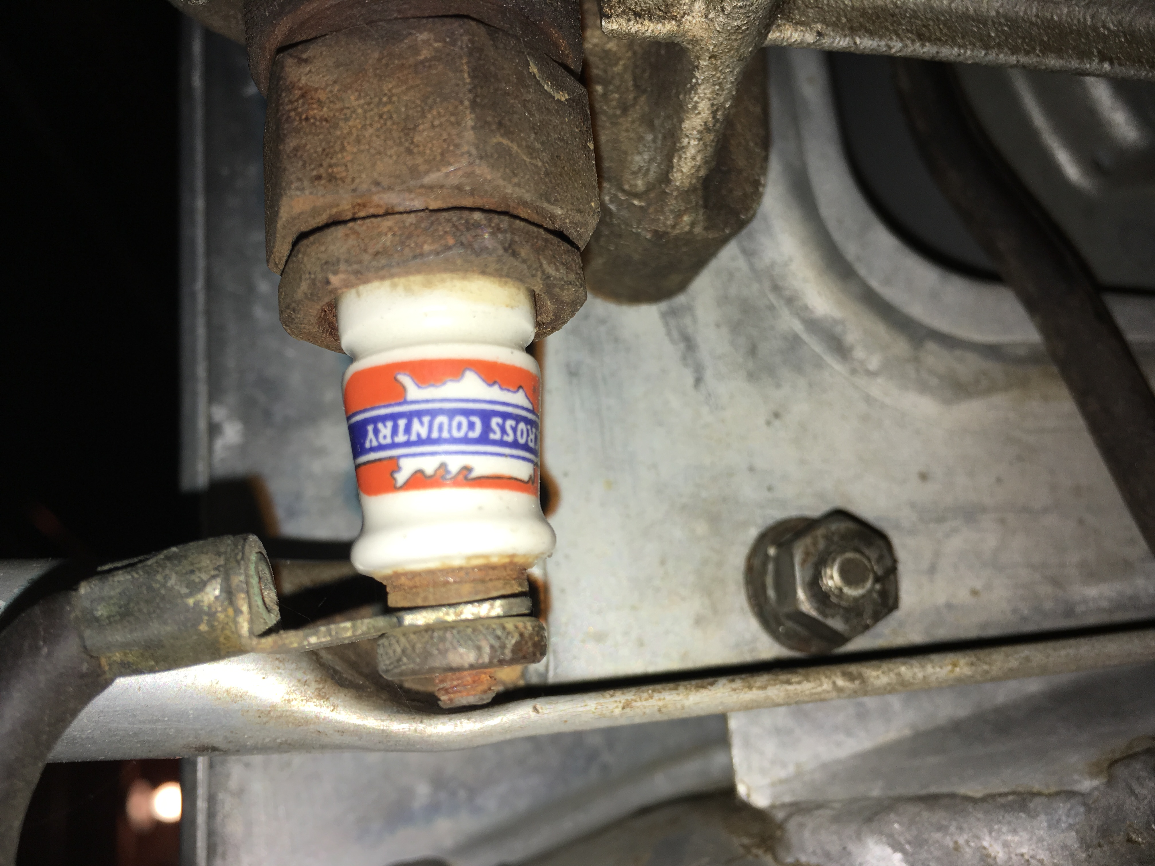

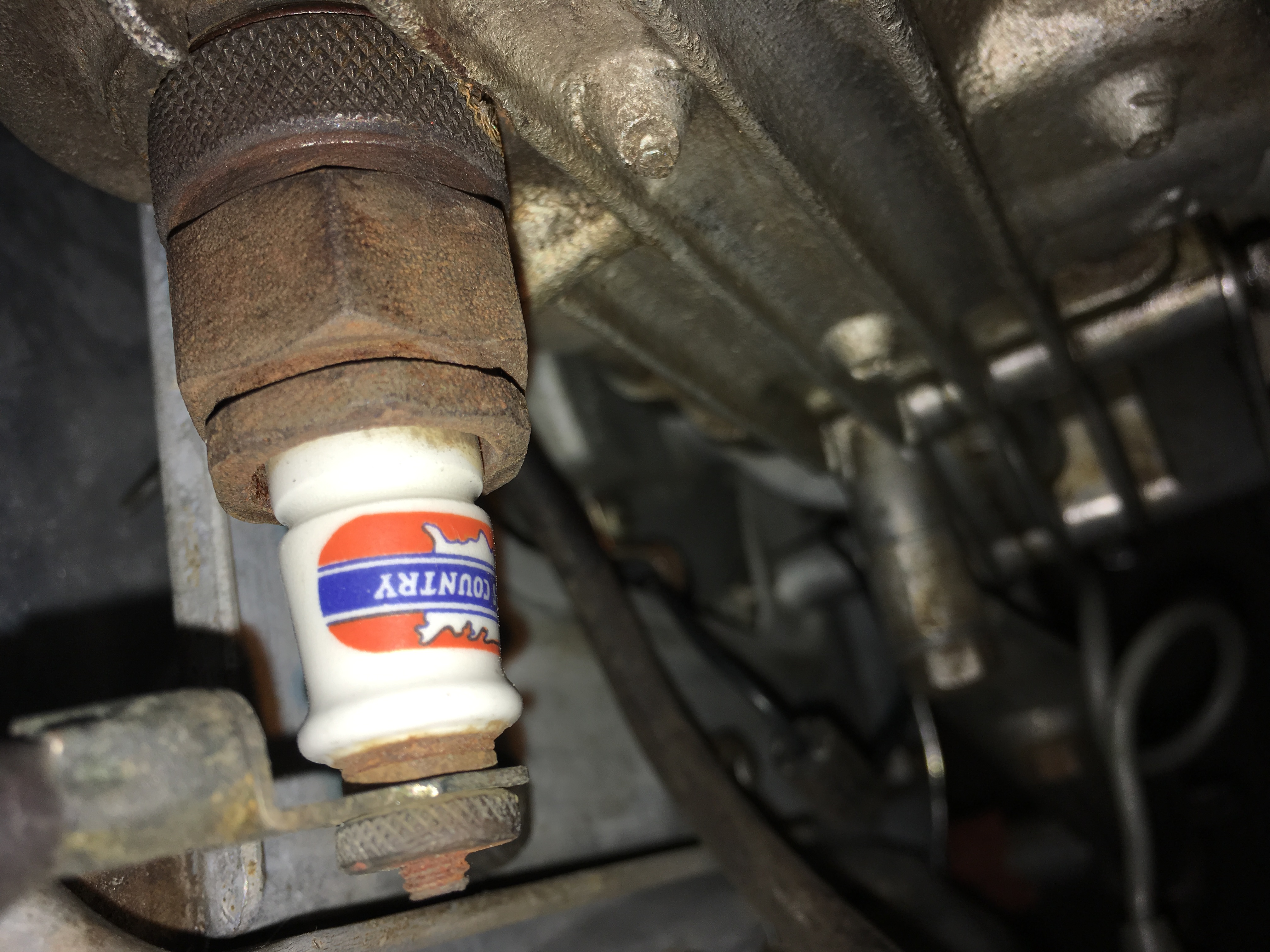

                      Just for fun, here is a picture of the spark plug in my Waterwitch.
                      #43584
                      justwannafish
                        That’s awesome! Nice patina…lol
