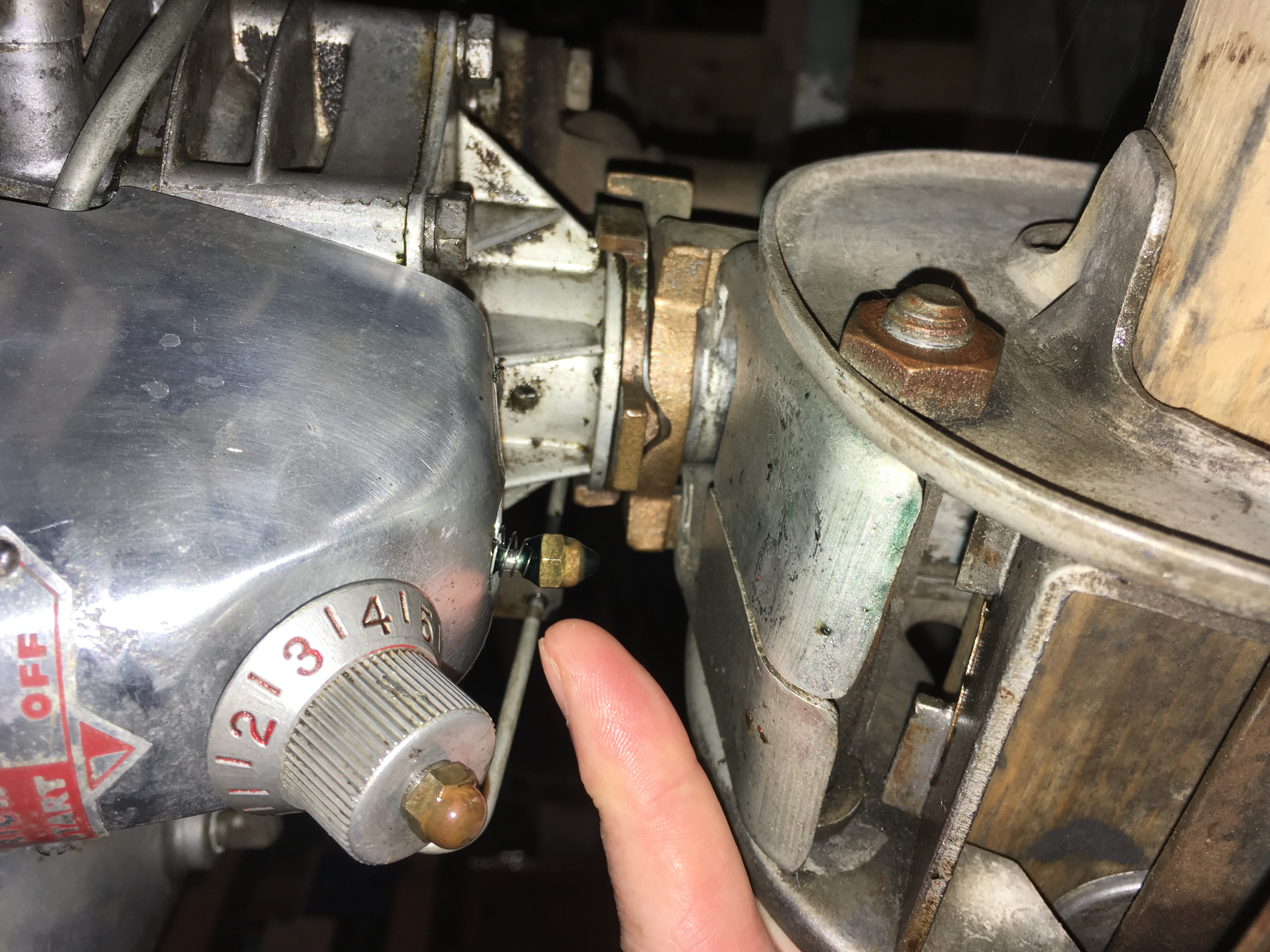

I have acquired a waterwitch 571-35 that was my grandfathers. I have good spark and getting fuel but can’t seem to get it to fire. I’ve cleaned out the carb and tank and compression is reading about 70 lbs. Would love to get it running for my boys to tinker around with on the water but can’t figure out why it won’t fire. Any ideas?

September 7, 2016 at 1:48 am #43496Thanks for the replies Ben….I’ll keep working on it. Will have to pick up an open air tester. David, not sure about poppet valves, kind if new at this. Can you explain?
