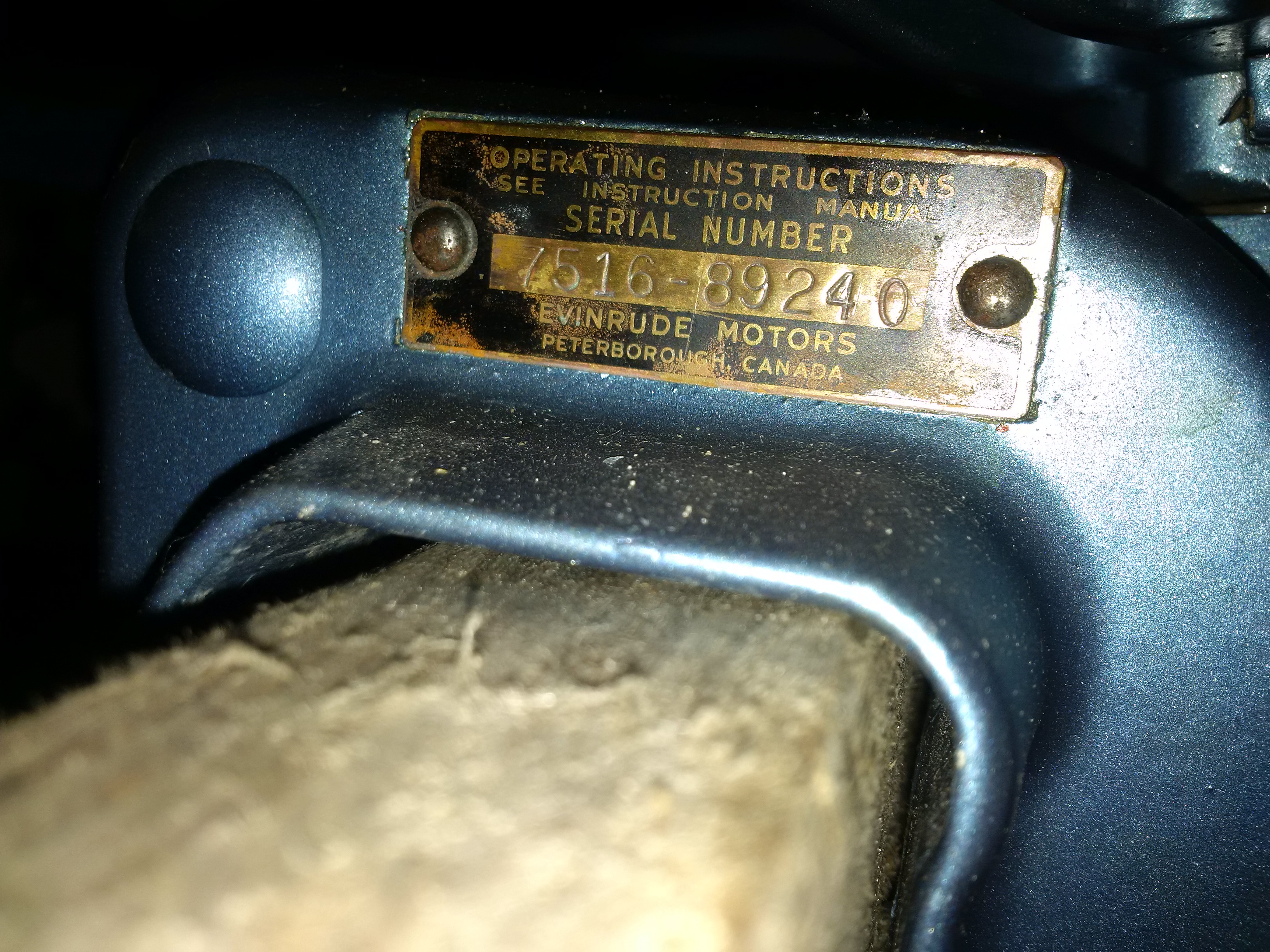

                    wedgie
                      Here’s a Canadian made 7516.
                      #45716
                        The subject motor at auction went for $19 and finally found it’s way
                        home today…… in my garage!
                        It’s a 1954 Evinrude Model 7516, serial 26442.
                        Wedgie, how does one tell if it’s made in Canada or not?
                        Mine does have the two screws holding down the starboard
                        side of the hood.
                        Will check compression tomorrow to see if I paid too much!
