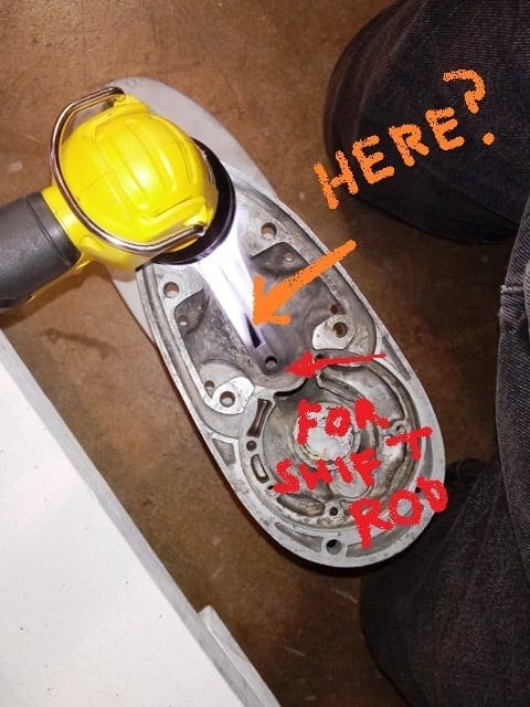

      #186278
      outboardnut
        Is the the triangler hole where I should be digging?

          #186282
            Yes that’s the cavity drain hole. I’d poke around with a stiff wire or small rod before trying a drill.

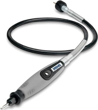

                  #186296
                  outboardnut
                    got it used a dremmel tool with extension .1/8 6 inch bit
                    dremmel
