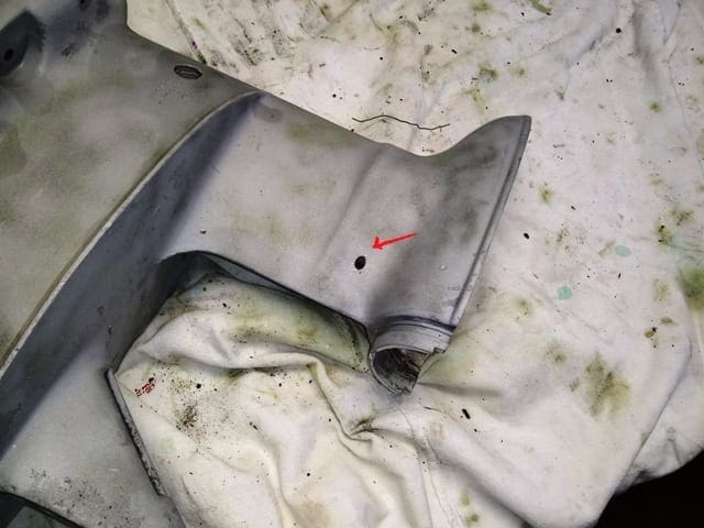

      Is it a blind hole? I stick a paper clip in there and it seems to go no where.

        water drain …most likely
        although it seems a bit large since no oil is draining it goes into the lower cavity and allows any water to drain to prevent freeze cracks
        #186223
          Drain hole. Look into the top and you will see the cavity. Very often plugged up with sand & debris

          outboardnut

            #186245

              #186246
              outboardnut
                How big is the hole on top?

                #186247
                  I used a stiff wire in my drill (like a welding rod, if that’s long enough) with
                  the end pounded flat like a screw driver so it would cut thru
                  the “rock like” sand / mud.
                  #186248
                    yes it is especially if you get a freeze in the winter.
                    use a long thin screw driver and hammer or long drill to get it loose. be care full with the drill and measure as you go for depth.
                    #186254
                      just drop the LU and clean out the crud with a pressure washer or piece of stiff wire and a hose.
                      I cleaned up a small 4hp Merc last year and you would never think so much sand and crud piles up down the LU
                      make certain you see light at the bottom of the LU when looking down in it while using a flashlight outside the drip hole

                      outboardnut
                        How wide is the hole on top?
