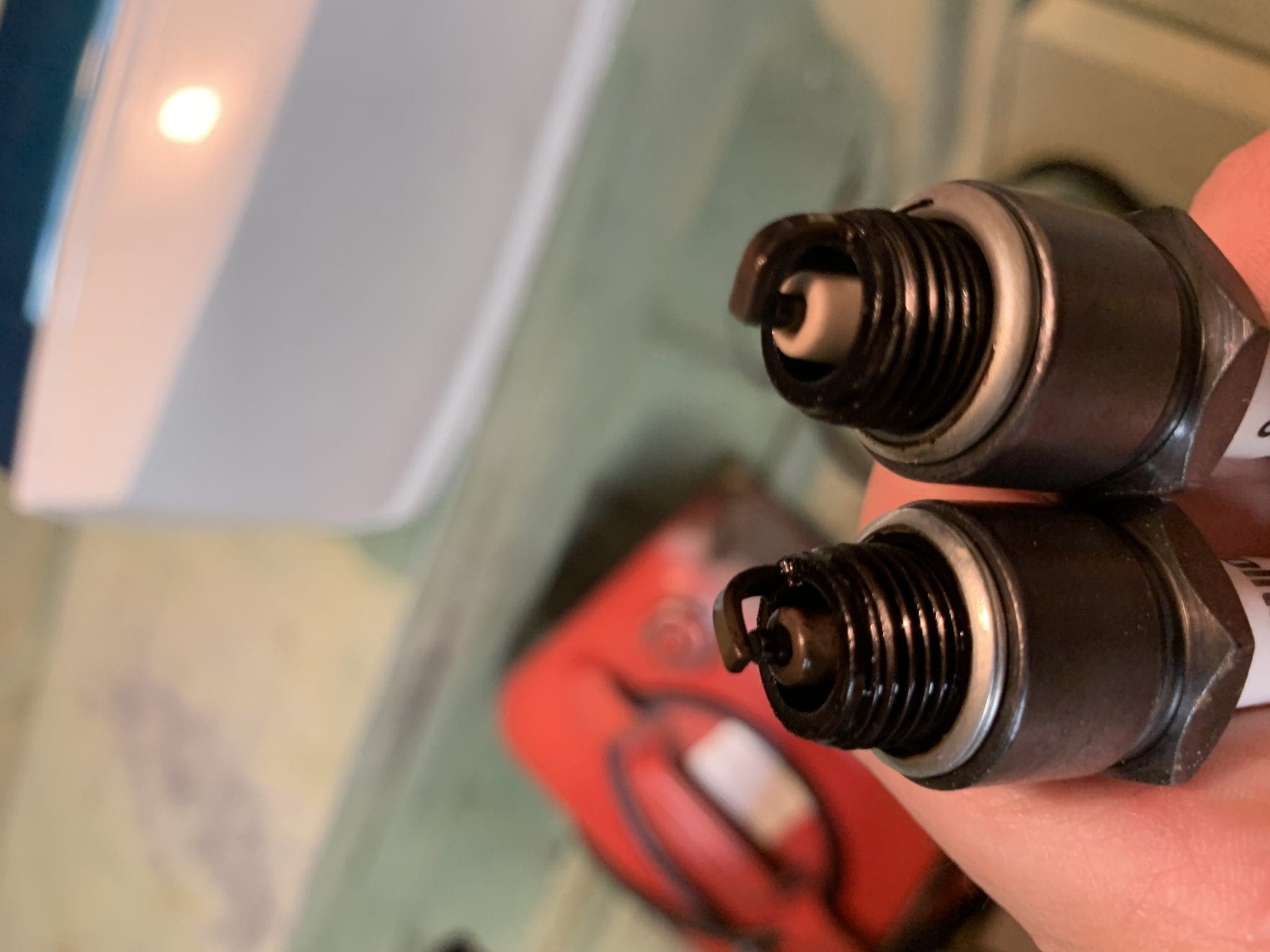

15 hp sears/ted Williams 15hp w/ tecumseh engine.
Been battling this motor for a while. New stator, super clean carb, new plugs, new impeller, new fuel pump.
I changed plugs again today because I’m trying to get rid of a sneeze at wide open throttle. It doesn’t sneeze at low rpms.
I take the boat out for a couple hours of fishing and it seems to be running good for the 2 minutes it takes me to get to my first spot. Fish for 2-3 hours and I head to next spot. At wot, it sneezed 6-7 times in quick succession and seemed to bog down. *this is new*
I turn and head back to the dock. Plane out at wot and it’s ok for about 1 minute and it slowly starts losing power. I have to idle for a couple seconds and then I can go wot again. This happened 2-3 times.April 11, 2019 at 11:36 pm #173134The top plug looks like it’s not getting enough fuel – the other, too much. A blown head gasket would show up with a compression check. I cat’t say much more as I am not familiar with that motor . . .

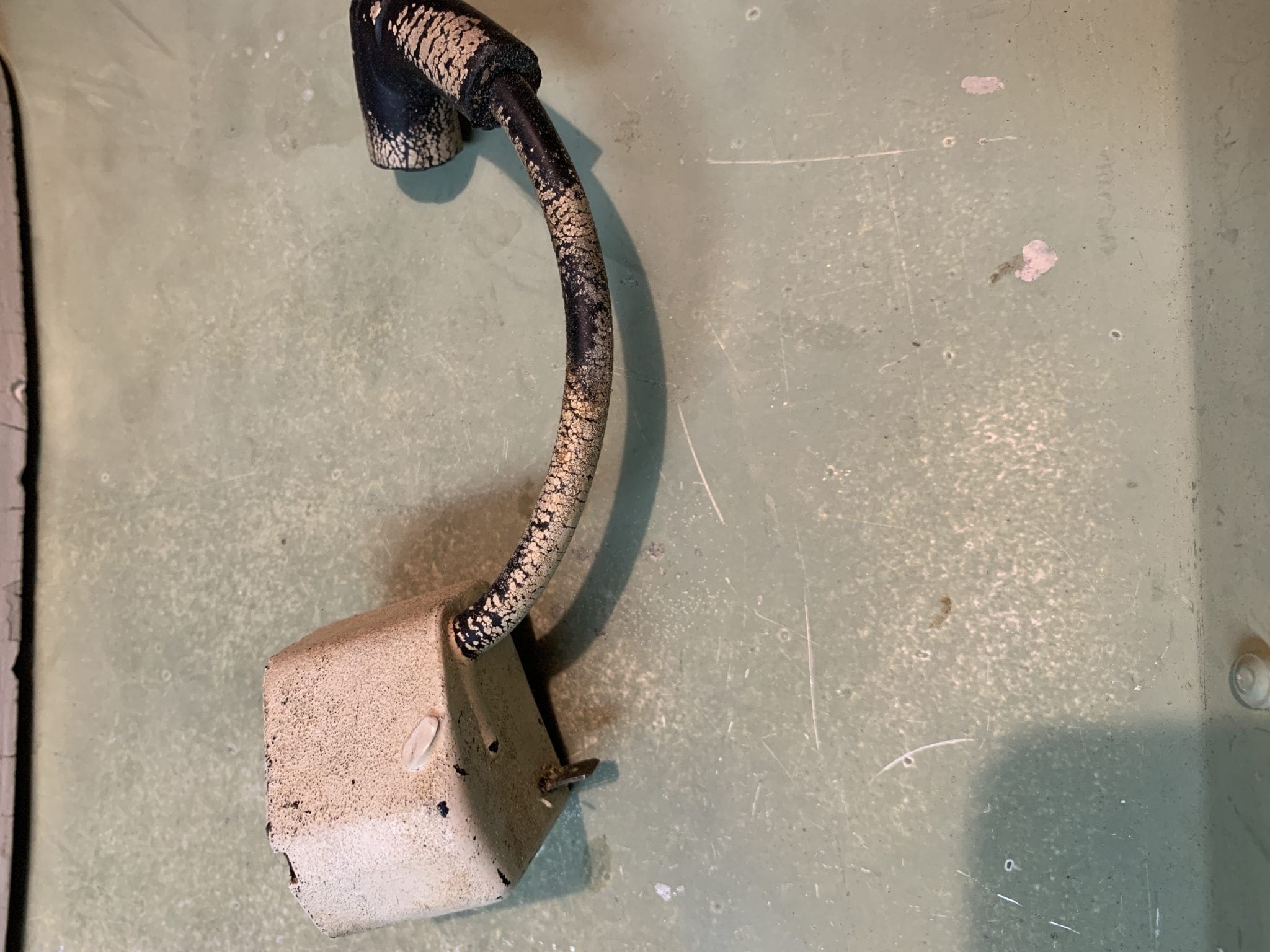

April 12, 2019 at 6:00 am #173157Top plug looks like it might be loosing spark and getting WASHED with fuel it can’t burn. That’s my guess, anyway. You say you have replaced the stator. I am not familiar with this particular motor, either. Does it have separate ignition coils? Can you swap them and see if the problem plug changes to the bottom one? I would also check for overheat, like Mumbles said, just to be safe. When you say “looses power,” ignition would be rather instantaneous or on-off in nature; whereas overheat would be a gradual drop off.

I have tried pulling the wire out of the coil to replace them (just because) and have had no luck. I can’t find any information on these to know for sure that this part is replaceable without replacing entire coil. As far as the connector, it’s a quick connect style. The same style you have you hose to your air compressor. When I got the motor it had a Walbro style plastic external pump that was leaking so I replaced it with another one. They are all lawn mower pumps if I’m not mistaken.Billw:

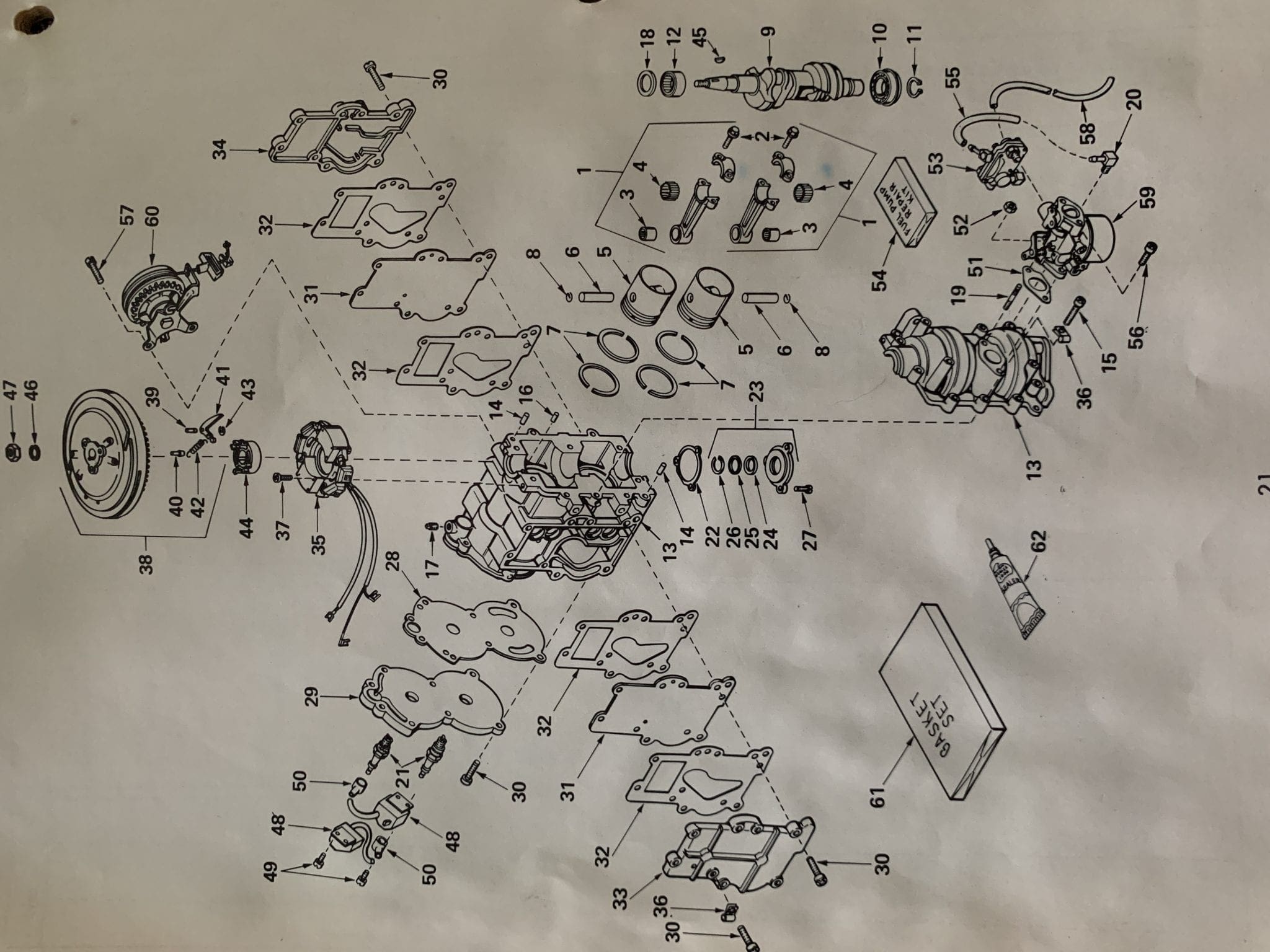

I will try and swap the coils and check my impeller. It’s peeing water fairly well so I don’t know how it could overheat while having circulation.April 12, 2019 at 8:55 am #173161Here is a pic of the coil and the engine diagram from my manual.
