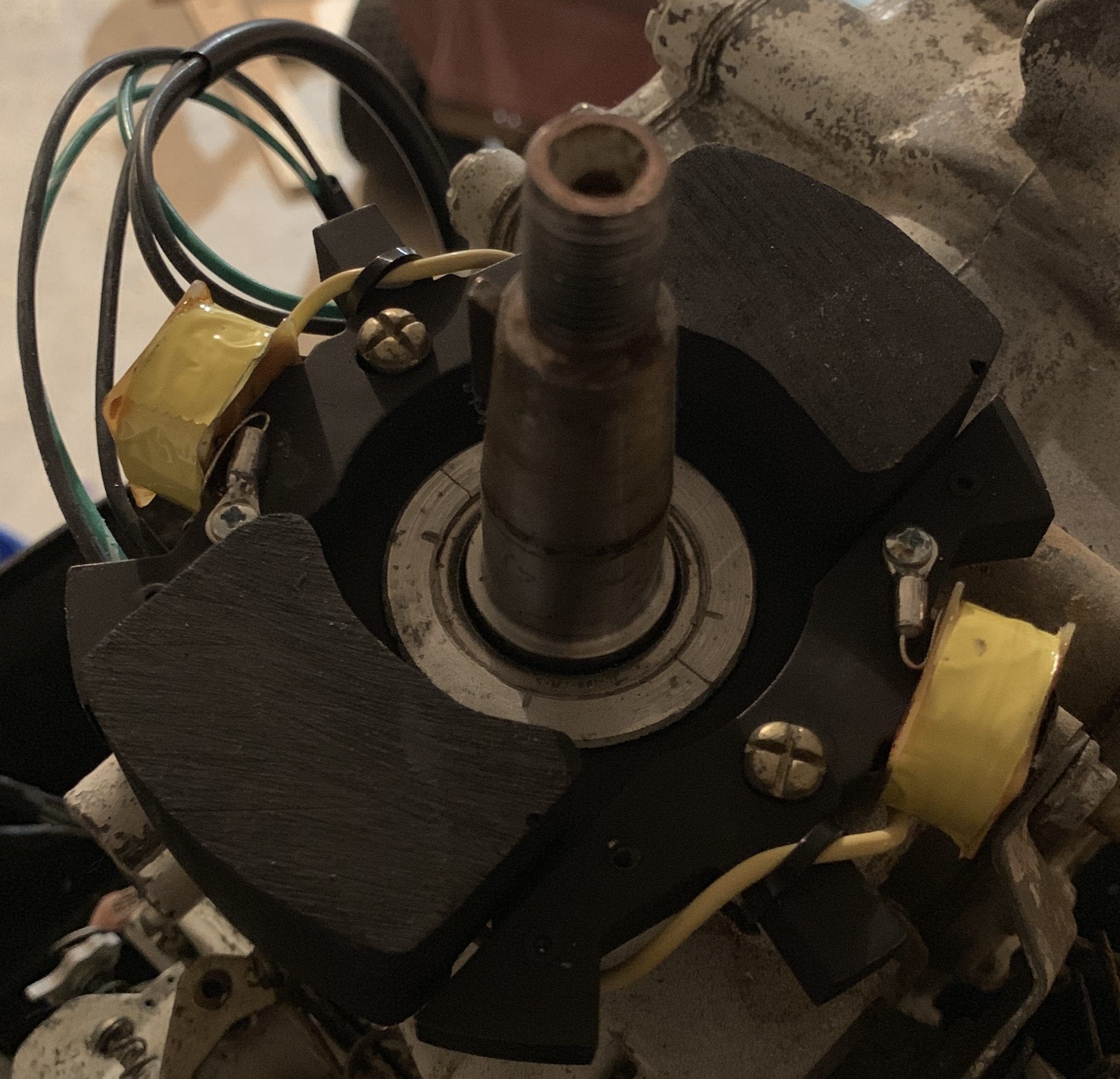

    john8504
      Pic of the new stator

      john8504
        Checked spark on my coils. I backed it out 3/4” and I still have great spark. Bottom cylinder not burning off correctly. I would think that if the halves of the case were worn then both cylinders would be bad.

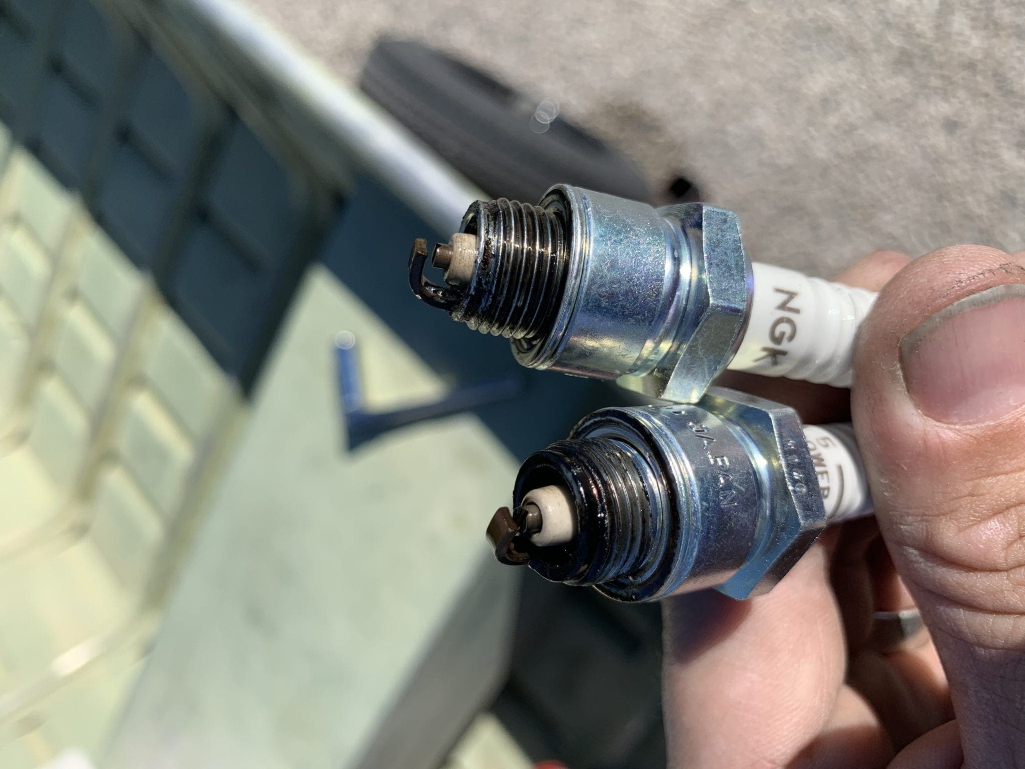

          john8504
            Found my problem. It was the type of plug. Switched to some Ngk racing plugs and runs like a champ!!

            #173395
              What did I tell you! 👍
              I’m not sure what you mean by ‘racing’ plugs but I feel off the shelf NGK plugs are superior to anything currently on the market. Others may think different but I’m convinced.
              #173412
              john8504
                Yeah good call on that. I had several people convinced it was as in the electrical. Funny thing is that the other plug would jump 3/4 inch on spark testet
                #173415
                  Well, it WAS an electrical issue….just one that was so obvious that I forgot about it!!! Good call! A true “duh” moment, on my part! However, I do have to say that I have seen plenty of dead holes on Yamahas, caused by NGKs that were less than a year old. I am not arguing against them; but they, too, have their moments.
                  #173435
                    When purchasing NGK’s, they have to come from a reliable source to be genuine. Like most everything else, there are poor quality fakes out there which look convincing and are being sold online at places such s Epay so it is buyer beware. Doing a Google search for fake plugs will help to identify the phonies.
                    • This reply was modified 6 years, 9 months ago by Mumbles.
                    #173466
                      I hope ours aren’t fakes. We buy them from a local wholesaler by the hundreds, probably thousands, come to think of it.
                      #173510
                      john8504
                        I got mine from the auto parts store. I’m fairly sure mine are fine. I run a auto repair shop, I deal with ngk plugs on a daily basis.
