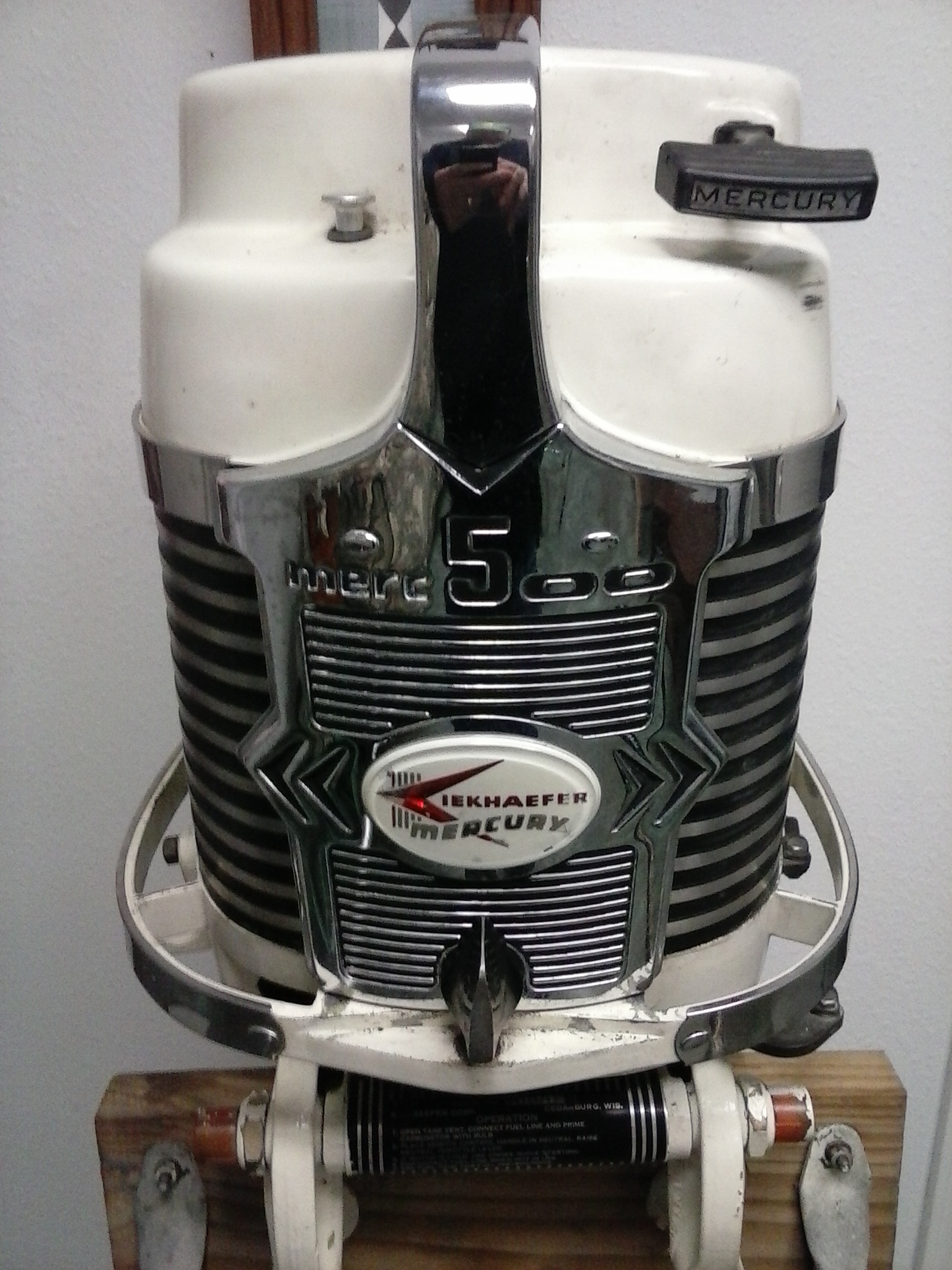

      One thing I would do before buying any of those, is do a compression test. While the Big twin [Javelin] is a great motor, it could have been overheated and scored a cylinder. Same goes for the Mercs. It’s hard to beat any of the 30, 35, or 40 OMC engines. Parts are easy to come by and many parts are still readily available new. As Steve said, the inline Mercs are great runners too, especially the inline 4 cylinders. If you want speed, the Mercury motors will deliver. When properly tuned and set up, they are excellent running engines. Here is my 1961 Merc 500. I like it so much, it stays with me in the office at work!

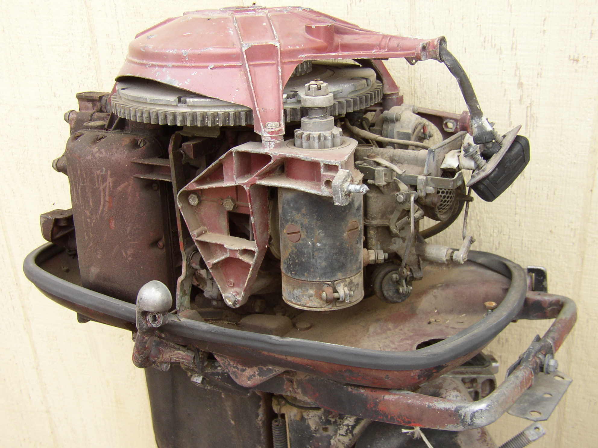

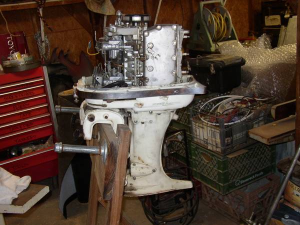

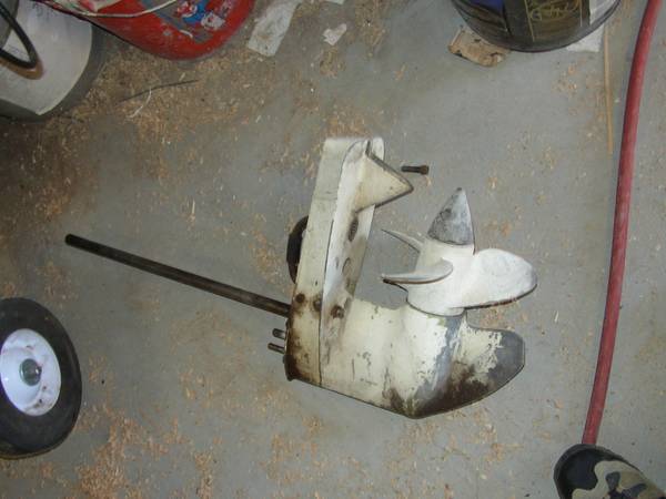

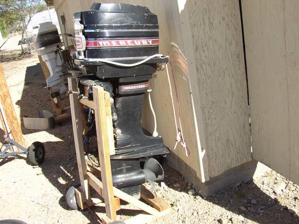

                      Wow! Thanks everyone for all the insights and advice. The following is the text from the owners advertisement plus a few more pic’s. I am not interested in the 650, but thought someone out there might.
                      1956-58 Mk 55 Thunderbolt 40 hp, manual start only. Ser. 1096388.
                      1956-7? Johnson Javelin 35 hp. With controls and cool steering wheel.
                      1968 Merc 650, 65 hp. Ser. 2349336. Bought from a guy who had it stored in his living room and said it ran like a beast but who knows. I bet that it did so I bought it.
                      1961 Merc 500, elec and manual. Ser. 1555147.
                      1960-61 Mk 58A, elec and manual. Rebuilt carbs, transom clamp, Mag gone through and checked out. New recoil spring but needs tinkering, needs a couple of wires replaced or taped up, has lower end.

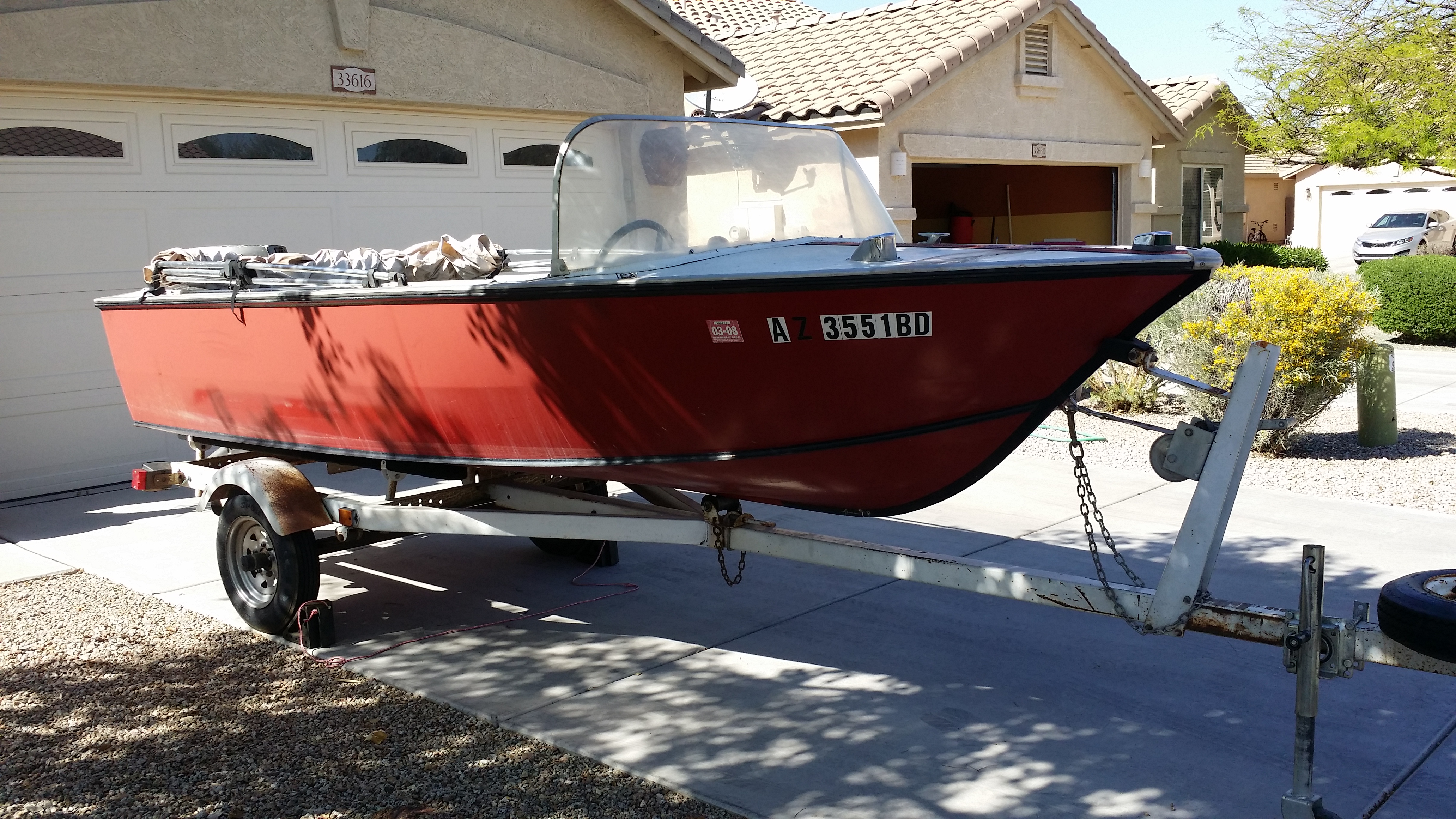

                        I also thought the Javelin might be the way to go, even with it looking the roughest of the bunch and being a long shaft that could be converted back. But, if as opposedtwin noticed that it is actually a 30 hp 1956, I do not think it would be enough motor for me. My boat is set up for short shaft.
                        The plan for the boat ( Crestliner Sea Scout ) is to return it to something that looks fairly period, but with my own spin. It will be for weekend exploring/cruising in area lakes with friends and family. Maybe tow a tube here and there with the grandkids when they are a little older.
