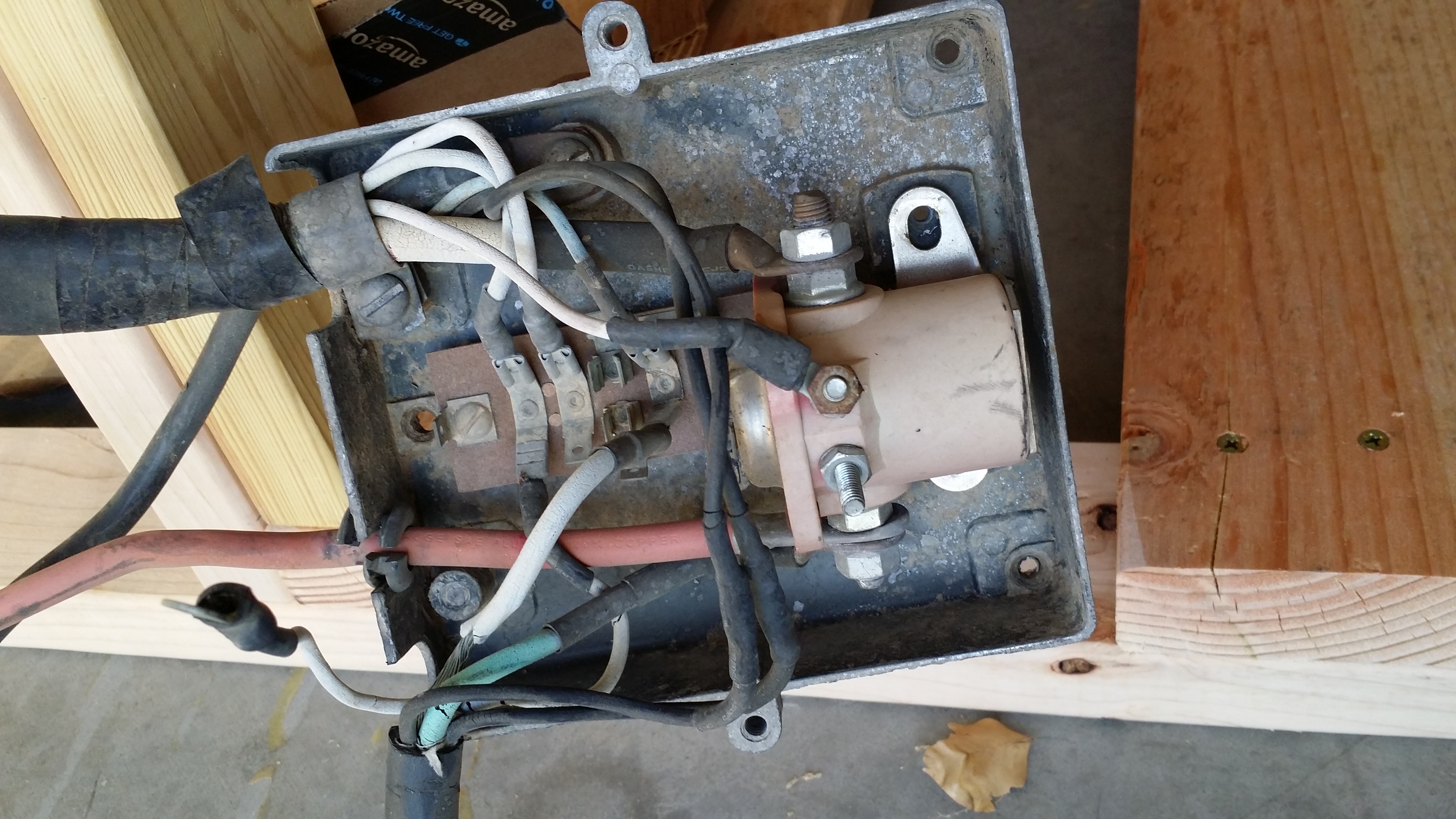

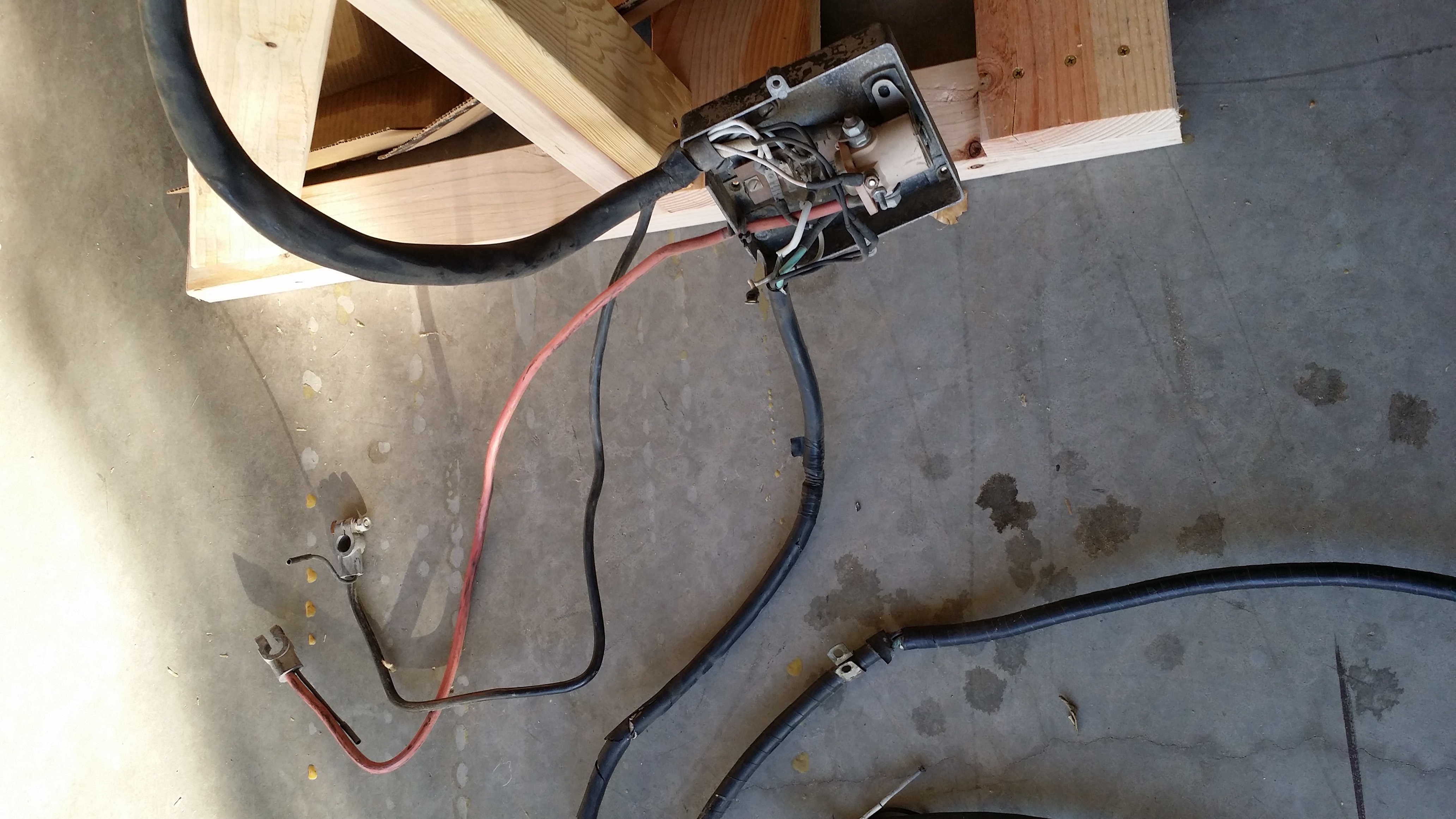

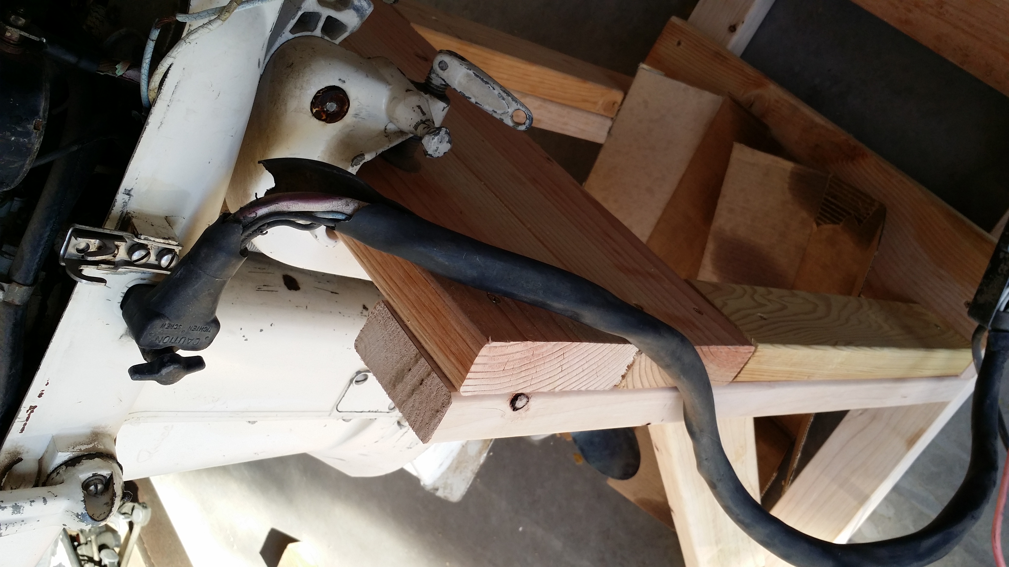

      Pic’s of the harness.

              Have you had any luck finding a place to source a wiring harness. The plugs on mine are just okay and the wiring itself is way past it.

                If you don’t want to rewire it yourself …
                http://www.nymarine.ca/wiringharness.htm

                  Thank you for the post Garry. Will see if I can find a local electrical supply that can help me put together what I will need.
