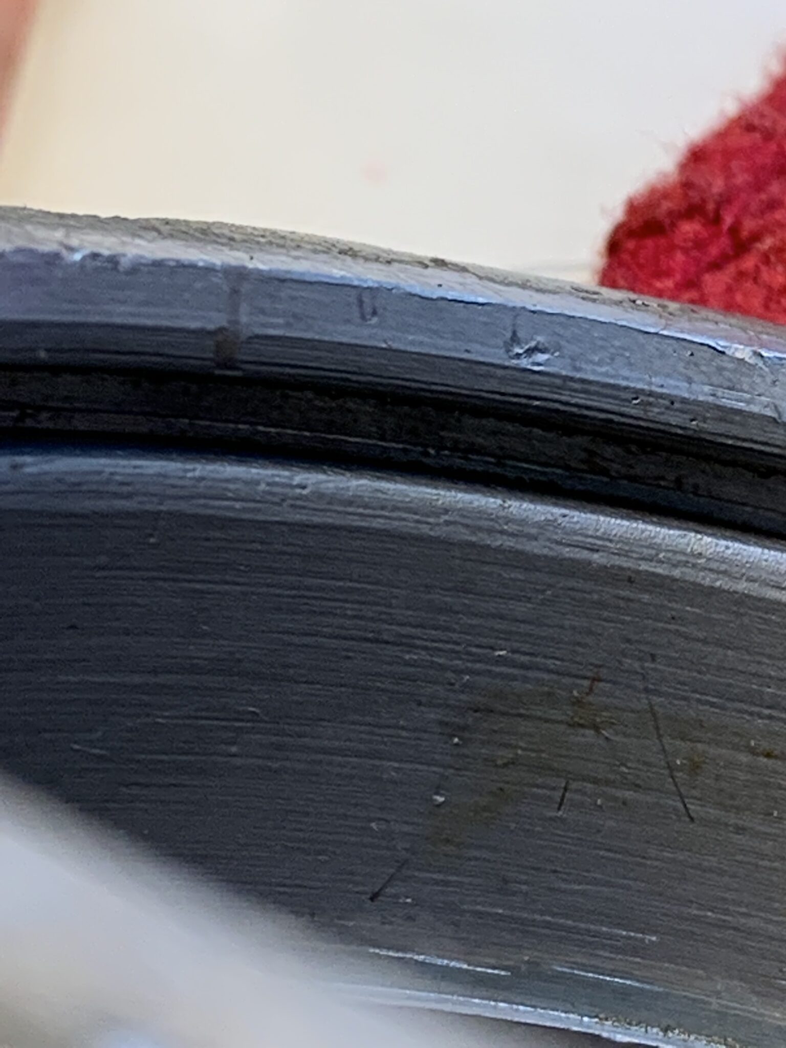

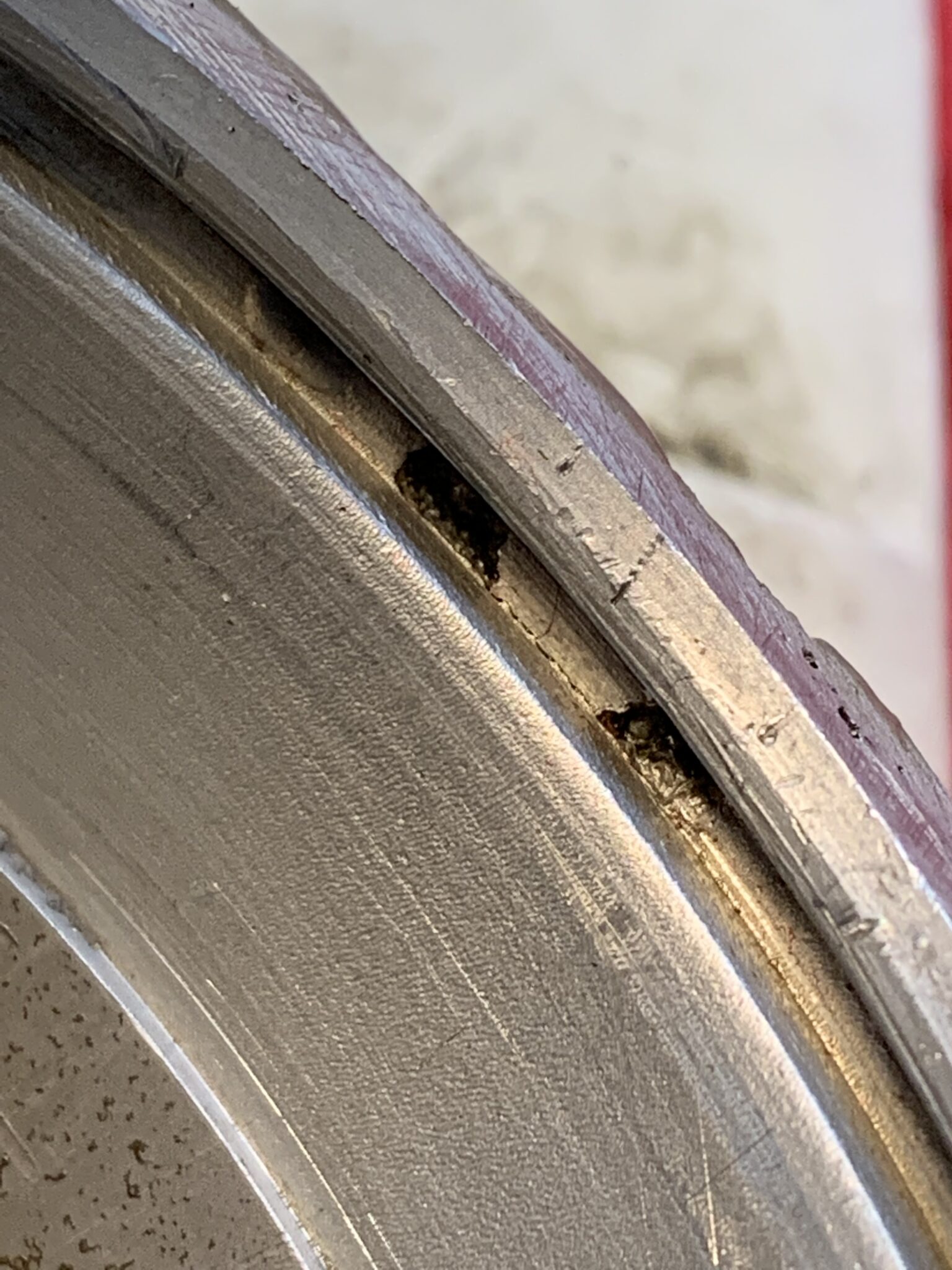

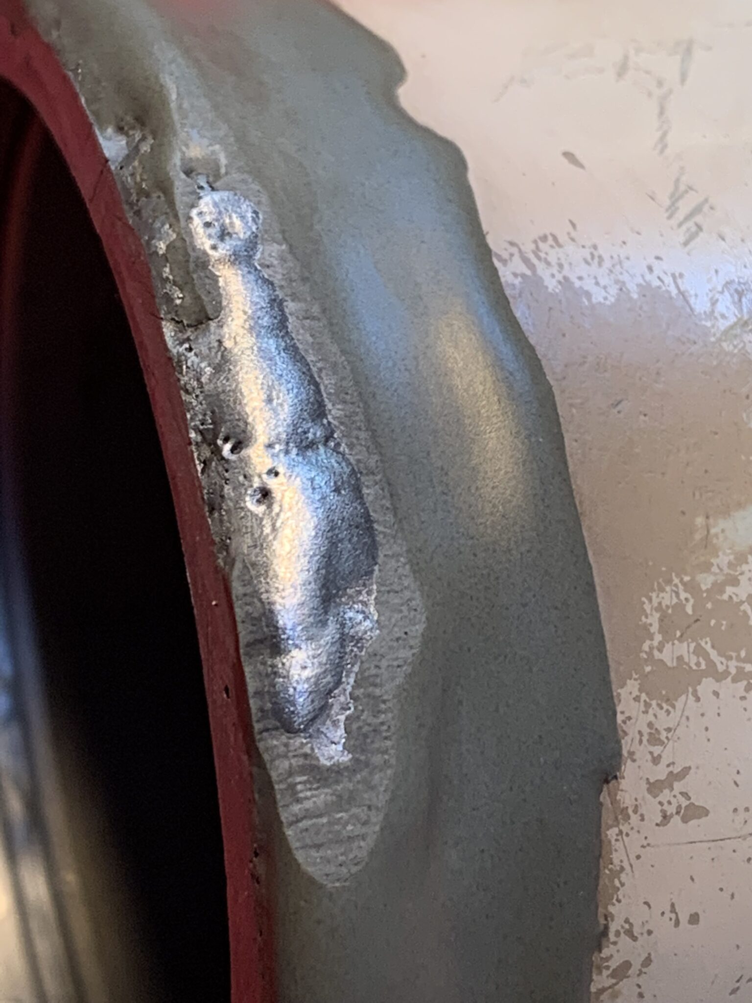

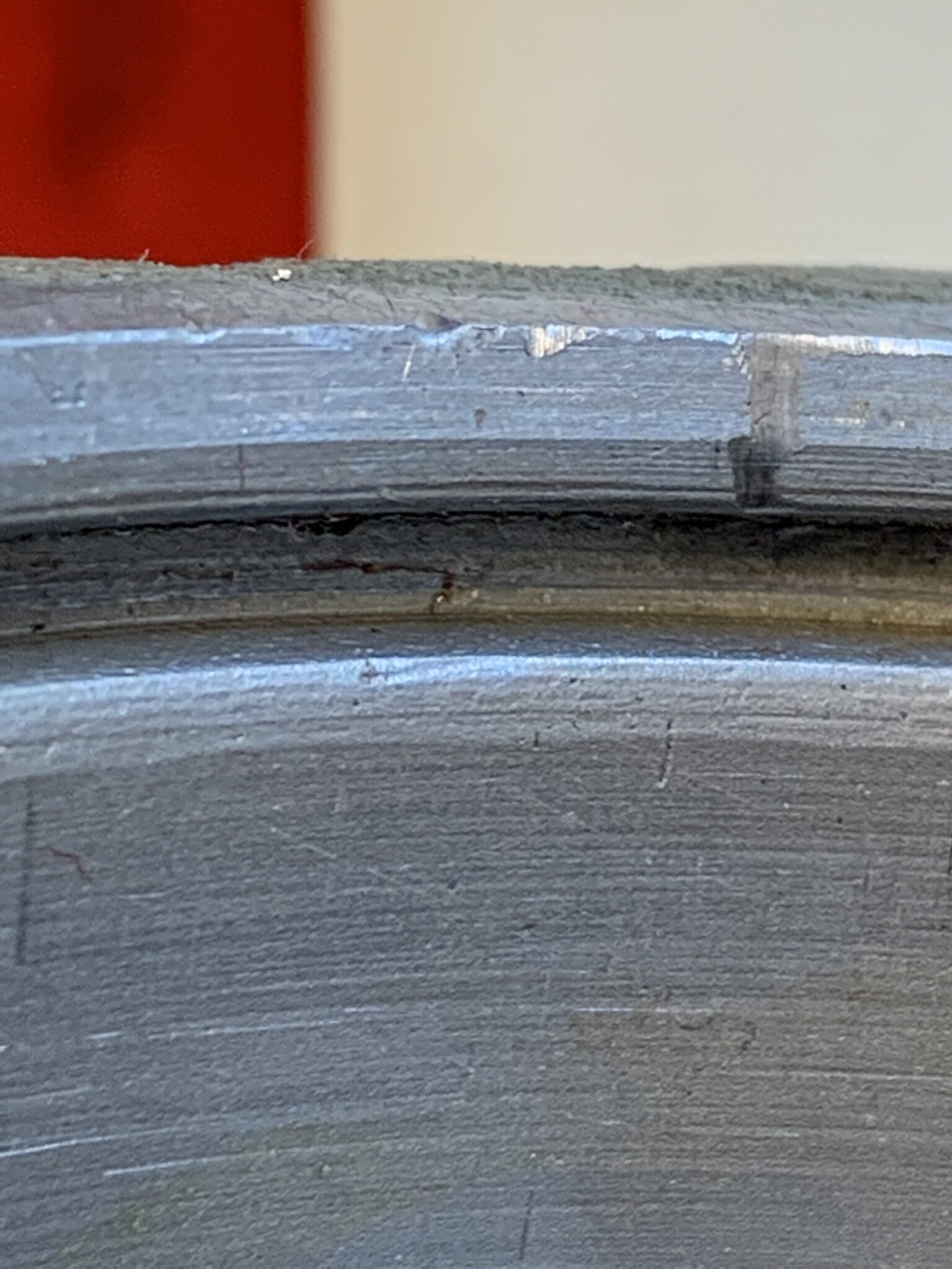

Well , I dug into my gear case a little deeper. I ground down the JB Weld and found mine was welded just like the one outbdnut2 has. The weld ring is right outside where the snap ring groove is that holds everything in the gear case. So I looked in the groove with my naked eye and all I saw was 2 eroded spots. Then when I put the camera on it and jacked up the vision, It looks there are some hair line cracks in the groove. That groove looks big enough where it might retain enough water and freeze and put the cracks in. I also wonder seeing both our gear cases are welded the same way that it wasn’t a factory recommended warranty fix. Moving forward, Matt.

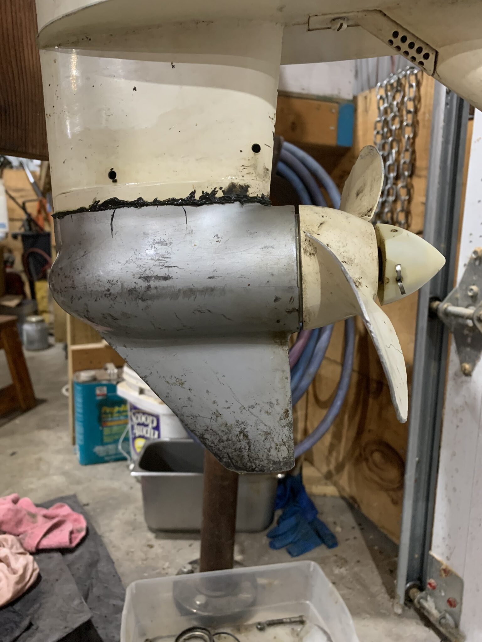

August 26, 2021 at 7:31 pm #245518Went to the dry swap meet at Vail Mills,New York sponsored by The Mohawk Hudson chapter last weekend. There I found a donor motor. A 1966 Montgomery Ward 6 hp. 1966.
It had a good gear housing … No cracks. On the donor motor, the motor was all white except the gear housing. It was silver. so I’m thinking it too was replaced at one time.
So…took it off, cleaned it all up and put it on my 5 hp. Bolted right on. There is a little difference between the two on the outside but everything lined right up. Same gasket. On the replacement there is a groove that looks there should be an o-ring or some sort of spaghetti seal. There wasn’t one. However, there is plenty of permatex.
I guess on that design, The groove where the retaining ring snaps in to hold everything in place is the weak point. A little water in the groove with some cold weather is just enough to pop it.

65 20hp Chrysler and a67 6hp Sea King. Both have the silver lower end.August 26, 2021 at 10:04 pm #245540I have 4 or 5 of the West Bend/Chrysler 5hp Viking/Sea King. All of them have immaculate powerheads… I believe they’re pristine because the lower unit rear propshaft popped and that was the end of the motor.
The motors I have that don’t have epoxy are missing chunks of the gearcase where the c-clip resides. I used to think it was a freeze problem, but after looking at a dozen units in the process of falling apart, but I believe the cause is repeated high-rpm shifting causes the aluminum case to fatigue and eventually pop off the lower unit along with the bearing carrier, gears and all the other oily bits.. If you have any of the metal left that can be used as a template to use aluminum weld to build out the missing spots, maybe you can find a way to hold the rear carrier some other way or have someone machine what gets built up using the aluminum rod.
A word to anyone with a 64-66 5/6/9.6, inspect the gearcase near the rear carrier and weld up any cracks now before it’s too late.
