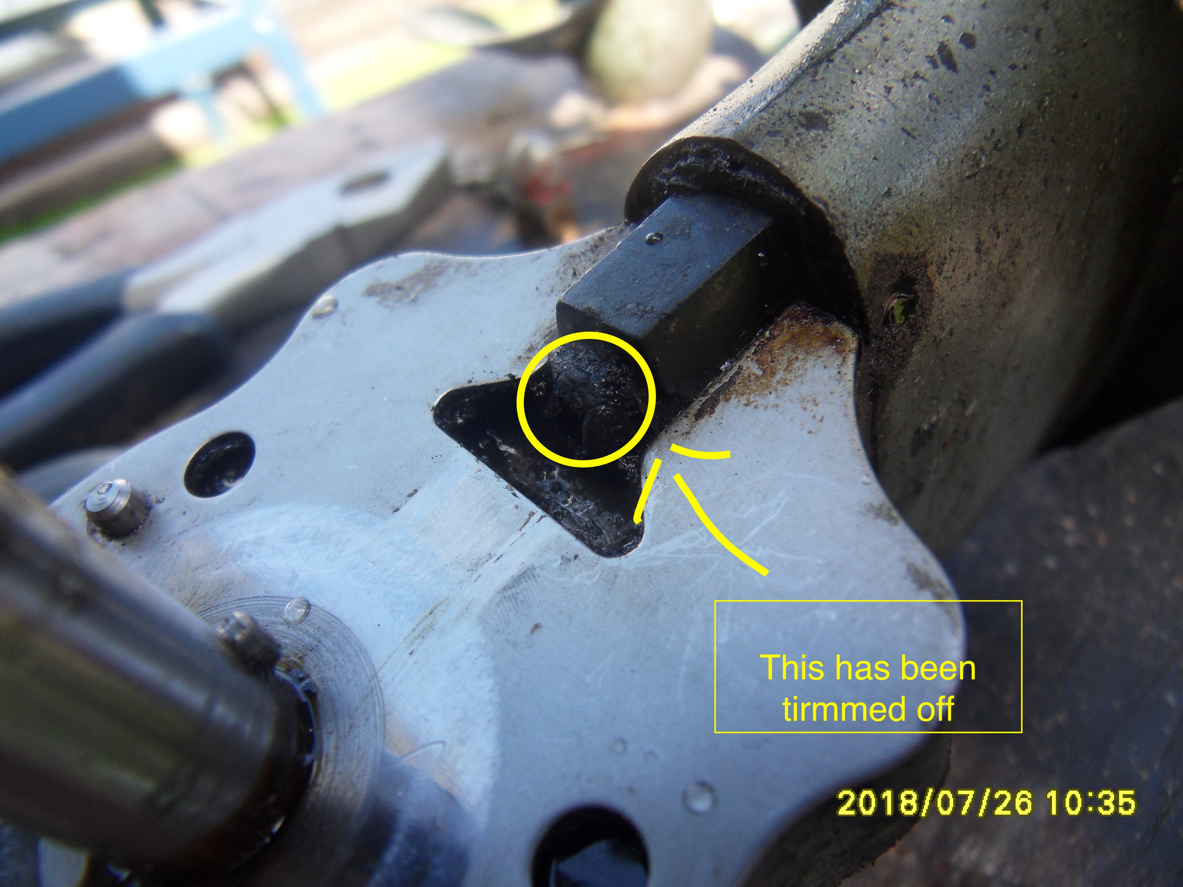

My grommet has been trimmed shorter because it was mucked up. But it has a hole that size right up into the Copper/Brass Coloured water tube. I have taken the flush plug out and while its running it will dribble water. When I has the bottom end and head off of it i was able to blow through the flush hole and had air come out the bottom end at the grommet. Anywhere else i should feel air from? All passages seem clear and I have been able to pass air and a wire through them.
I suppose all this could possibly be because the grommet is now slightly shorter. I don’t suppose they are readily available?

Ok, so if everything is right with the pump, grommet, elliptical/pin, water pump housing, and water tube, the motor should spurt water out of the flush plug for several feet. That should happen regardless of any possible blockage in the powerhead or exhaust cover. The flush plug is the "first stop" for incoming water.
After having problems in the past, with the water tube grommets swelling up and blocking cooling water, I now make it a practice to always change the grommet when changing the waterpump on HD and TD models. After all, the old grommet is also around 70 years old. A new grommet will remain open, and also seal better within the channel that it sits in. It makes a big difference. The part number is 300582. http://www.marineengine.com/newparts/pa … OMC0300582
