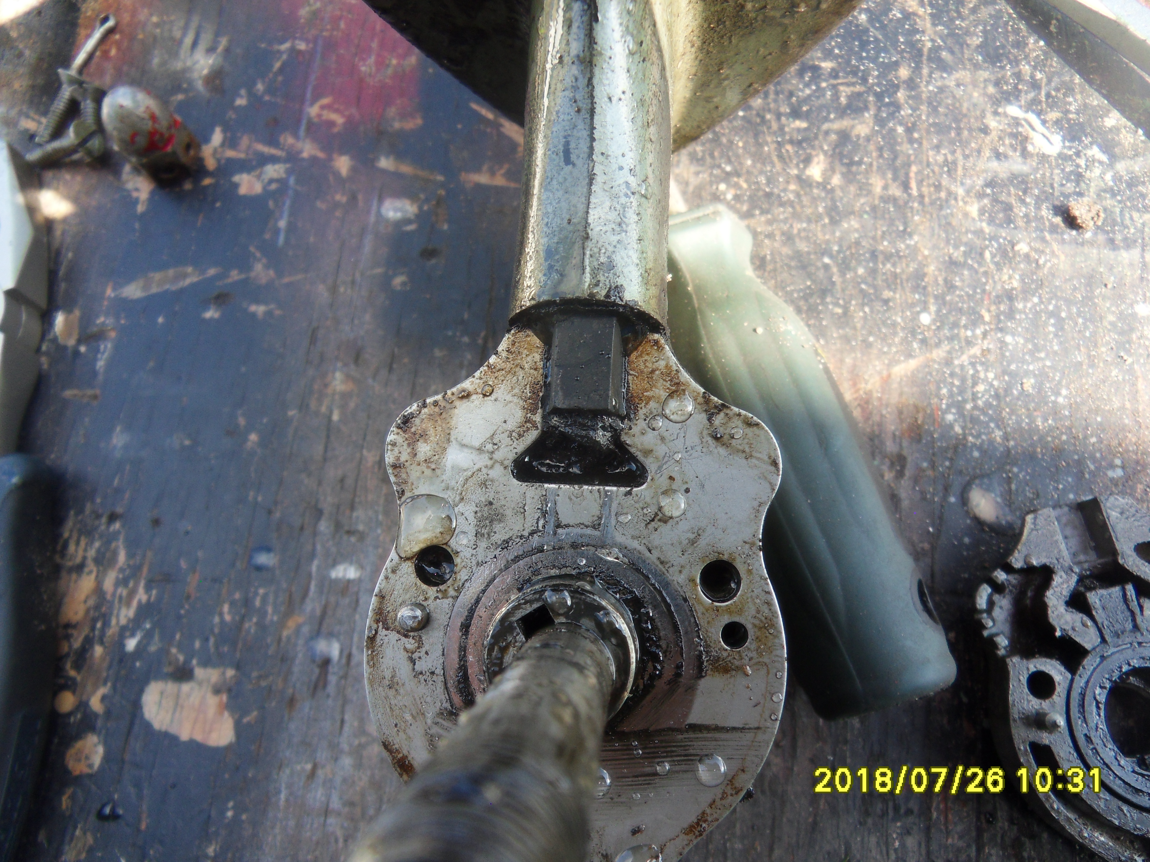

        I would pull the exhaust housing and check for a plugged water passage. Is there charred paint on the motor?
        There is a small grommet that the water tube seats into at the lower unit above the water pump. I have seen them close up and seriously restrict water flow. It should be open to a 1/4 inch or so. If it’s closed up even slightly it can cause issues.

        #81377
        shane-r13
          I’ve done all of that as stated in my first post. No charred paint. Ive removed the exhaust/carb housing go service the carb but didn’t pay particular attention to the water passages. I’ll have to pull it off again. As for the grommmet I don’t see one. There was a rubber piece that came from the water tube that was all buggered up, I trimmed a bit and can see the tube so it’s not blocked by anything.
          #81378
          shane-r13
            I’ve trimmed the rough looking iece at the bottom of the water tube slightly to clean it
            Up.

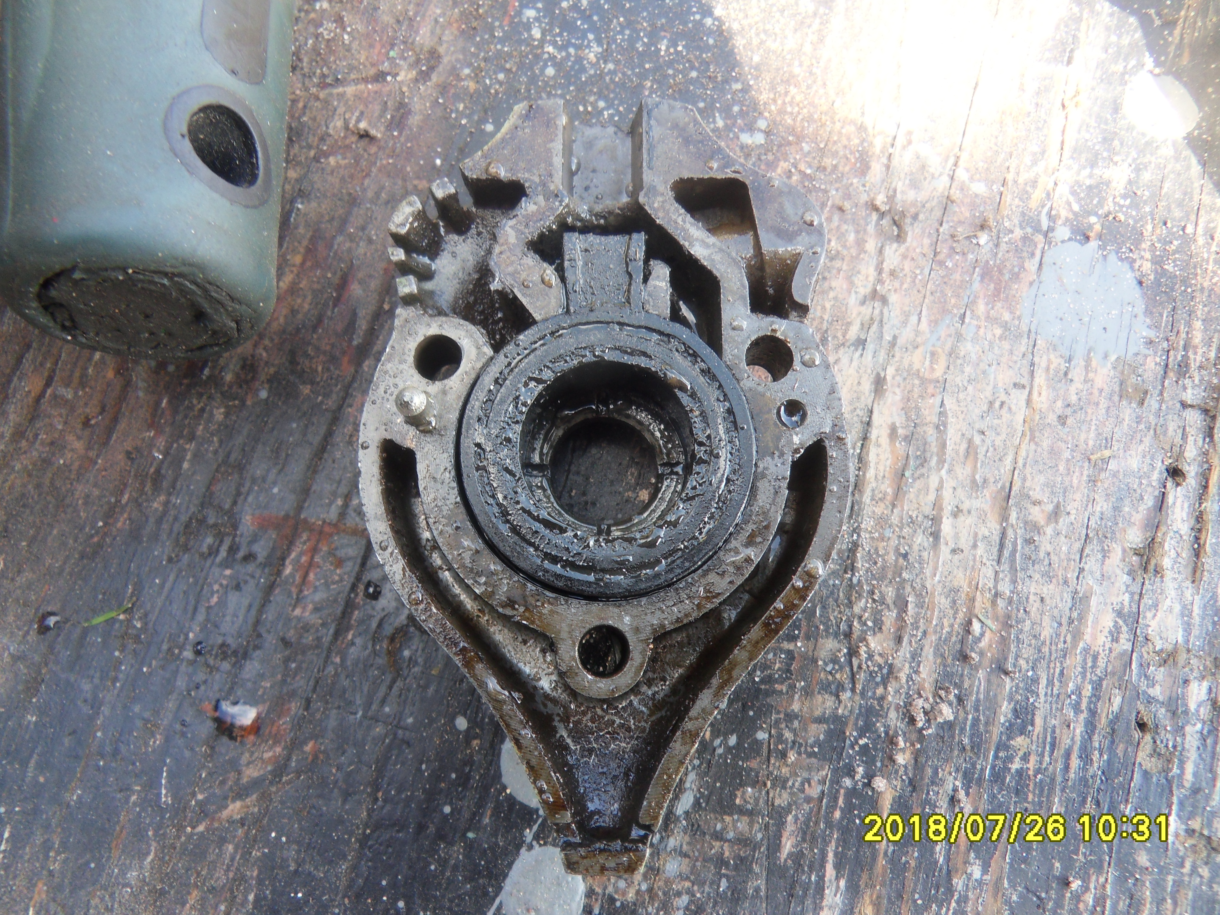

            #81386
            cajuncook1
              Your rotor in the picture is either wrong size/part or it has swollen over the years from grease and oil. Because it is so swollen, it does allow gaps to gulp enough water to cool your motor.

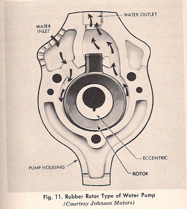

              #81388
              cajuncook1
                Look at the picture I have provided for you from a manual. You see the water flow pattern and see the rotor is smaller and not swollen. The "wobbler" or rotor is moved around and gulps water forward. Your rotor is too large/swollen to allow for proper water flow and volume.
                The original part number for the rotor was 300583
                #81389
                shane-r13
                  That’s my old rotor. I’ve since ordered a new one and yes it’s smaller and fits much better. Hasn’t helped.

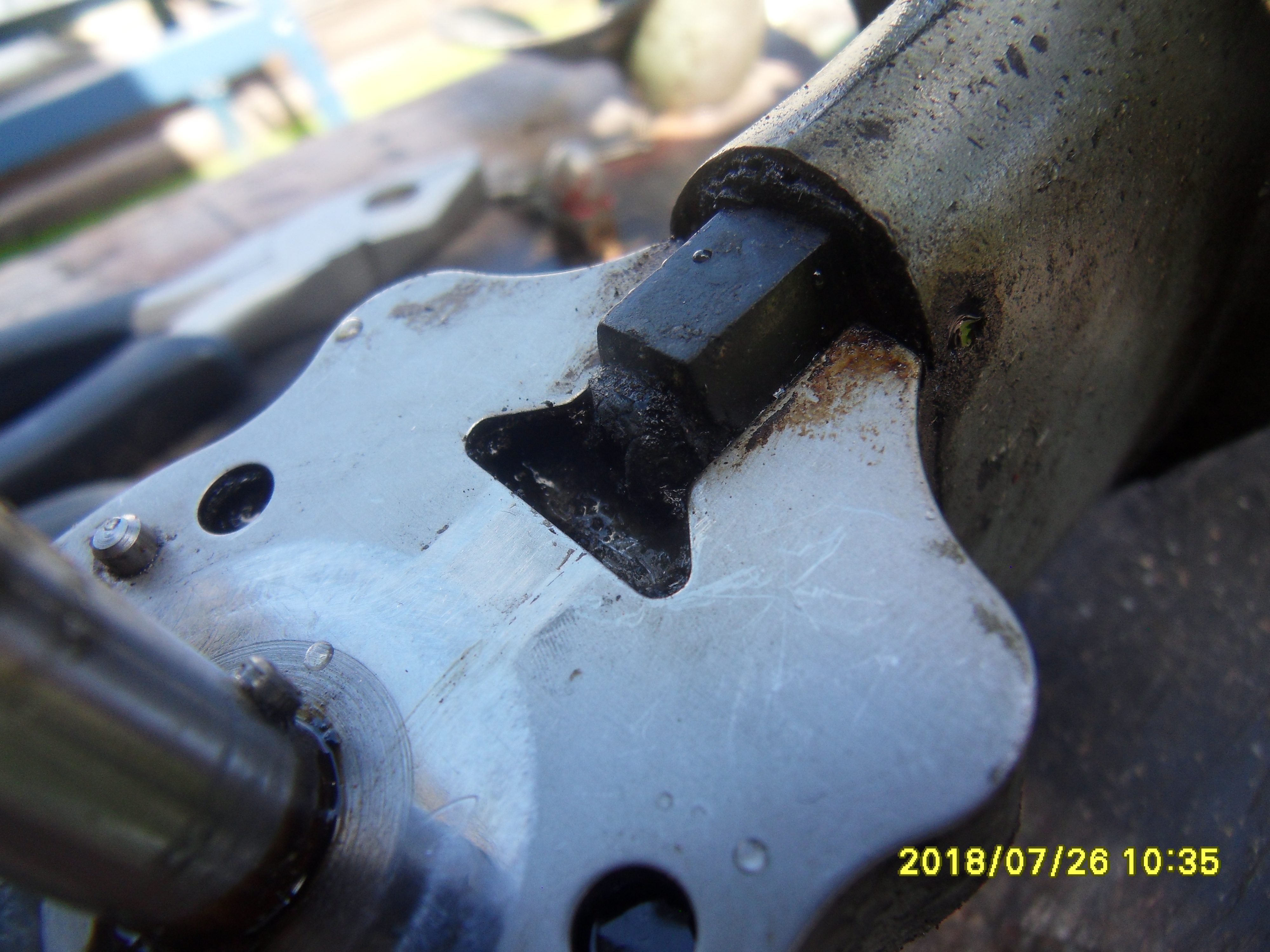

                    That wedge shaped grommet is what I was speaking of. I know you trimmed it at the bottom, but look up through it and make sure it has not swollen closed a bit. Every little bit helps. The tube may still go into it, but the hold may be swollen partially closed. Should be the same all the way through the bore of the hole.

                      #81392
                      shane-r13
                        quote gjonz:
                        Greg
                        Ok I’ll take a look up inside. I did run a wire up it and it went. How do you peer up it? The prop shaft seems to be in the way. Should I remove the foot from the mid section?
