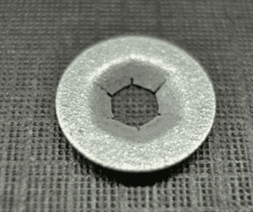

            found these which may also work as link retainers they are available locally in 0.125inch size πŸ™‚

                First… Ede thanks very much for the offer

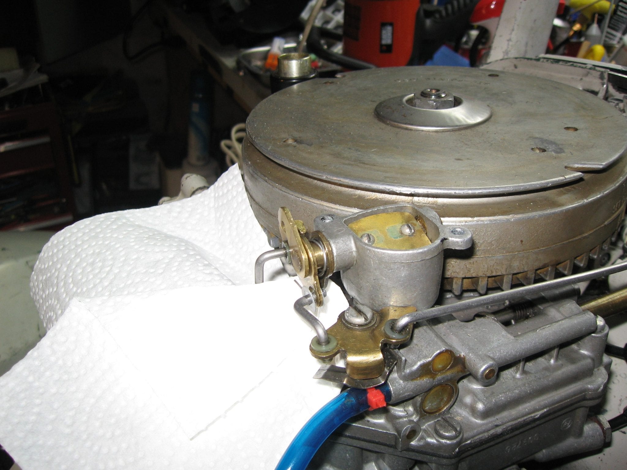

                Second: Success !! the little 1/8″ round clips in the above picture worked fantastic. I installed 2 to sandwich the carb link into it’s matching carb part ….see picture
                a close look shows 2 round clips on the link. What was great about it is that after removing the worn out 8$ plastic retainer there is a nice round groove in the link into which the push nuts locks solidly
                being galvanized spring steel they should last a long time $0.20 cents vs an $8.00 fix… plus shipping $$$

                  Looks like a great fix.Where did you buy them?
                  #191579
                    picked them up at Reno Depot ( A.K.A. Lowes across Canada probably) for 20 cents each I am certain they are available in any ” decent” hardware store
                    they come in various sizes the links on MQ carbs are exactly .125 ”
