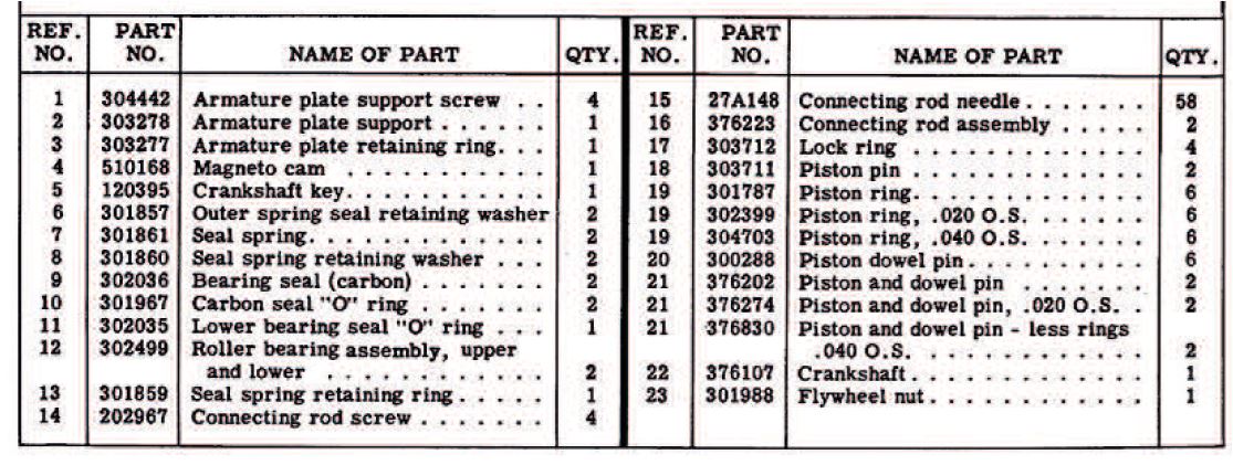

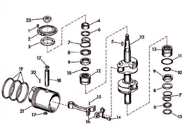

      what is 0302035 superceded to ? i ordered the o ring that goes over the bottom crankshaft bearing
      and marine engine sent me the wrong o ring the parts manual says 0302035 is for spacer to impeller housing o ring
      please look at the parts manual for crank shaft section ,item number7 . the 1957 parts manual is also wrong
      thanks for any help
      al

          My 10hp (1959) original parts book sez 302035 is the number for the o-ring around the lower bearing and also for the lower end of the spacer. If ME is sending you the wrong size o-ring, their parts stock may be mixed up, wrong part in right stock box.

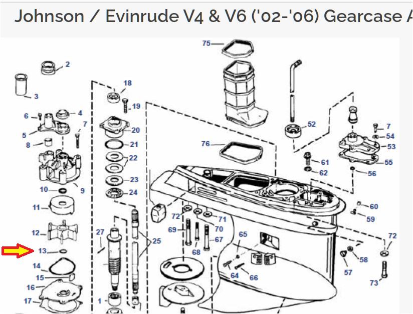

                Well, isn’t this interesting! 302035 is shown as the P/N for the ten horse lower bearing outer seal O ring and I can’t find anything in my Superceded Parts List saying it isn’t so it should be a good number. Searching that number brings up an O ring for the water pumps on newer motors. The OD of the ten horse crank bearing is 1 1/4″ while the sizes I find listed for the water pump 0302035 O ring are shown as 7/8 X 1 1/8 X 1/8. Is it possible the same part number is being used for the newer O ring as the original O ring with that part number hasn’t been used since 1963?
