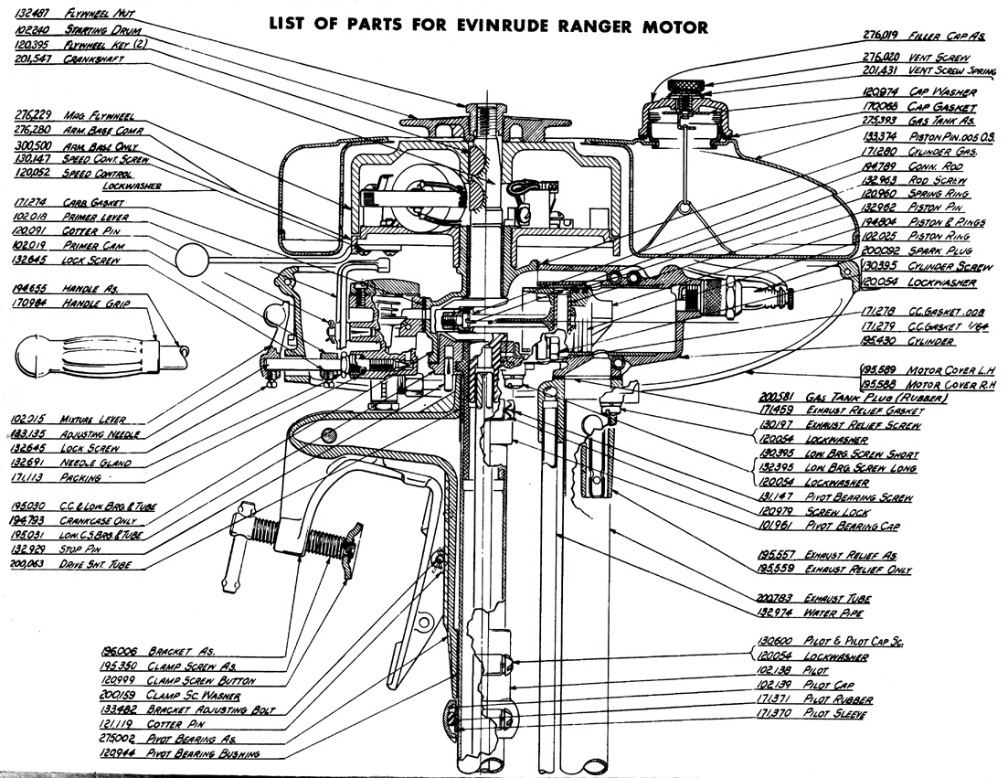

      My Pal will only run 1 second or two and the mixture needs to be near off . The motor has 60 PSI compression, the spark will jump a .090 GAP, I have checked the poppet valve for correct lift. I have also put the Pal carb on my Evinrude Sportsman and the motor will run good with the mixture on about # 3. What am I missing?

                  That would be a model 4203 …
                  This might be easier to see.
                  Last seen as the Evinrude Ranger of 1947
