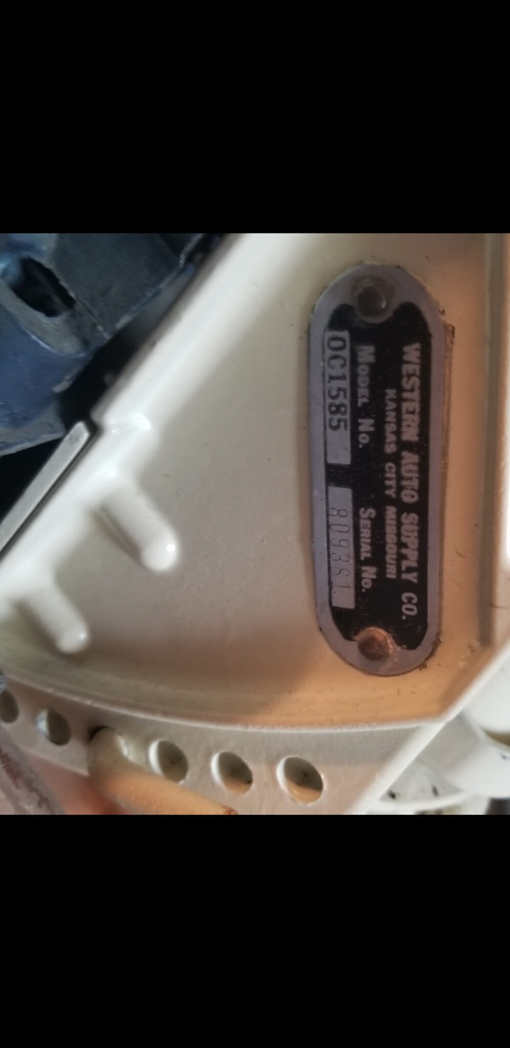

      What was the original oil mix for an oliver 15hp or the equivalent wizard 15hp? I have a wizard 15 that I’m getting ready to run but need to mix up some fresh gas first. My guess is no leaner than 24 to 1 but hopefully someone on here knows the original mix.

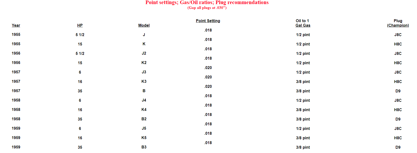

        Oliver-points-gas-oil-ratio-sparkplug-specs

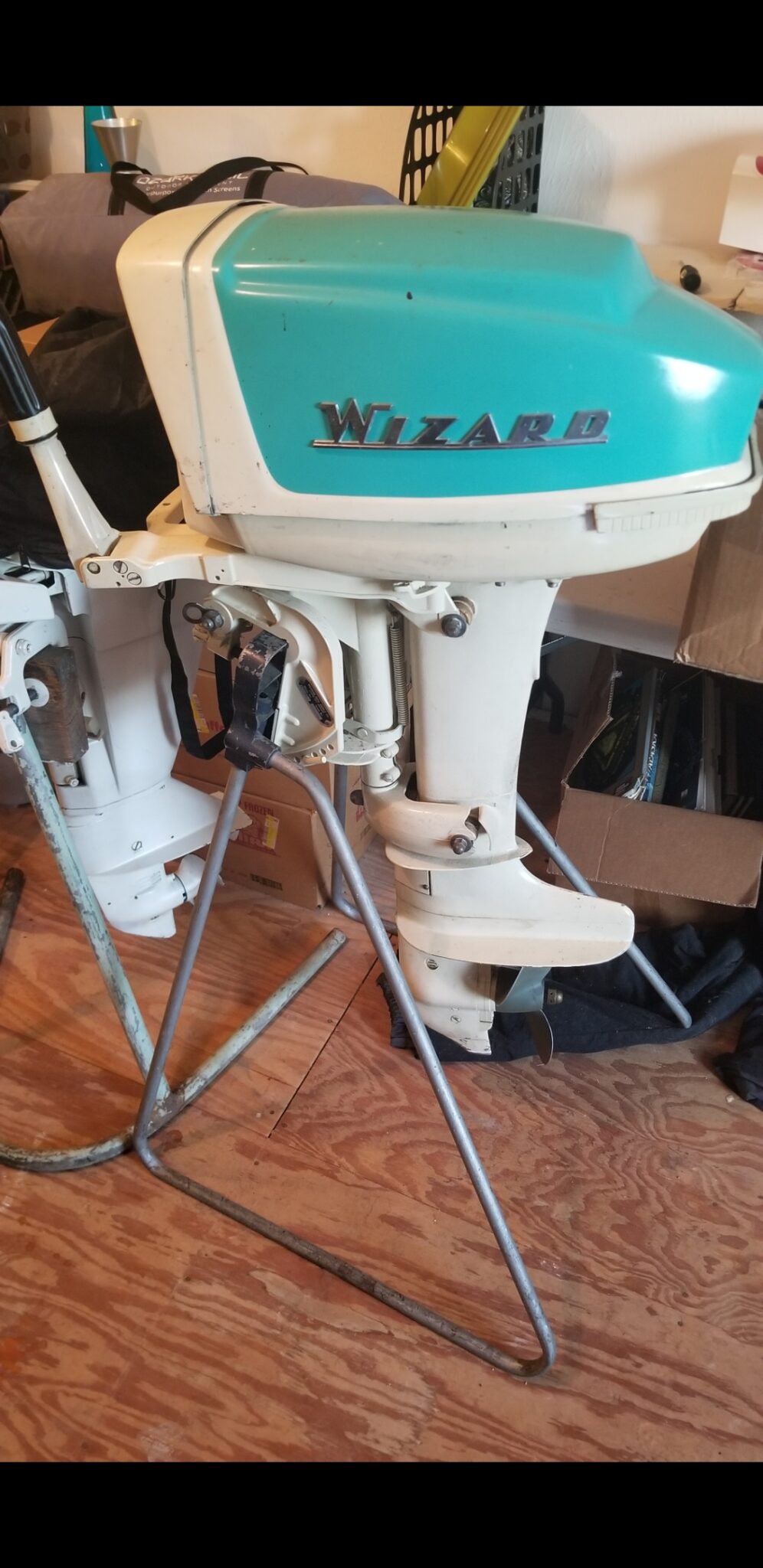

          I’m guessing half pint to a gallon is the original spec. Pretty sure the wizard I have is a 1958 model but as many outboard manufacturers did in that time, the discount brands were less refined and used older on brand model parts. Thanks Buccaneer
