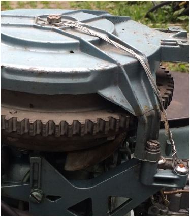

November 6, 2016 at 12:30 am #47043Yeah, looks like a ’63. Will need some things, including a new recoil starter, as that wiring job to hold down the broken mounting point won’t do the job.

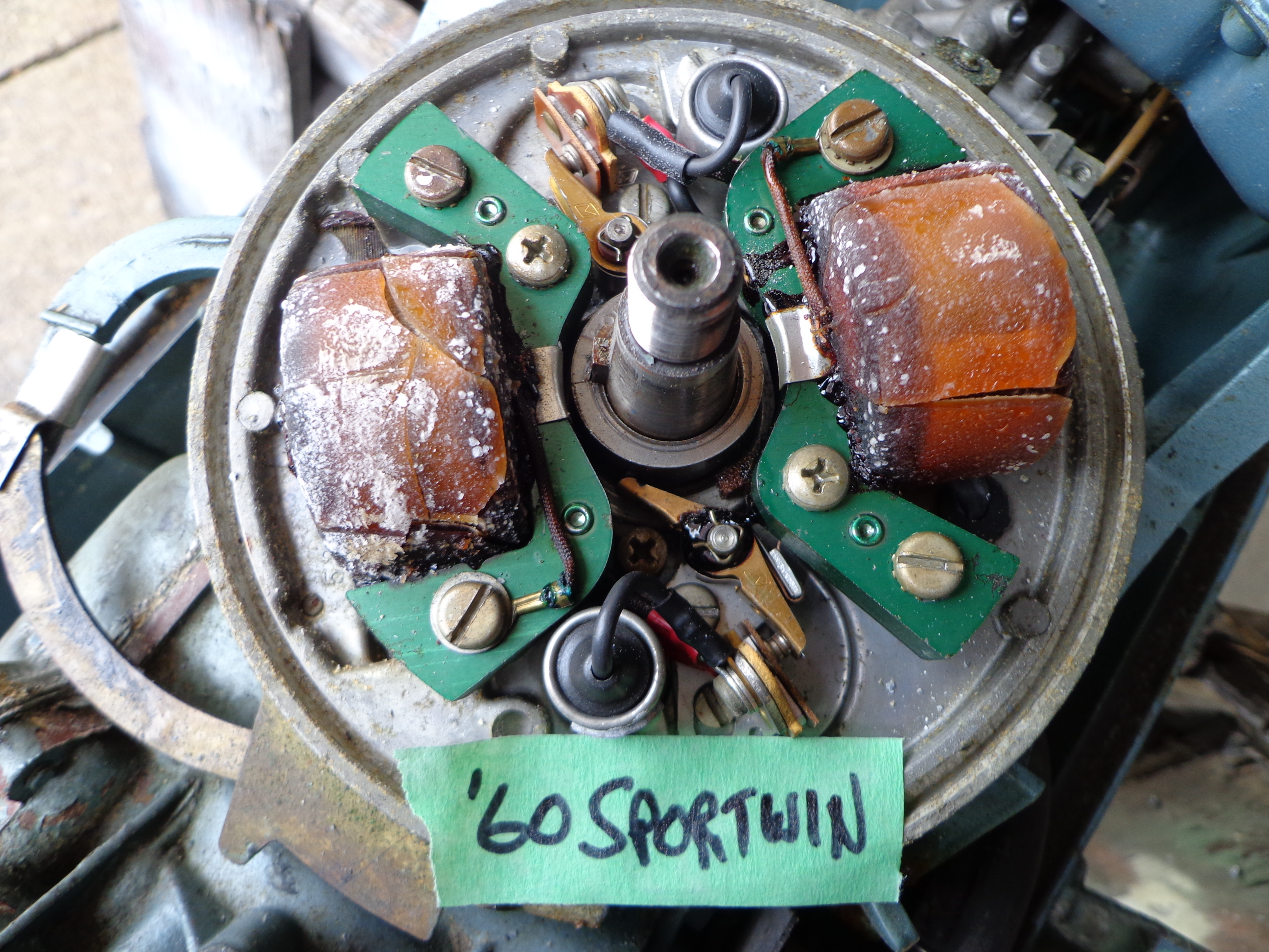

November 6, 2016 at 2:32 am #47049If it is running good might take a look at the coil’s from that access hole and make sure theyou are not cracked and ask when the impeller was replaced last as long as less than couple of years probably ok I would replace the recoil that is cracked and enjoy it they are great running motors have a 57 Johnson and 68 evinrude

turned off?November 6, 2016 at 3:47 am #47054quote paulfromYork:So the guy says it’s running great. Really? All that needs done?Not necessarily, but we all know what happens to the original coils. A motor might still run with cracked coils but it’s time is limited. Sometimes you get lucky on a motor and find new coils under the flywheel. The T-stats tend to be ignored.

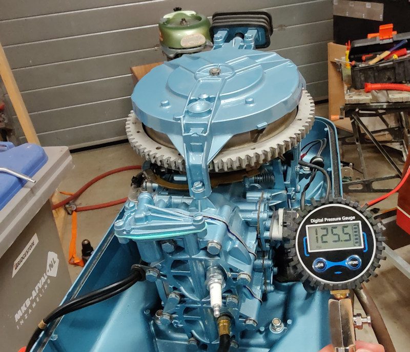

November 6, 2016 at 9:13 am #47063If possible, it would be nice to know compression numbers. I know this is pushing it for some eBay sellers who may not even know what compression means or come back with, "it’s perfect." The reason for asking compression, especially on the Fatwins and Fds, is that they will start, idle and run smooth as a watch with anemic compression. They just won’t have the speed they should. I have brought quite a lot of these guys back from the dead and have seen the difference. They are capable of 120, plus, psi compression but will seem to run great with 95.

Good catch on the recoil Lindy.
