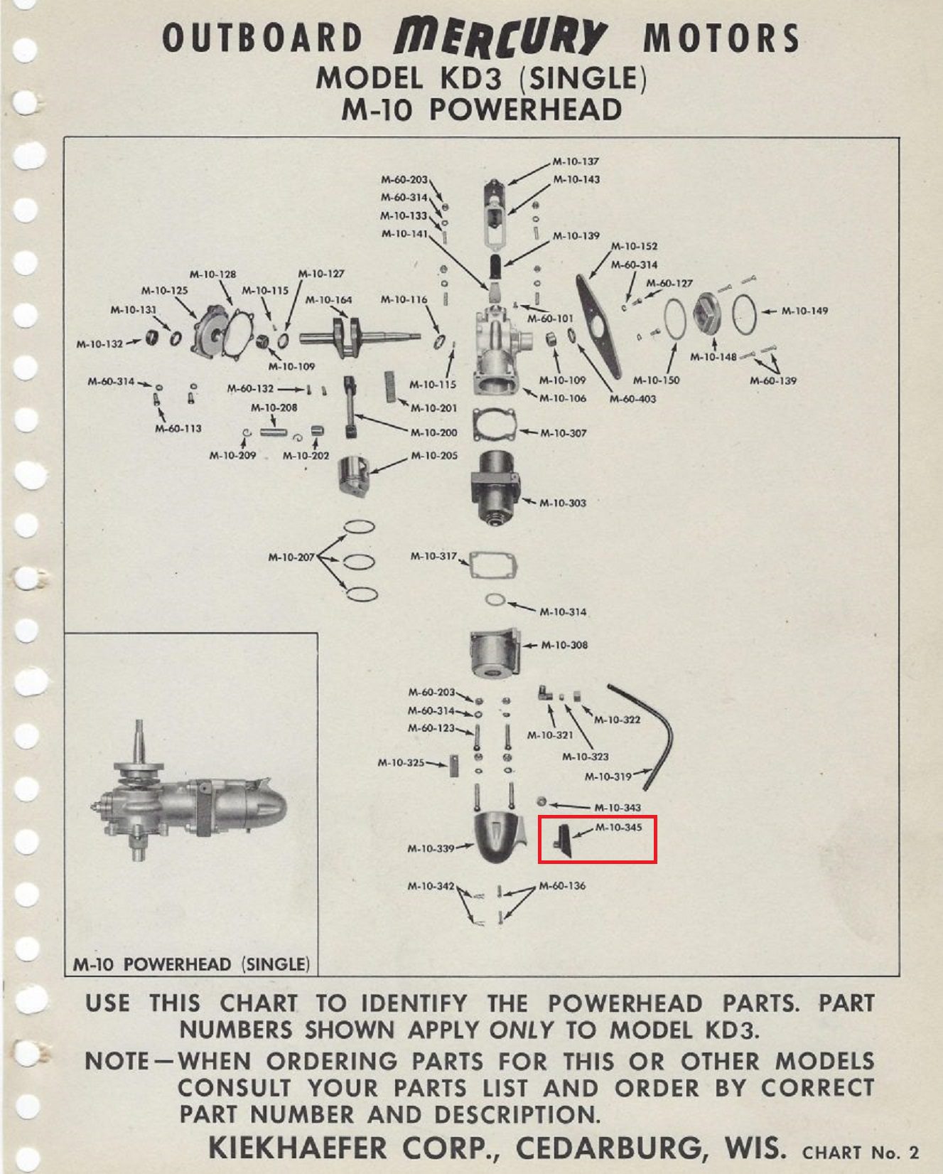

            Louis, is this the rubber wedge you refer to that goes between the gas tank and spark plug cover?
            The diagram is for a KD3 model, and I can’t find the corresponding parts ID sheet for it’s part number.
            KD3-Powerhead-rubber-block

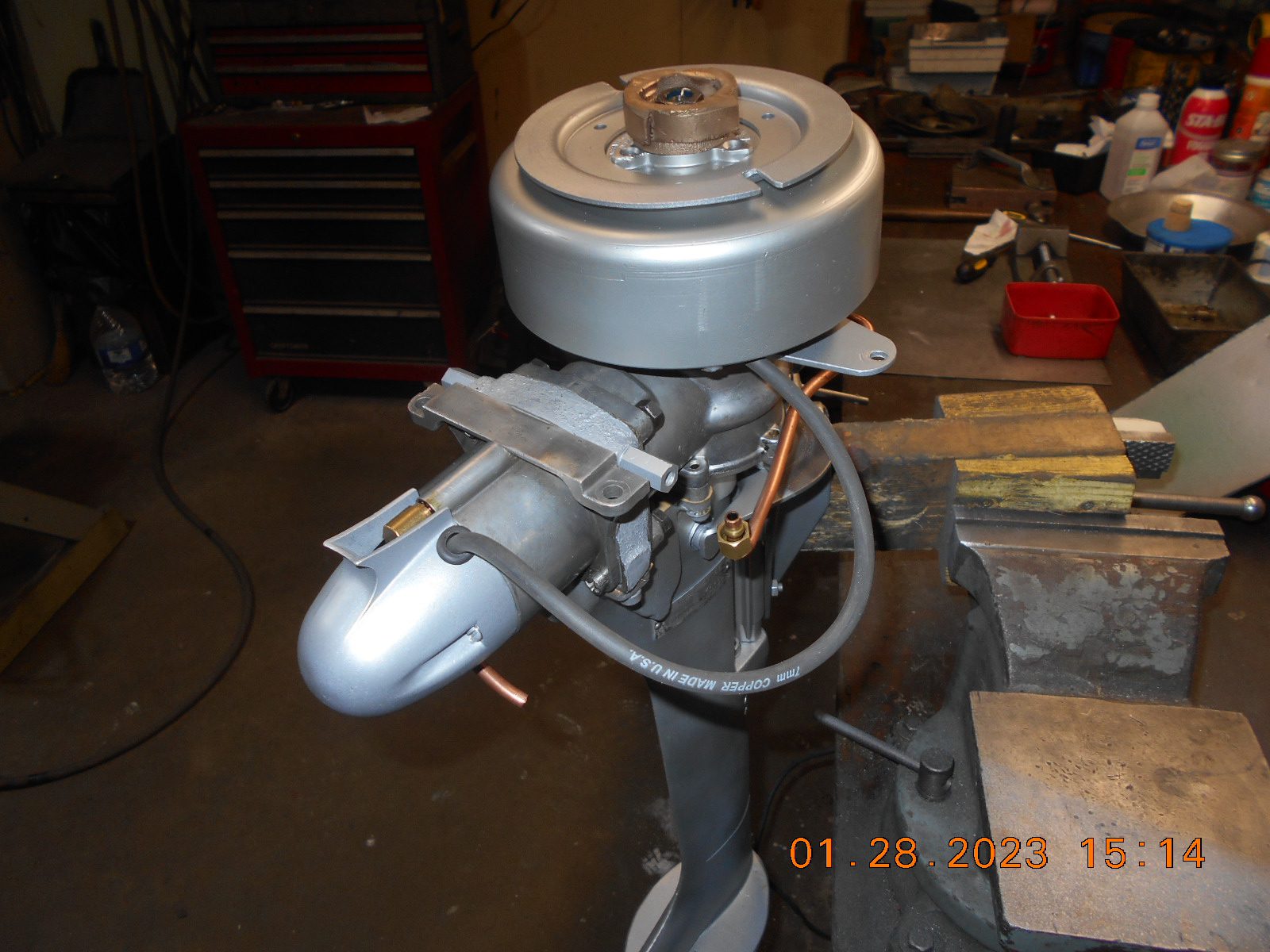

              Note the plumbing fitting have been removed from water jacket  Both spark plug covers are for the lower cylinder of a twin cylinder model. The spark plug cover for the upper cylinder of a twin and for single cylinder models is cut away to provide room tor the plumbing fitting. It may be possible to convert by careful work with a Dremel tool. Perhaps , s subject for a future project as Slipshod Engineering & Maching.

                Louis, a “Picture is worth 999 words”. Thanks, rubber block is
                now visualized!
