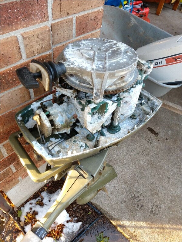

      Such a shame some knit whit sprayed over the original finish…

        #220222
          What did the inside of the powerhead look like if under the flywheel looked like that!
          #220237
          Evinrude 25
            I have never seen any thing like this. I have picked up some old outboard sitting out side the snow in winter time behind the barn for a couple years and I did not see this worst condition. This is the worst one!
            59
            • This reply was modified 5 years, 4 months ago by Evinrude 25.
            • This reply was modified 5 years, 3 months ago by Mumbles.
            #220255
              Right? I mean, holy smoke….

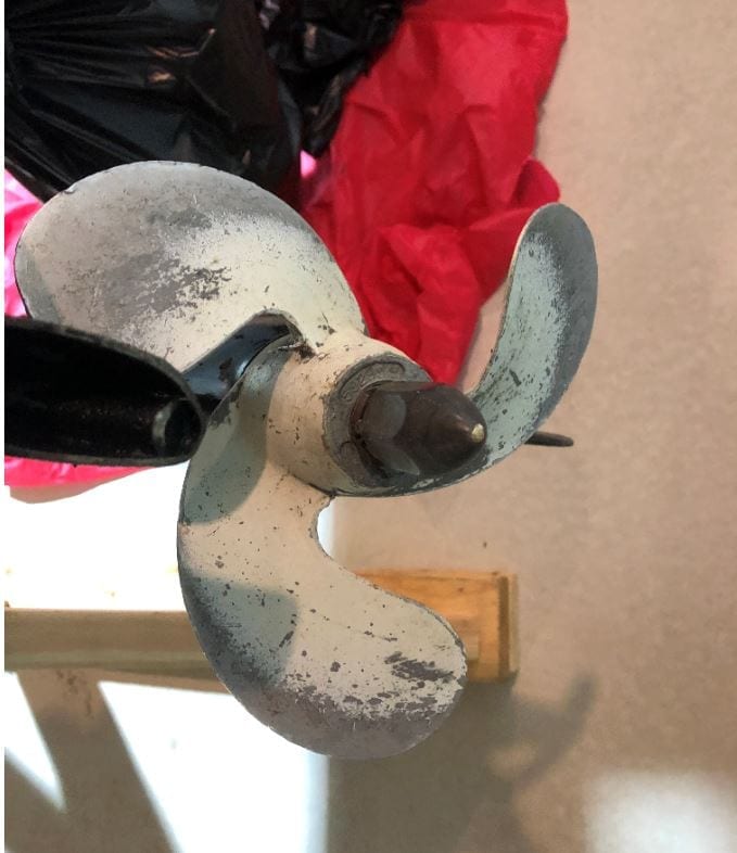

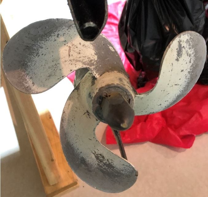

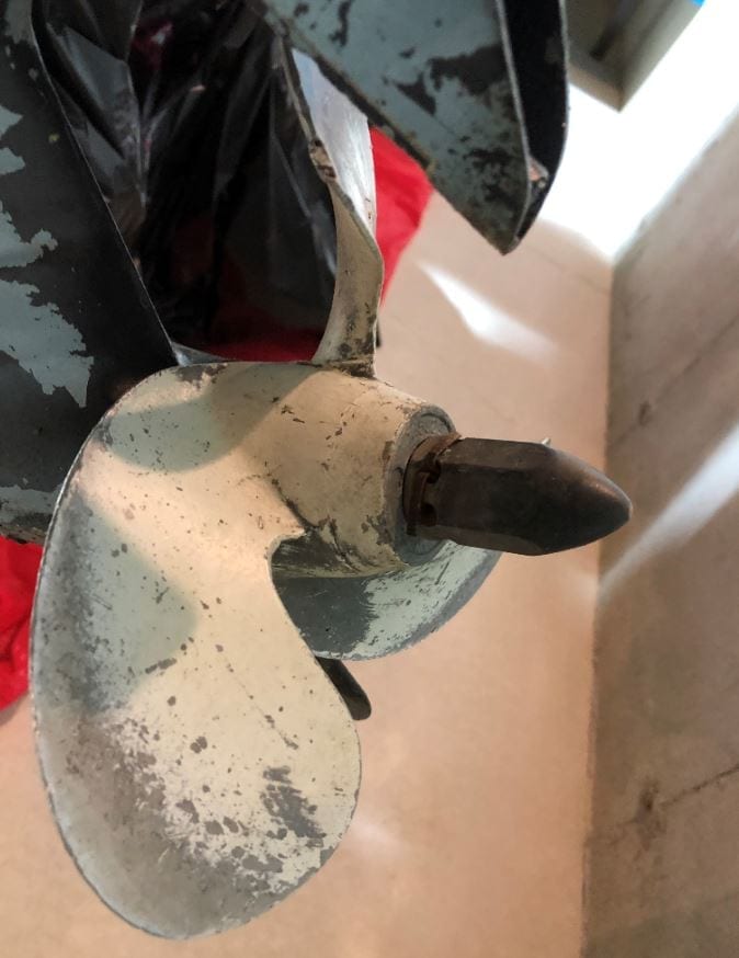

                Just got it picked up yesterday. It is 1961 model. It has a weak spark on both cylinders so the magneto ignition needs to look at. Compression test shows 92/91 psi on the dry cylinder. Hopefully the compression will raise when the cylinder got wet.

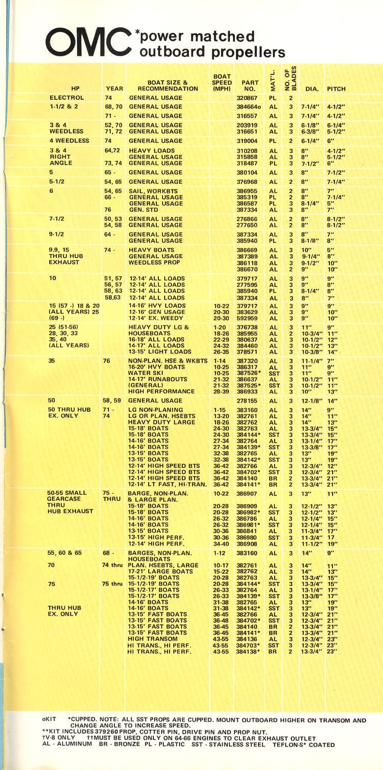

                Frankf, could you comment on the “18 hp semi-weedless prop looks just like a 10 hp, until you examine it closer.” I attached the pictures, Is the prop original for 18 hp?

                #220622
                  592959 (9 X 10 semi-weedless) was an optional prop.

                  #220636
                  outbdnut2
                    You probably know this. The propeller nut is not correct. It would have been a pointed, black plastic part with a metal threaded insert. The current available part is #0390716. Original, discontinued part was #0305469.
                    #220686
                    Evinrude 25
                      This propeller nut looks like home made from brass hex bar! should it serve the purpose to retain the propeller? The brand new cost $24 -$32 from E-bay.
                      Do you see any potential problem if I keep it instead using OEM part?
                      #220694
                        Looks funky, but will work if you don’t care about originality.
