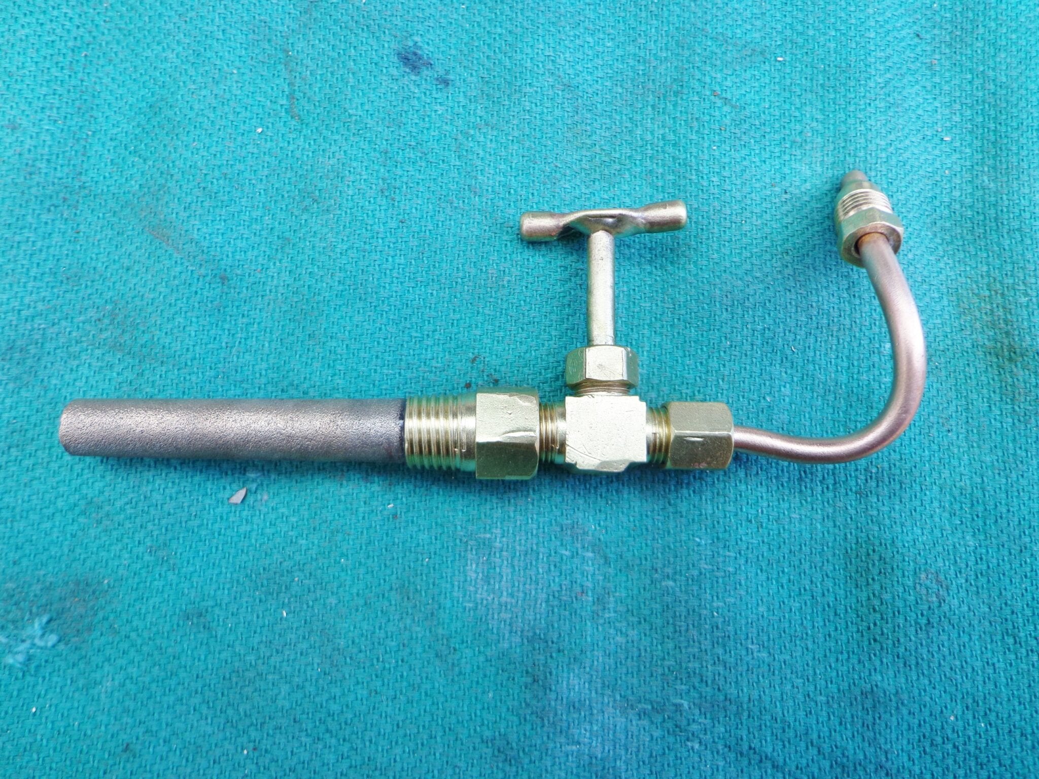

      Sounds like you might have a fuel flow problem from the tank. The filter in the tank and the small tube to the carb can get plugged or restricted quite easily. Have you tried running the motor with a full load of fuel in the tank?

        Yeah, Mumbles suggestion makes sense and should be looked into

          If I pull the hose from the carb and open the valve,it seems to have good flow. I eliminated the tank and line by running it with the tank and hose from my 2hp. Had same problem. Could a problem like this be somewhere behind the carb? Reed plate,worn bearings,etc…?
