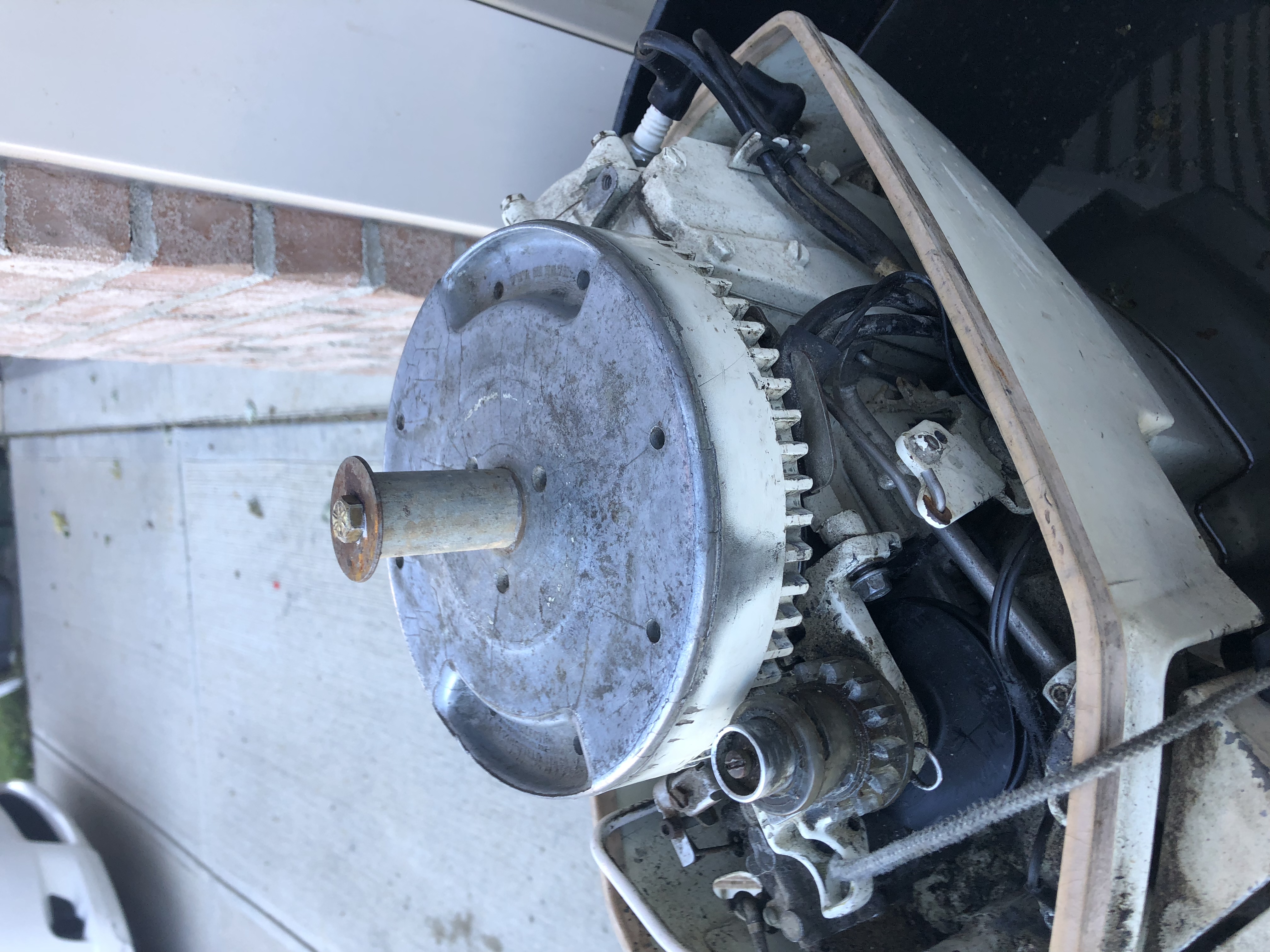

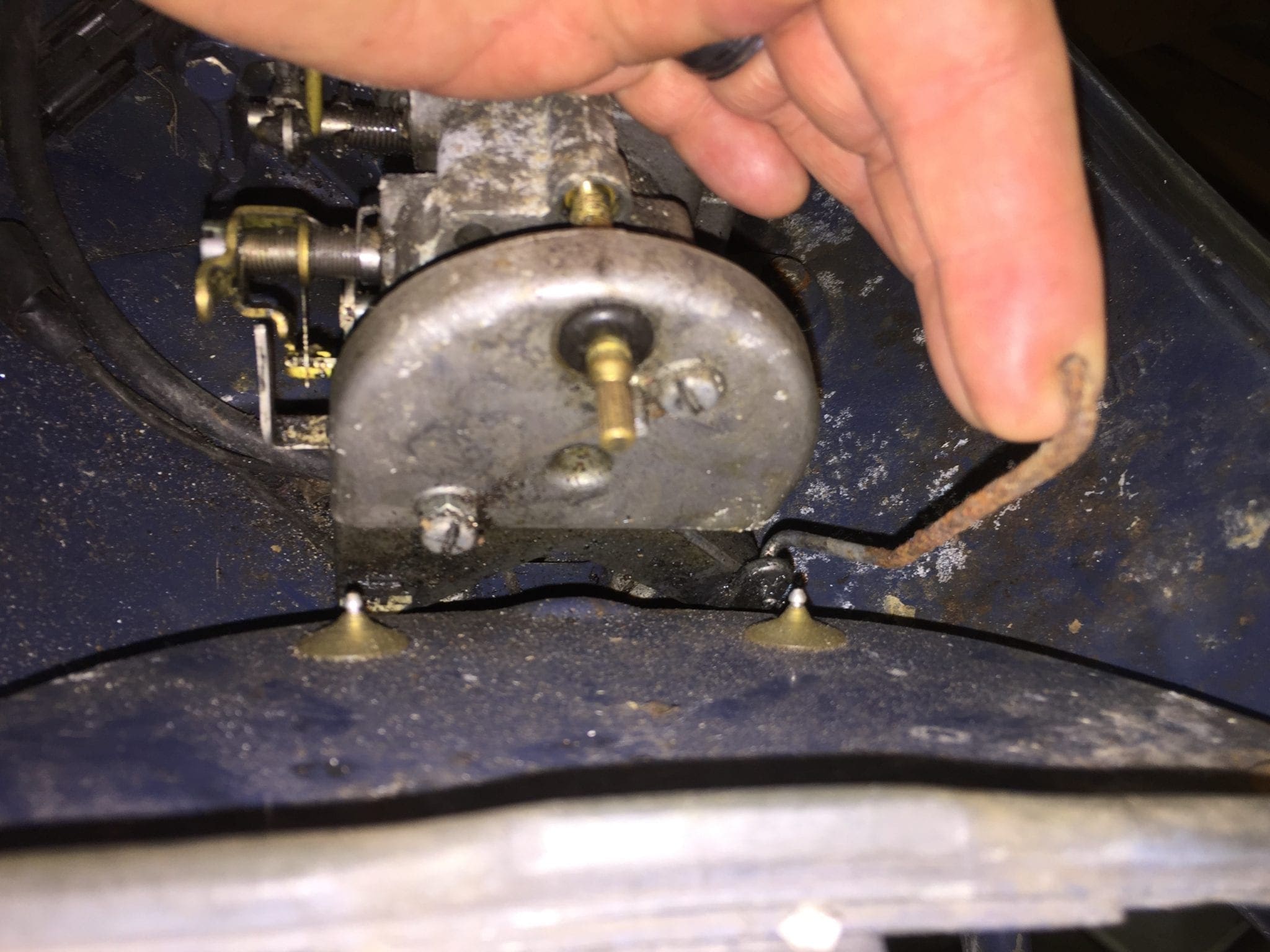

      So I picked up an 18hp horse Evinrude. 1969 model. Originally it was stuck. But now it’s turning over freely. Spark in both holes. Have not tried starting it yet. Something funky with the throttle. The fine adjustment knob and lever isn’t attached to the needle on the curb. Looks like an actuator are missing ?

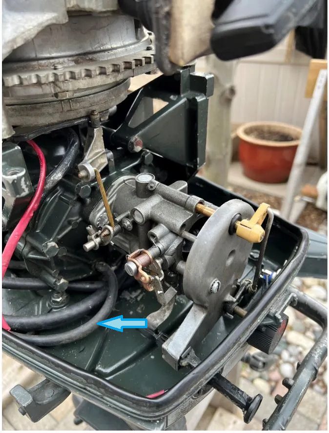

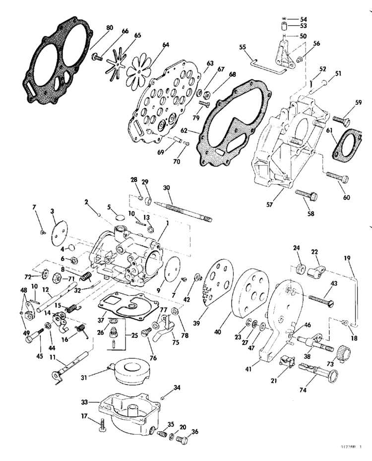

        Yes – The link snaps into the 0204705 Needle valve arm – item 22- – –
        18HP-Carb
        #173074
        shoestringmariner
          Ah, excellent, thank you!
