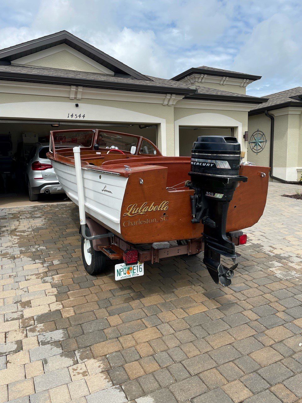

      I recently purchased a 1977 Mercury 500 for my 17ft. 1959 Lyman. The motor looks good but while installing it I noticed that there is no fuel line connector on the motor, only a 3/16 ID fuel hose hanging off the tee from the carbs. Can someone help me with understanding what are the correct connectors to be used on this motor? any guidance would be greatly appreciated.
      Gary
      Lyman-092021
