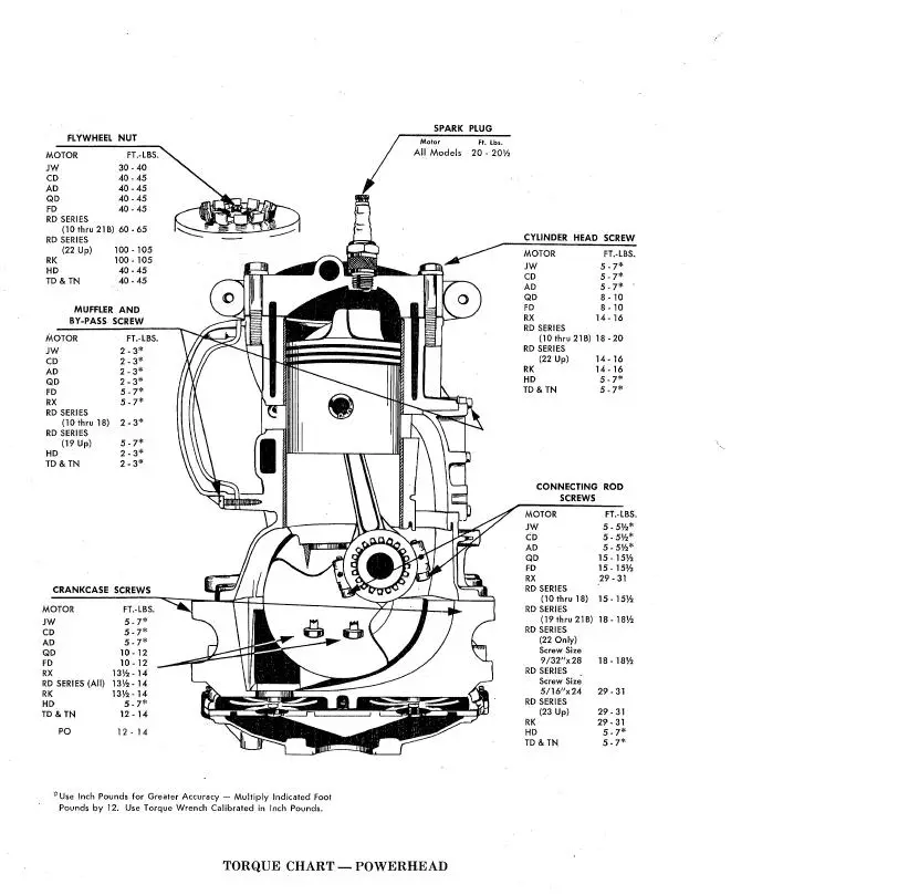

"Every time you remove a broken or seized bolt an angel gets his wings."March 29, 2026 at 10:04 pm #312874this was the torque specs for the oldies…should be ok for a modern …1982 engine
Bolt Depot – US Recommended Bolt Torque
March 29, 2026 at 11:13 pm #312890I have this same chart for the older OMC’s but don’t know what might be different for the motor I’m working on.
